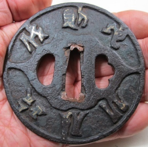

Here’s is an e-mail I received asking for identification :
I am a beginning tsuba collector.  Maybe I should not be, since I am 70 years old.  But only about a year ago I learned of what a tsuba was.  Never heard of them before.  Attached are the front or rear of my first tsuba.  (The other side is blank.)  I think it to be real from the patina and dirt on it.
But after cruising the internet for over a year, I have never seen another like it.  I have used some on-line charts, and think it might be a kamakura-bori type.  Could you help me to identify it, if you have time.«
I agree on the school, Opinions please

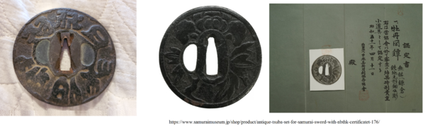

Not a million miles away from this one on the right - but undecorated ura gives me some concern? Are the hitsu filled with lead or are they just a pattern in the metal? Reminds me of some paperweights, this one recycled by the addition of sekigane? Wish we could see the ura side.

Great Glen - I am not a big fan of the designs they look so rough [cast?]

Hello Jean (and to the writer of the Email),
I saw a similar one on Ebay today.  To my inexperienced eyes, this tsuba looks cast.  But hey, that is not a bad thing!  The tsuba has been mounted (I can tell that by the sekigane in the nakago ana).  It was also "customized" because as far as I can tell the hitsu-ana have been filled with copper (at least that is what I think the metal is!).  Still, I consider it a nice piece.  I would not mind having one for my collection!  I am probably wrong in my analysis of this tsuba.  If I am, other members will definetly let me know!  Hey, it is just by best guess about the tsuba!
