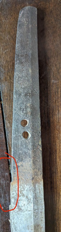

I am trying to identify a sword that is in my possession.  This sword was a battle field pick up in WW2. I can find no visible markings. I think it is a family sword that was refitted for the war but I am no expert.

Welcome to NMB.  Your sword is indeed a Japanese sword and from the images so far is an older blade as opposed to one made during the War.   Older blades were used for a variety of reasons and, while it is tempting to believe that it is a family blade often they were contingency blades gathered for the war effort.
You can clearly see that it is machi okuri, the steps on the nakago where the habaki fits have been moved up.  This has been done without shortening the tip of the nakago so what you have is a mumei or un signed sword.. In that condition it is not going to be possible to tell you much more but a shot of the whole blade with the habaki removed might allow a suggestion as to it's age.

In the state your sword is in, it is just too difficult to tell you anything with any certainty. No arsenal stamps, no name inscribed, two peg holes, nice curvature, about 27 inches to the cutting edge, but otherwise a distressed sword that doesn't tell us much. The lack of arsenal marks and the curvature suggest it is an older blade, maybe ~500 years old. However, age doesn't necessarily equate to value or collectability.
What’s up with the Habaki and the Hamachi and Munemachi ?
Does the Habaki only slide to the first notch ?
Can you make a picture of the Hamachi looking from the edge and maybe the same from the Mune.
So that we can see how thick the blade is there.
