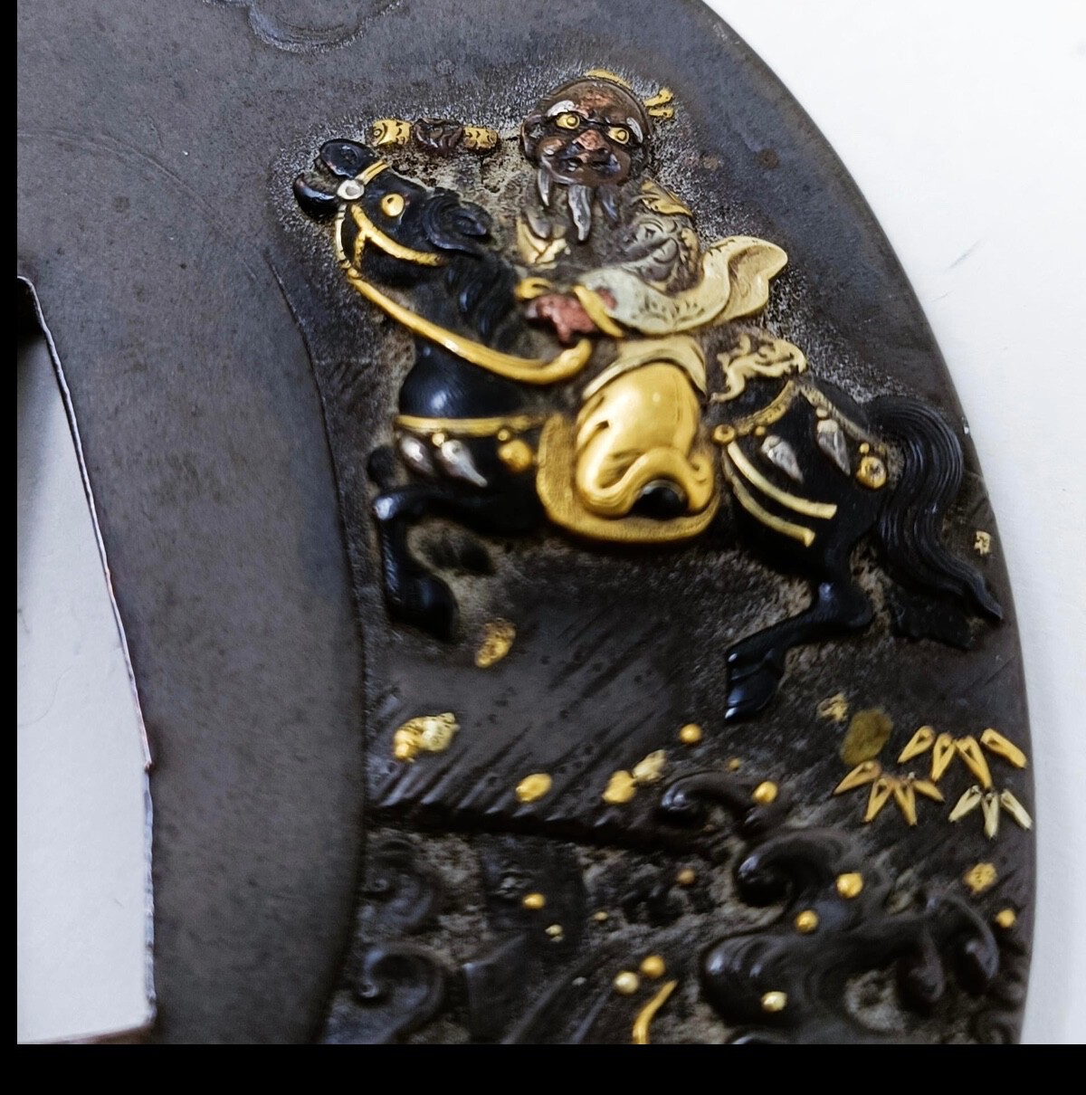

Couldnt resist this one in a rural auction. “Kosetsuken Tomonao” . Mid 19th C   I’m Still waiting for the postman to deliver but meantime…..
Please can anyone tell me the legend depicted? We have an attendant (of Ryujin?) emerging from waves on the back of a dragon offering a tama (one of the “tide jewels”?) to a mounted (hero?) who appears to be on a raft or pontoon. I simply can’t find it but it must be fairly well known to use it as a subject and put so much quality effort into it….imo

Congratulations.  I went to see this tsuba as the auction house was nearby.  Like you I thought it was shakudo from the auction house photos (as you have copied and posted), but in fact the base metal was brown when seen in real life, i.e. shibuichi. The auction house said it was bronze. So my bid was much lower. The tsuba depicts the story of Choryo (Zhang Liang) a Korean(?) hunted by the Chinese Han government with Kosekiko (Huang Shigong, lit ‘old man yellow rock’) at the Yishuidi bridge.  The old man, Kosekiko, began teaching Choryo the art of war and to test him deliberately dropped one of his shoes in the river and ordered Choryo to retrieve it for him.  The shoe was grabbed by a water dragon, but despite the insulting order, Choryo retrieved the shoe, and placed the shoe back on Kosekiko’s foot.  The old man (Kosekiko) then arranged to meet Choryo on three occasions at the bridge; the first two occasions Choryo was late and was scolded, but on the third time he waited all night for the old man.  The old man then gave Choryo a book about military strategy (Taigon Art of War) telling him to return in 13 years time when the old man would appear as a yellow rock.  Choryo did return, found the rock and built a shrine to Kosekiko.

The surface of the plate is essentially migaki-ji (polished), whereas the bridge, dragon and rock have been given an ishimi-ji (stone) finish. The design is cut in shishiai-bori (motif flush with the surface) mainly using a katakiri chisel (sloping on one side to look like brush strokes).  The design is picked out in gold and silver hira-,or hon-, zogan (inlay flush with surface) and is sometimes called Kaga-zogan as it was commonly used by Kaga craftsmen, including this artist.
The tsuba is signed using a fine chisel (kebori) Kuwamura Gen’emon Katsuhisa (桑村 **克久), with a kao.  Sesko (p 326) lists a Genzaemon Katsuhisa (same kanji) of the Kuwamura School in Kaga, born Genroku 7 (1694) who had the go ‘Jokyu’ and this would seem to be the maker of this tsuba.  He was still working in Horeki 8 (1758) and there is a work signed Kuwamura Jokyu at the age of 65 (1758).  Katsuhisa and his brother, Yoshihiro, were the sons of Matashiro (later Cho’emon) Morikatsu, who studied under Goto Kakujo and used the go ‘Sojun’ and was employed by the Maeda family.

Just to round off the thread…..it’s just arrived and one of those that turns out far better than the images. Just a quick pic to show the height of the inlay and maybe a better idea of the plate colour…..as John says….shibuichi. Thanks to all for helping. All the best. Colin
