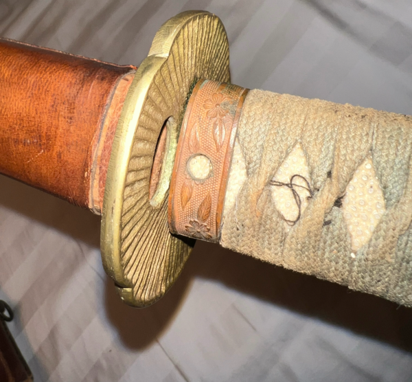

Conway S Posted March 8, 2023 Author Report Posted March 8, 2023 The little white insert is actually metal. 1 Quote
Conway S Posted March 8, 2023 Author Report Posted March 8, 2023 The collar is also intended for a sword that had the blade release mechanism. Not sure if it was common to piece swords together, but I assume that is not a good sign. 1 Quote

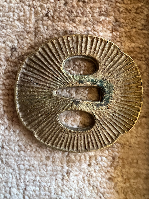

Kiipu Posted March 8, 2023 Report Posted March 8, 2023 Thanks Conway for the crossguard/sword guard pictures. I figured I had seen that tsuba somewhere else and sure enough see the link below. Jonathan AKA @AlphaRaider has a sword that has a similar crossguard. Jonathan's sword has a single kanji character on the tang, so can you check your tang for any such characters. WW2 Japanese sword Marking, Page 2 1 Quote
John C Posted March 8, 2023 Report Posted March 8, 2023 2 hours ago, Kiipu said: a similar crossguard. Thomas: So what is your working theory? Are you getting a sense of what these might actually be? Chinese fakes; Island manufacture; "rare Air crewman's tsuba"? John C. Quote

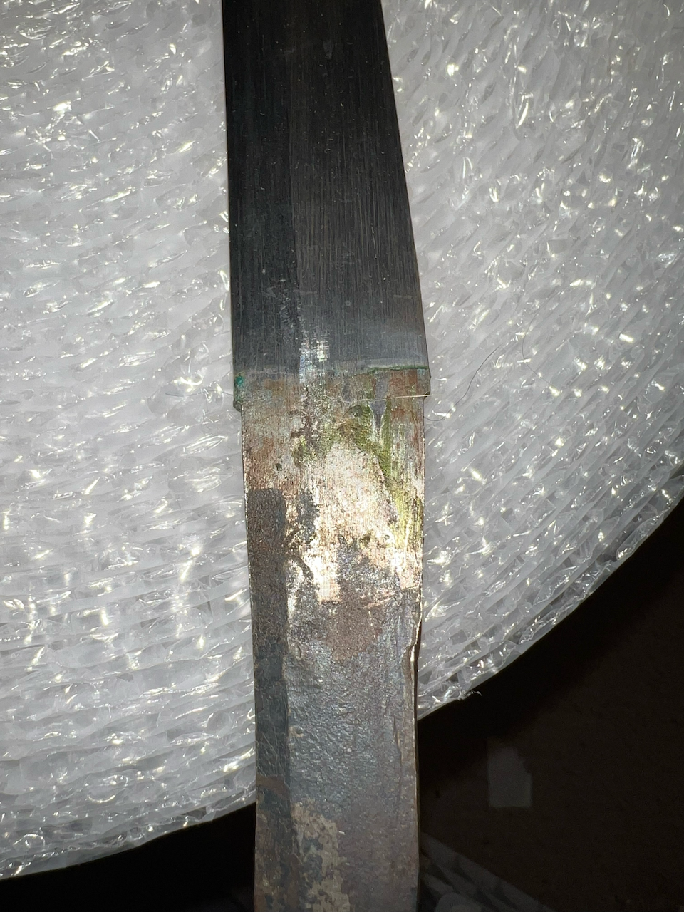

Conway S Posted March 9, 2023 Author Report Posted March 9, 2023 With great difficulty, I was able to remove the habaki. No markings found. Does the picture provide any further indication of what this sword might be (Chinese fake or some other non-Japanese made period sword)? There was a blue/green gunk under the habaki. 1 Quote

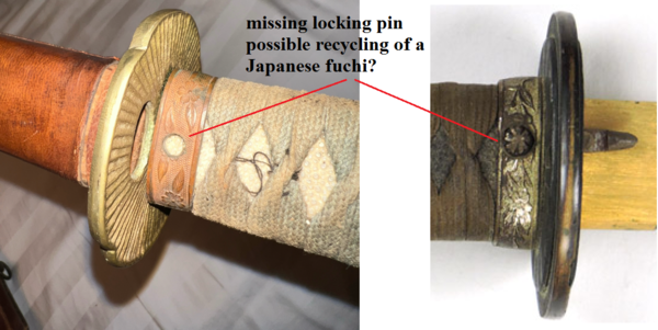

Bruce Pennington Posted March 9, 2023 Report Posted March 9, 2023 Same tsuba and kabutogane designs! Also, the fuchi on both are legit Japanese design. To add some credibility, this machi on this blade are aligned straight across, whereas many Chinese fakes have offset machi. Hmmm... 1 Quote
AlphaRaider Posted March 9, 2023 Report Posted March 9, 2023 Thanks for posting and welcome to the group. haha not like I'm not new myself. Neat sword you have, thanks for sharing it. I have included a picture of my Tsuba which is quite similar to yours. I have noticed about 4 other swords with a similar guard. not sure of the official name or style. My sword tang has a style close to yours in terms of shape and the angles and flats like yours. Hopefully you enjoy it. Sword aside I've noticed these couple things... - The handle wrap is incorrect looking / / / / one direction in the wrapping. - The Tsuba does look similar to mine however it looks much newer. It seems fresh if that makes sense, maybe not exposed to elements? - The ray skim looks nice and white. - The leather combat wrap looks to be in nice condition. Here is mine and his Tsuba: -J. Hoff 1 Quote
Kiipu Posted March 9, 2023 Report Posted March 9, 2023 12 hours ago, AlphaRaider said: I have included a picture of my tsuba which is quite similar to yours. Not sure of the official name or style. A good question and I do not have an answer to it. However, @Spartancrest might be able to provide an answer as to the name of the tsuba design/style. 1 Quote
Spartancrest Posted March 10, 2023 Report Posted March 10, 2023 4 hours ago, Kiipu said: However, @Spartancrest might be able to provide an answer The "style" is Chinese fake - sorry. The design is a form of Amida - Yasuri the halo of the Buddha, the outline is Mokko-gata [four lobed]. 1 2 Quote

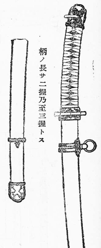

Bruce Pennington Posted March 11, 2023 Report Posted March 11, 2023 21 hours ago, Kiipu said: The lower ranks were allowed to use personal swords until 1939 and many of these swords were purchased in China. Take a look at the second picture down from the top, two NCOs with private swords can be seen. This is the dilemma that we face in trying to identify these swords in this thread and others. 私物軍刀 Thomas, Could the design depicted in this photo from your link possibly be what we are seeing on these kabutogane? Quote
Kiipu Posted March 11, 2023 Report Posted March 11, 2023 The drawing depicts what collectors call a Type 98 Military Sword 昭和十三年制定軍刀 and is coming from the 1938 announcement of the new uniform. At this time, the Type 94 lost the second removable hanger and now the same sword was called a Type 98. Quote
