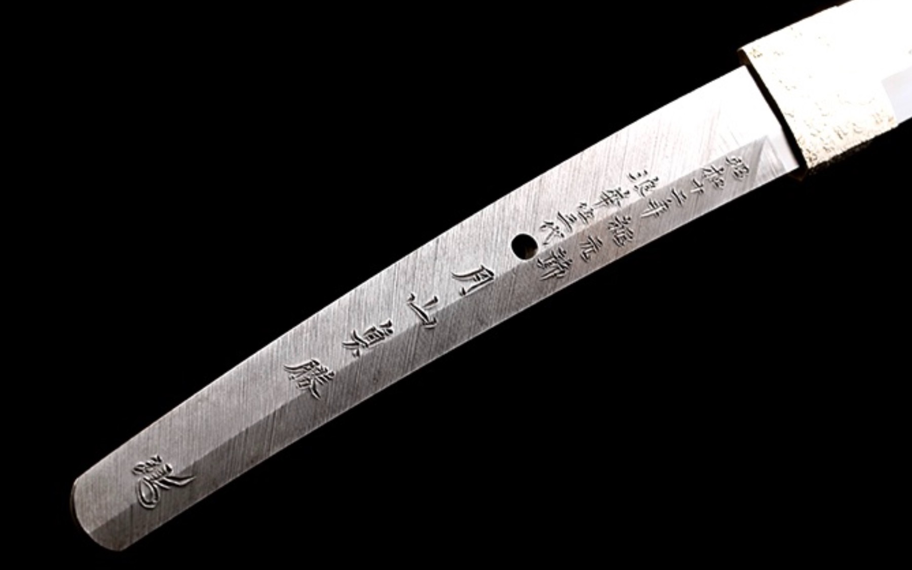

15 hours ago, Bryce said:
Small correction to Nobody's translation. Looks like Showa 12 so 1937 not 36.
Cheers,
Bryce

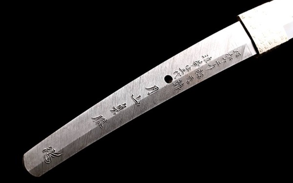

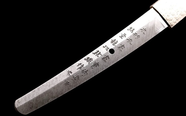

Also, not to detract from Noah's discussion (and Brian can move this to the Gassan thread, if appropriate) but I was comparing Noah's blade to another found by @Stephen for my kakihan files and the inscriptions on both sides are the same, even the date of February 11 1937, yet they are clearly different blades!  The other one is posted HERE and is fully polished, shiny habaki, posted back in 2016!
I seriously doubt Sadakatsu could make 2 blades on the same day (Ok, I know it took many days to make a blade).  Why would they both be named the same name for the same family with the same date?  Is it possible the family commissioning these blades wanted 2 (or more) for gifts?

I don't see why the family wouldn't have had more than one commissioned at the same time. Maybe gifts for people, or 2 family members. They could have been made concurrently. I think a faker would have changed the mei.
Worth researching. For me, it would be a definite shinsa candidate, and a full restoration if ok.
For all the discussion of gimei based on a stroke here or there, two really great photos of both these mei side by side would be enlightening.  Both signed by the same hand on same day… identical?  Just for discussion sake…
