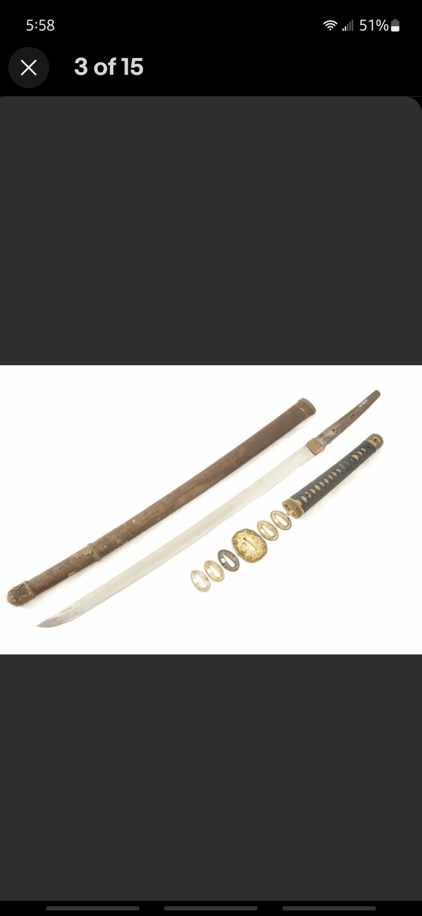

Hi everyone, i just bought a sword on eBay that the seller says is signed by Hizen No Kuni Tadayoshi.  It's a type 98 WW2 sword. The signature on the tang looks a little sloppy to me but im no expert and either is the seller. Can anyone lead me to the right conclusion?

NewB, right i think i need to seek a professional once it arrives. I posted the measurements that the seller listed, i wish he had better pictures of the blade. I will have to wait until i actually recieve the sword lol

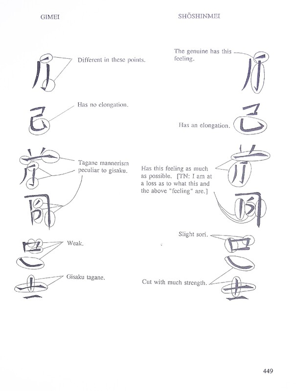

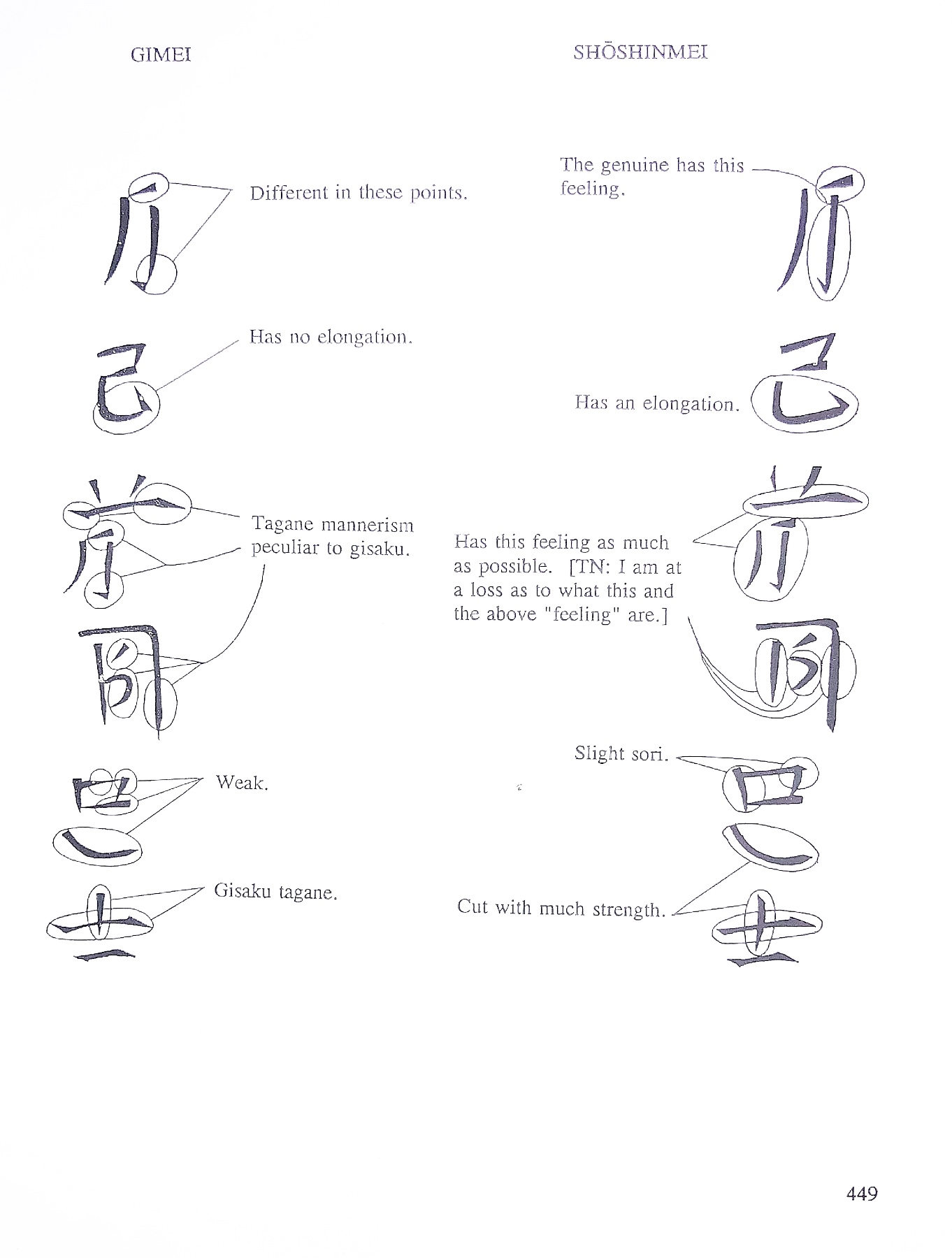

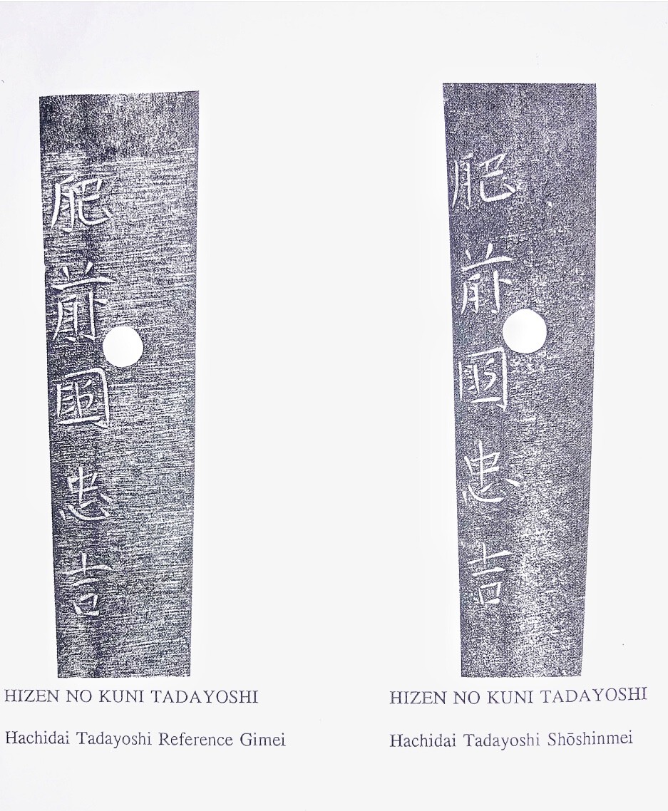

Hi Joe,
As it was years ago, I'm not sure where I copied the following two illustrations from (and so apologies to anyone if it is from their own publication). However, I thought it may shed some light on the signature style.
I should add that I myself, have zero knowledge of the intricacies of this school.

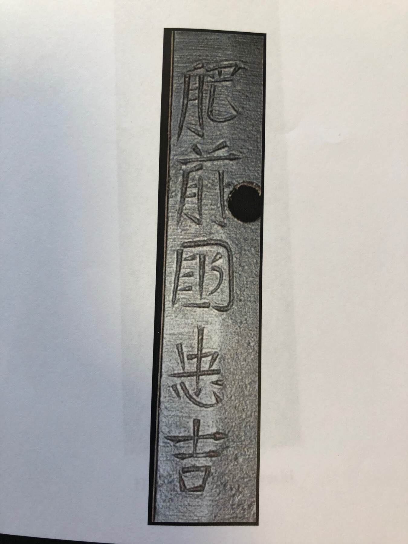

PS: this is a definitely genuine example which was appraised by Honami Koson in 1940 and appeared on the website www.hizento.net 19 years ago.
(Also note the position of the menuki-ana to the right of the second kanji.)
