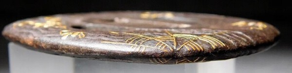

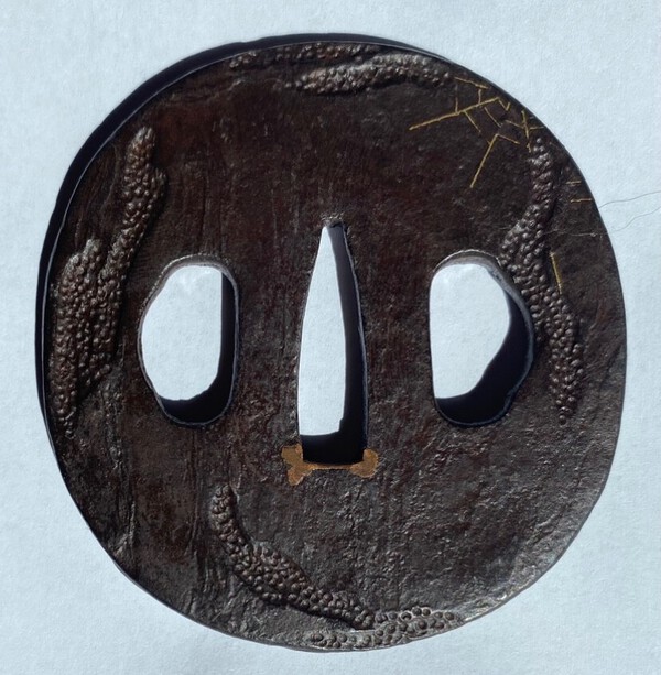

Popular Post Matsunoki Posted February 19, 2023 Popular Post Report Posted February 19, 2023 Hello again from the UK, yes it’s me again with another recent acquisition asking for your help and guidance. I bought this one recently (same auction as the crab tsuba) simply because I like the subject and I thought it looked well made. I have some memory that a spiders web on a tree was something to do with someone hiding in a tree during the Gempei wars. I must do some rooting around. Meantime can I please prevail upon you and ask for your help on possible school, age etc? I’ve not had much luck on the internet. The hornet or wasp is nicely inlaid in shakudo and gilt. H8.7cm W8.0cm T4mm 14 1 1 Quote
Grevedk Posted February 19, 2023 Report Posted February 19, 2023 Good afternoon Colin, In the hope that I can supplement your own memory - then the statement below is from the tsuba collection in the “Metropolitan Museum of Art”. Design is slightly different, but motive (without insect any 🕷️ 🦟), as well as the story could be related to your recent acquisition. Text: “The entire plate of the tsuba is carved to resemble a dead tree, with a spider web and threads inlaid in gold nunome-zōgan. A spiderweb on a dead tree combined with an openwork design (as here represented by the small ko-sukashi towards the bottom and the two hitsu-ana) alludes to a famous scene from the Genpei War (1180-1185). In 1181, Taira warrior Kajiwara Kagetoki (梶原景時, 1162-1200) was sent to pursue the fleeing Minamoto no Yoritomo (源頼朝, 1147-1199). Kagetoki discovered Yoritomo hiding in the hollow trunk of a fallen tree but as he was switching sides, he did not reveale Yoritomo’s hideout. A spider had spun its web over the opening in the trunk since Yoritomo had crawled inside and so Kagetoki pointed out to his men that no one could be hiding therein as that spider web was intact.” All the best. /Soren 8 Quote
Matsunoki Posted February 19, 2023 Author Report Posted February 19, 2023 5 minutes ago, Grevedk said: Good afternoon Colin, In the hope that I can supplement your own memory - then the statement below is from the tsuba collection in the “Metropolitan Museum of Art”. Design is slightly different, but motive (without insect any 🕷️ 🦟), as well as the story could be related to your recent acquisition. Good afternoon Soren Indeed that is what my memory was attempting to recall…….without much luck! Now not so sure if my tsuba does relate to that legend as the positioning of the spider web is somewhat different ie in the one you post it does look to cover an opening in the tree but in mine it doesn’t. Who knows….let’s see what others think(hopefully). Greatly appreciate your time, very kind of you. Many thanks. All the best.Colin Quote
kissakai Posted February 19, 2023 Report Posted February 19, 2023 I would have thought the wasp to be of significance 1 1 Quote
Matsunoki Posted February 19, 2023 Author Report Posted February 19, 2023 1 minute ago, kissakai said: would have thought the wasp to be of significance Interesting point…do you think it may represent Yoritomo or his pursuer?…..or something else? Thanks for your thoughts. Quote
vajo Posted February 19, 2023 Report Posted February 19, 2023 Collin that edo period iron mokko gata tsuba is a nice one. Good iron and a eyecandy motif. Hard to say what school it is. 1 Quote
Spartancrest Posted February 19, 2023 Report Posted February 19, 2023 Hi Collin, the use of so much 'ten-zogan' [dot inlay] is an unusual feature on your guard, It usually indicates dew or rain drops [and just looks great as well!]. Perhaps the 'rain' or early morning 'dew' also has a special meaning in the story? I notice both your guard and the one from the Metropolitan Art Museum [Accession Number: 91.1.771] supplied by Soren don't show the spider, it is simply inferred, otherwise I would direct you to this thread which has a wasp and spider. 4 1 Quote

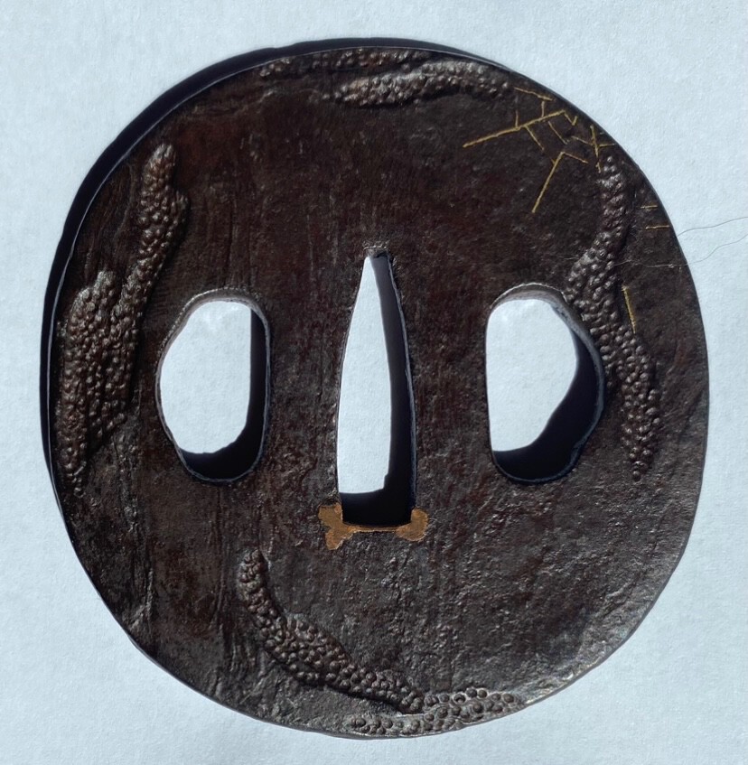

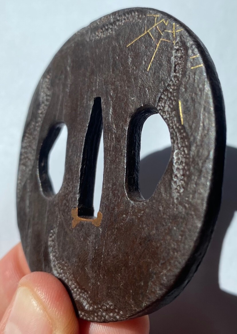

Mark S. Posted February 22, 2023 Report Posted February 22, 2023 A tsuba I just picked up… slightly different and probably a simpler design. Just thought it might be of interest. 9 1 Quote

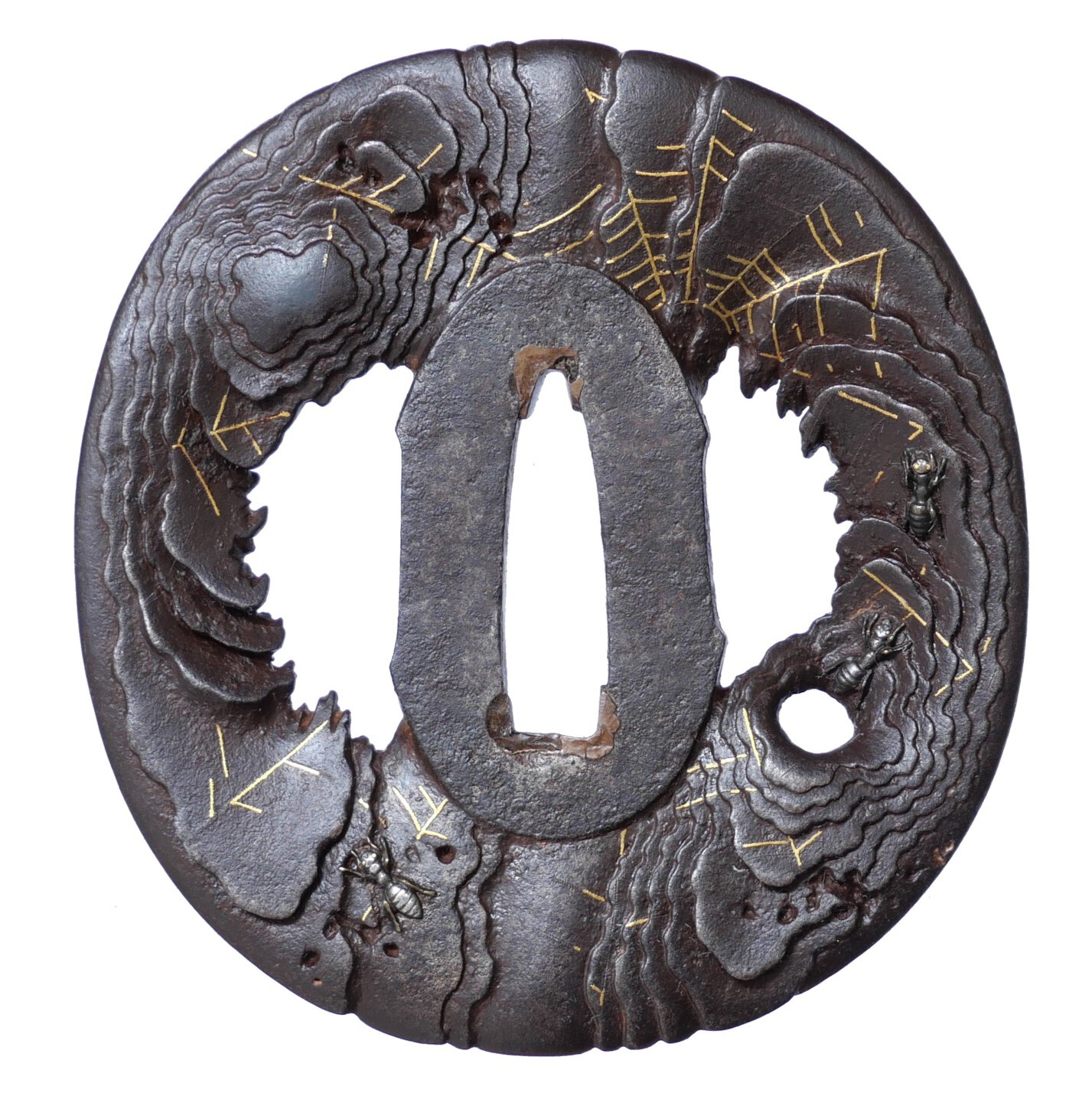

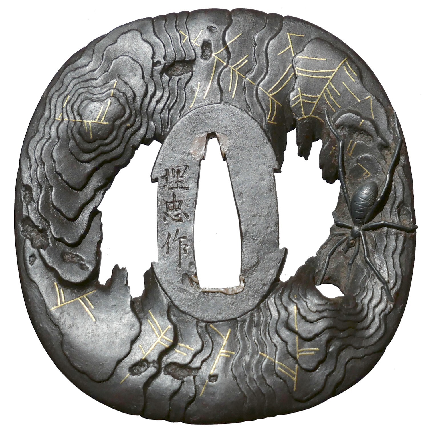

Popular Post Andi B. Posted March 18, 2023 Popular Post Report Posted March 18, 2023 I can contribute these two rotten wood tsuba for reference. First I found the Umetada signed one (Japanese auction) and few months later there was the ant piece on ebay. I couldn't resist because they make a nice pair - so they're not for sale. It looks like there is a template for the wood pattern/hole positions and this has been used by different artist. 8 7 Quote

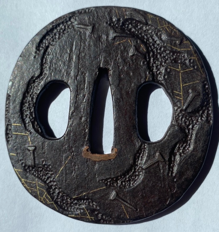

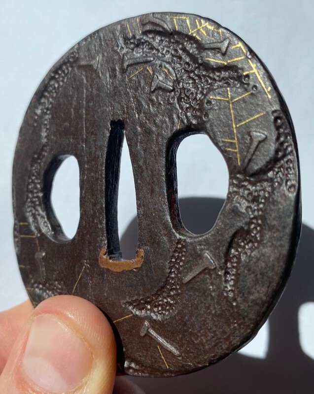

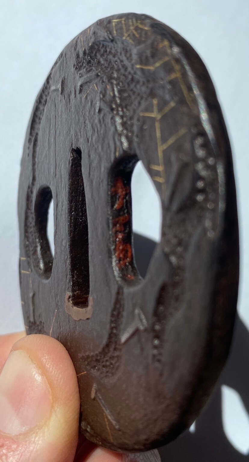

Mark S. Posted May 29, 2023 Report Posted May 29, 2023 Reviving this older thread. Picked this tsuba up a while back and I think it kinda fits the theme of this thread. Anyone know the significance of spider webs and nails? Also, I am used to iron tsuba, but this one is ‘brown’ and has a smooth finish that almost looks ‘painted’ on? Lacquer or something else? There are also a couple red kanji in one of the openings, but your guess is probably better than mine. Thoughts and opinions welcome. 1 Quote

Larason2 Posted May 29, 2023 Report Posted May 29, 2023 Mark S. The details look a bit coarse and washed out, and I think I see a casting bubble on the ura side. The rim doesn't look traditionally hammered. The sekigane doesn't look right to me, almost like it has pieces that chipped off. So not a high quality piece, anyway, and possibly cast. Quote

Mark S. Posted June 2, 2023 Report Posted June 2, 2023 On 5/29/2023 at 2:43 PM, Larason2 said: Mark S. The details look a bit coarse and washed out, and I think I see a casting bubble on the ura side. The rim doesn't look traditionally hammered. The sekigane doesn't look right to me, almost like it has pieces that chipped off. So not a high quality piece, anyway, and possibly cast. I apologize for not responding sooner. Thank you for giving your thoughts. This one is different than what I am used to. Oh well… learning experience. Quote
Matsunoki Posted June 2, 2023 Author Report Posted June 2, 2023 On 5/29/2023 at 4:14 PM, Mark S. said: There are also a couple red kanji in one of the openings, These are possibly old collection notations. I’ve had red lacquer kanji on tsuba in the distant past. It’s a harmless and inconspicuous way of doing it. 1 Quote
Larason2 Posted June 2, 2023 Report Posted June 2, 2023 Looking at it again, maybe I'm wrong about the casting bubble and sekigane. It would also be unusual to have a cast tsuba without a signature! Still, the details aren't in sharp relief. I do see some facets on the rim, so maybe hammered. I shouldn't be so hasty in making comments! Quote

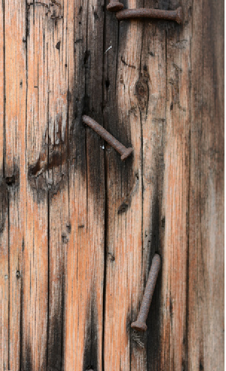

Matsunoki Posted June 2, 2023 Author Report Posted June 2, 2023 I can’t figure the significance of the nails…..but then a weird thought breezed in……..could it be a “pun” on the material the tsuba is made from ie old nails? I believe it did happen a fair bit?…….yes I know…..crazy. Anyone do any better……maybe @Spartancrest 🙂 (imo….not cast) Quote
Spartancrest Posted June 3, 2023 Report Posted June 3, 2023 12 hours ago, Matsunoki said: old nails? I think it might be related to something the smith might see every day on the walls of his forge - bent nails in the boards? [hand made nails of course] There are examples with what look like barbed wire or staples through them - I can't find images off hand. 1 1 Quote
Larason2 Posted June 3, 2023 Report Posted June 3, 2023 It's an interesting thought, because famously Japanese traditional woodworking and architecture doesn't use nails. The joints are cut precisely, and if they need fasteners they use wooden pegs. So I'd imagine that nails are a specific reference to Western culture. 3 Quote

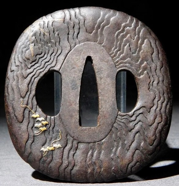

Spartancrest Posted June 3, 2023 Report Posted June 3, 2023 This is another wood grain tsuba with ten-zogan and nunome - elongated hitsu but no wasp or spiderweb https://www.ebay.com.au/itm/285290708562 or https://www.jauce.com/auction/l1028416899 Quote

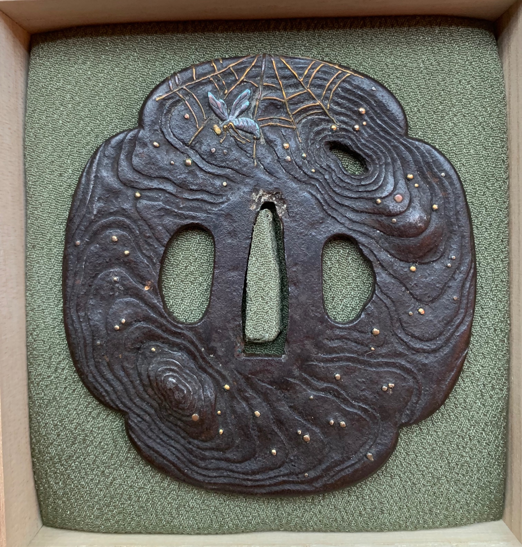

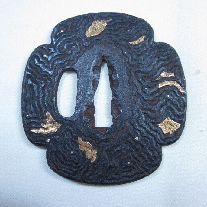

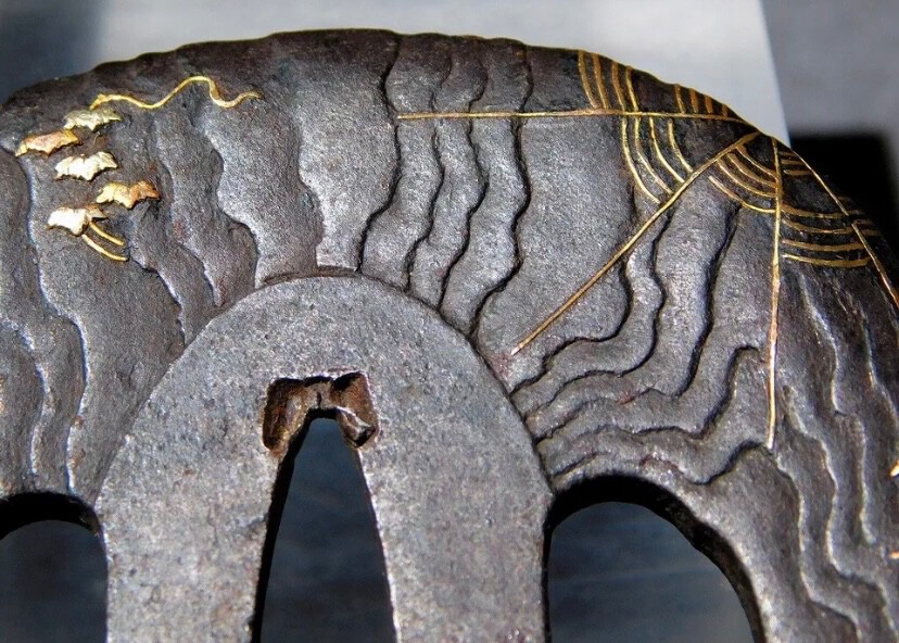

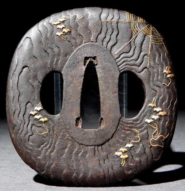

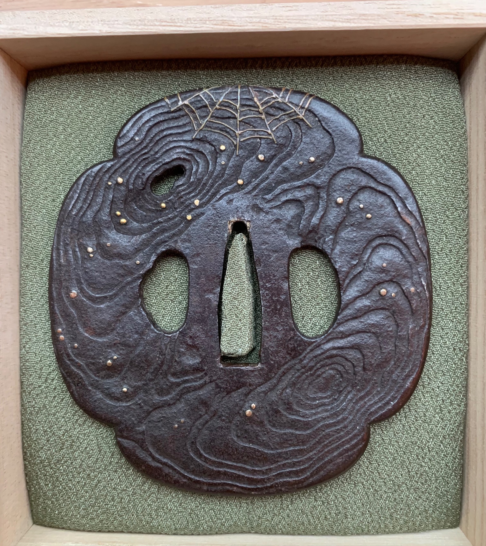

dimitri Posted March 28 Report Posted March 28 I hope I'm not bothering anyone by reviving this thread about these rather unusual tsuba. Here's mine with the wasp. The second one is one I saw online. There was one for sale in the Haynes catalog, number 54. The description said it was in the Bushu school style. 3 Quote
