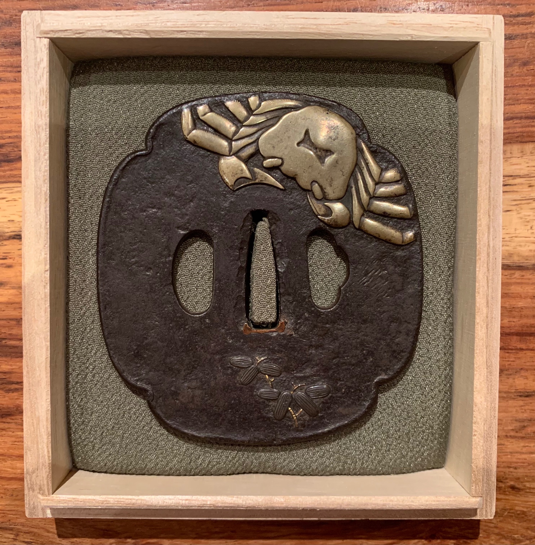

Matsunoki Posted February 17, 2023 Report Posted February 17, 2023 Hello from the UK, Another recent acquisition. I’m really getting the tsuba bug. I bought this simply because I like the bold subject and it looks well made. It’s large….8.7cmH and 8.0Cm W. The plate is quite thin Any help re age/school would be most welcome. Please tell me if I’m buying poor quality things. Many thanks. All the best. colin 7 Quote

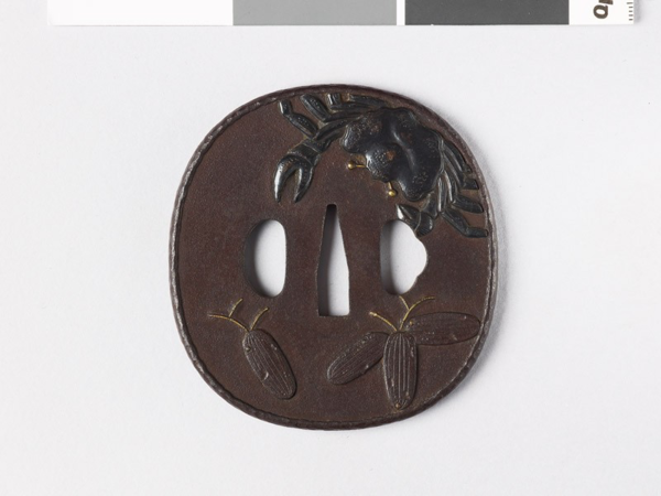

Grevedk Posted February 17, 2023 Report Posted February 17, 2023 Good evening Colin, Nice tsuba and a fine choice of motive. Another Shoami tsuba with a slightly different design but with a similar motive from : http://jameelcentre.ashmolean.org/collection/7/10237/10350 And be careful - collections tend to grow fast, and just as swords, Tsuba tends to become an addiction 😜 /Soren 3 1 1 Quote
Spartancrest Posted February 18, 2023 Report Posted February 18, 2023 A few more similar, including another from the Ashmolean museum not part of the A. H. Church collection. http://jameelcentre.ashmolean.org/collection/4/867/873/12746 https://www.worthpoint.com/worthopedia/Japanese-samurai-antique-tsuba-crab-1750619193 https://collections.mfa.org/objects/13350/tsuba-with-design-of-crab-and-grasses?ctx=ac649585-690e-46f3-a1d1-693c279367e3&idx=1 Tsuba with design of crab and grasses Akasaka Tadashige Akasaka School: Signed Tadashige 忠重 I fear Soren is correct, tsuba collecting is a hard thing to try and go 'cold turkey'- you need a regular 'fix'! 2 1 2 Quote
Matsunoki Posted February 18, 2023 Author Report Posted February 18, 2023 You guys are great….thank you all so much. I really am at square 1 with tsuba knowledge. It’s easy to research when you know what to look for ie school names etc and that’s where I’m lacking. I had tried looking for “crab tsuba/iron tsuba with crab” etc but didn’t get much luck. Yep,I’ve been bitten as you will see when I post a few more. Re. this one….any views re age? I would hazard a guess at early 19thC Arigato gozaimasu. All the best. Colin 1 Quote
Soshin Posted February 18, 2023 Report Posted February 18, 2023 Hello Colin, I once had a menuki set with the same bamboo and crab design. I would agree with Curran's call of it being the work of the Aizu Shoami School. In terms of age of would say early Meiji Period to late Edo Period circa early to mid-19th Century. It is hard to be much more specific given your tsuba isn't signed. Check out my link below my personal collection website. I have been collecting for a while now had have amassed a sizable collection myself not to mention all the tsuba I sold directly and indirectly when I had my Japanese art and antiques business. 2 Quote
