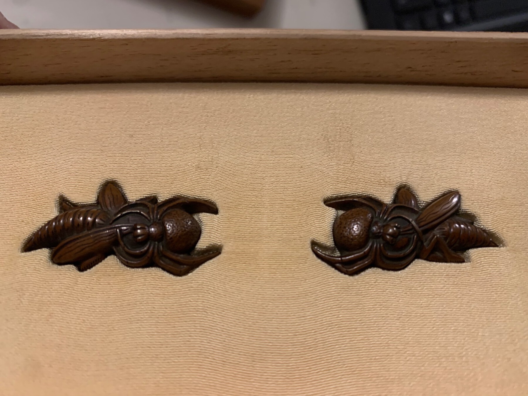

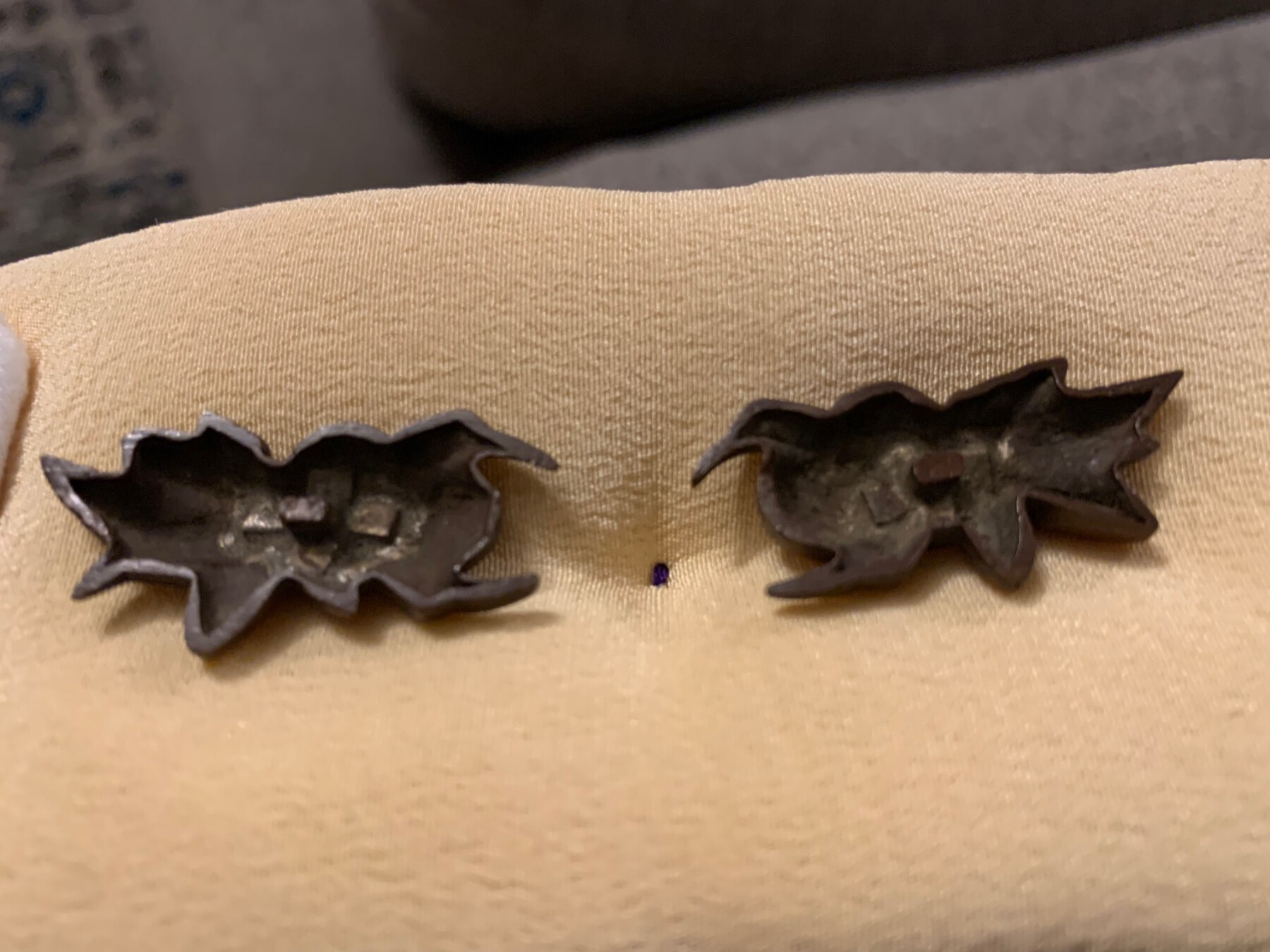

Infinite_Wisdumb Posted February 17, 2023 Report Posted February 17, 2023 I can’t place these in the books and resources I have. Thoughts on era or any other info? 1 Quote

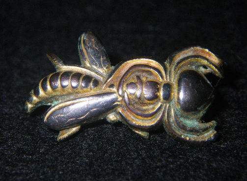

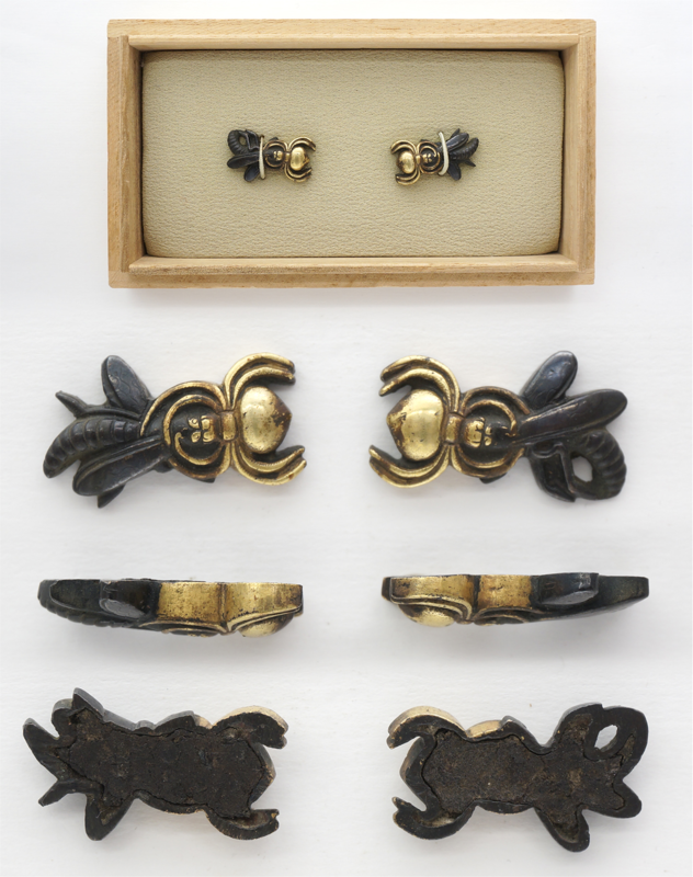

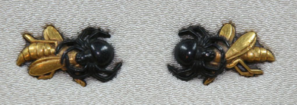

Spartancrest Posted February 17, 2023 Report Posted February 17, 2023 https://www.ebay.com/itm/255177425983 and https://soryu.pl/products/shakudo-menuki-with-spider-eating-a-wasp https://www.bonhams.com/auction/22815/lot/171/six-pairs-of-menuki-one-pair-by-yasuchika-19th-century-18/ http://tetsugendo.com/GalleryMenuki.html Excellent shakudo and gold menuki of spider devouring hornet/wasp. Goto school menuki of spider and wasp. Seen on many Juyo sets of Goto kodogu, this is a very classic design. My first thought is this design is pretty popular - second thought is pretty common. 2 1 Quote

Spartancrest Posted February 17, 2023 Report Posted February 17, 2023 A few more for good measure. https://www.aoijapan.net/menuki-mumeiunsigned-spider/ https://www.pinterest.com.au/pin/312789136594341019/ What stands out to me is very little information on who or when they were made so it is back to square one. 1 Quote
Spartancrest Posted February 17, 2023 Report Posted February 17, 2023 https://aucview.aucfan.com/yahoo/m1070851847/ https://page.auctions.yahoo.co.jp/jp/auction/b285404825 This one is a tobacco pouch ornament. This image from a 'Proxy' site very likely bogus so I won't add the link. https://sword-auction.com/ja/product/6384/af17497-揃金具:無銘後藤-伝-栄乗-蜘蛛と蜂/ Goto attribution. Try a search using these kanji - クモとハチの目貫 2 Quote
Infinite_Wisdumb Posted February 17, 2023 Author Report Posted February 17, 2023 I had the same issue Dale. Goto seems a common time. No others so far that are just yamagane without shakudo that are of decent quality. Wonder what the theme purpose is? "Hunter being hunted?" Quote
Bugyotsuji Posted February 17, 2023 Report Posted February 17, 2023 智勇兼備 The NBTHK paperwork above describes the menuki as Chi Yu Zu (design). 'Chi-Yu Ken Bi', the ideal warrior (or general) will have equal measures of both wisdom (spider?) and courage (wasp?). They are also two of the 三徳 three virtues, wisdom, benevolence and courage. There is also a Buddhist story 'Kumohachi' which I have not researched yet. 3 Quote
Infinite_Wisdumb Posted February 17, 2023 Author Report Posted February 17, 2023 8 minutes ago, Bugyotsuji said: 智勇兼備 The NBTHK paperwork above describes the menuki as Chi Yu Zu (design). 'Chi-Yu Ken Bi', the ideal warrior (or general) will have equal measures of both wisdom (spider?) and courage (wasp?). They are also two of the 三徳 three virtues, wisdom, benevolence and courage. There is also a Buddhist story 'Kumohachi' which I have not researched yet. Great stuff Piers, thanks! Quote
Infinite_Wisdumb Posted February 17, 2023 Author Report Posted February 17, 2023 Wondering if this is worth sending to shinsa..... Quote
