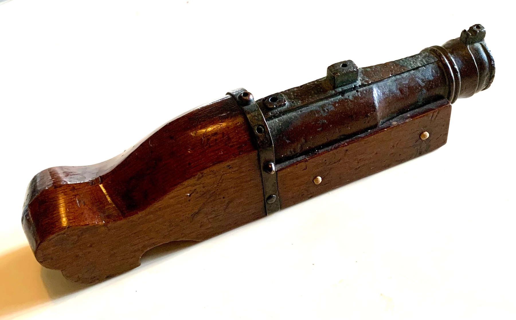

Bugyotsuji Posted February 15, 2023 Report Posted February 15, 2023 I have a Japanese cannon which has a swelling at the breech end. This is probably because it is made of cannon bronze, gaining extra thickness where the chamber (initial explosion) is. I would have to say though, that this is an exception, reminding me somewhat of some Western cannon. Most Tanegashima have their maximum thickness at the breech, but gradually grow slimmer towards the muzzle, with some swamping to be seen, but generally they present a long straight appearance with no 'swelling'. I suppose it is possible that some very early guns from before makibari binding was invented needed a swollen breech for extra security... (?) but in all my years I have never consciously seen an example. Quote

Bugyotsuji Posted February 16, 2023 Report Posted February 16, 2023 Yes, that sounds about right, Leon. Here is my small Japanese bronze cannon, by the way, for illustration. This is atypical (non-typical) I would say, almost stepped, most having more of a gentle taper with the greatest thickness at the breech end. Even the Indonesian Lantaka cannon keeps an overall straighter tapered profile. Having said all that, your question is so unusual that I would need to go back and look at everything with fresh eyes before commenting further! 2 Quote
