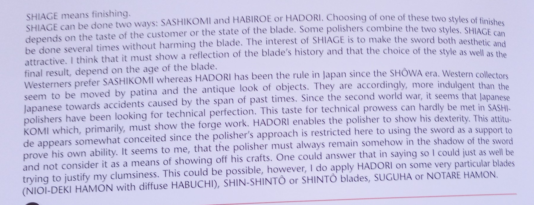

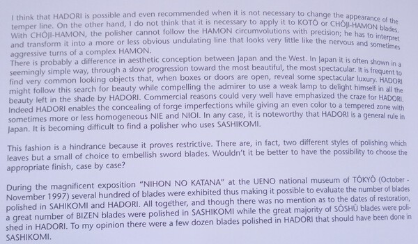

I ran out of likes!!!  Big tick to Franco's piece above.  I was especially taken with the excerpt I've attached from the link given.  This interview should (IMHO) be essential reading for anyone who aspires to collect Nihontou.

Jimmy_Hayashi_Polisher8_screenshotextract.thumb.jpg.243f38d90075e07ae766136d2291701b.jpg

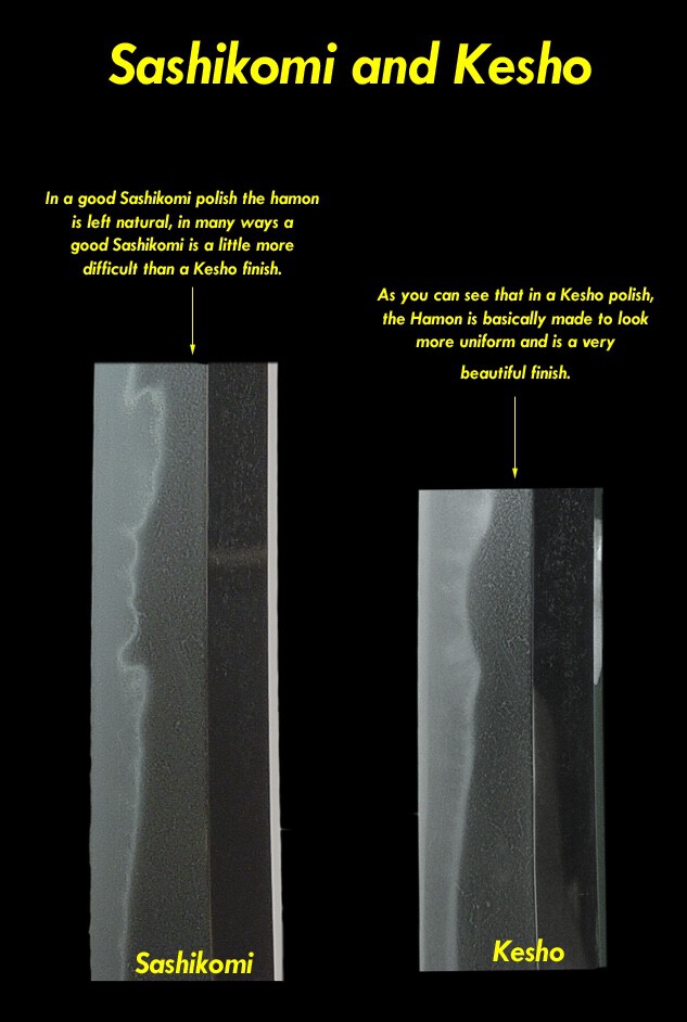

In the image below of the same blade section done in the two  different styles I know which I prefer and which shows the hamon to best advantage.
  • Downvote 1
