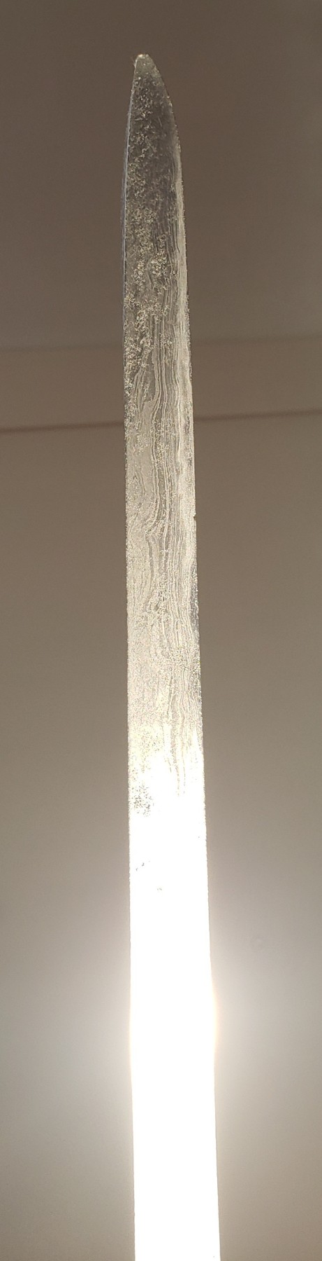

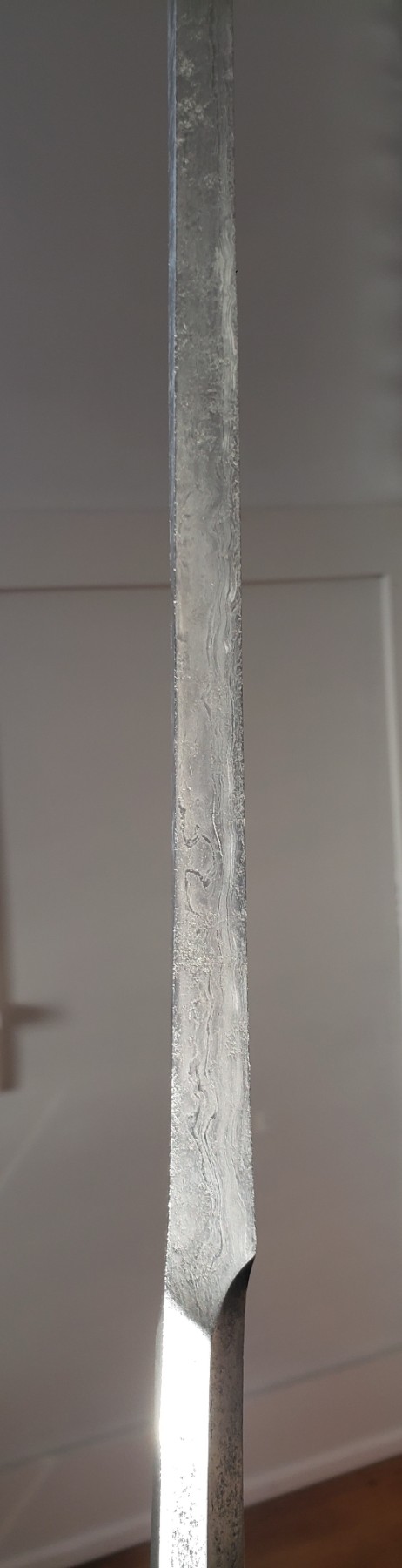

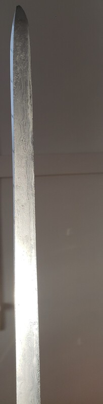

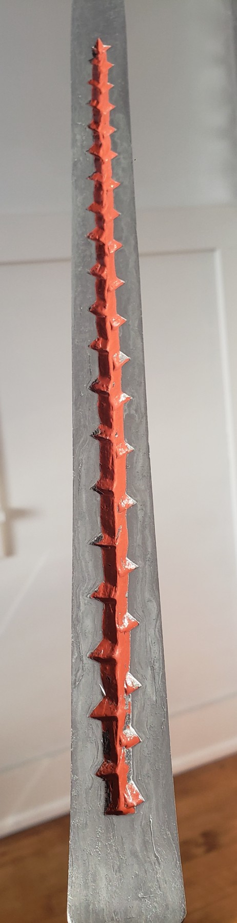

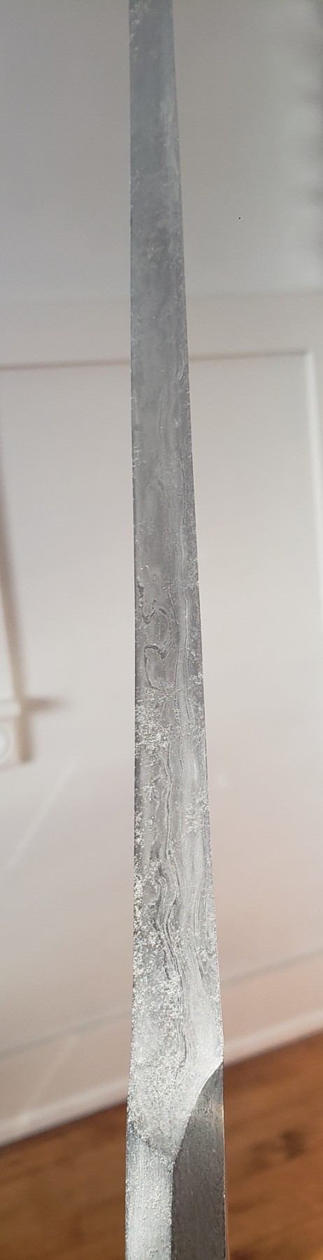

I'm fighting a losing battle with a junk phone camera and a setting sun. Anyone want to try and take a shot on what you think of this yari? I was thinking kanabo school, but partial mei doesn't add up to that.

The red laquered flame groove is very unusual. Long karakubi is the sign of an old blade. The blade seems to have gone through an acid treatment. Some pictures of the nakago will help. I agree with Ken, something doesn't feel quite right.
The kusabi-hi isn't that unusual. I have only seen a few yari that have it though.
