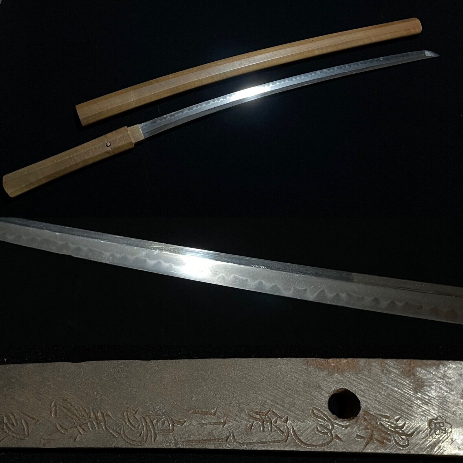

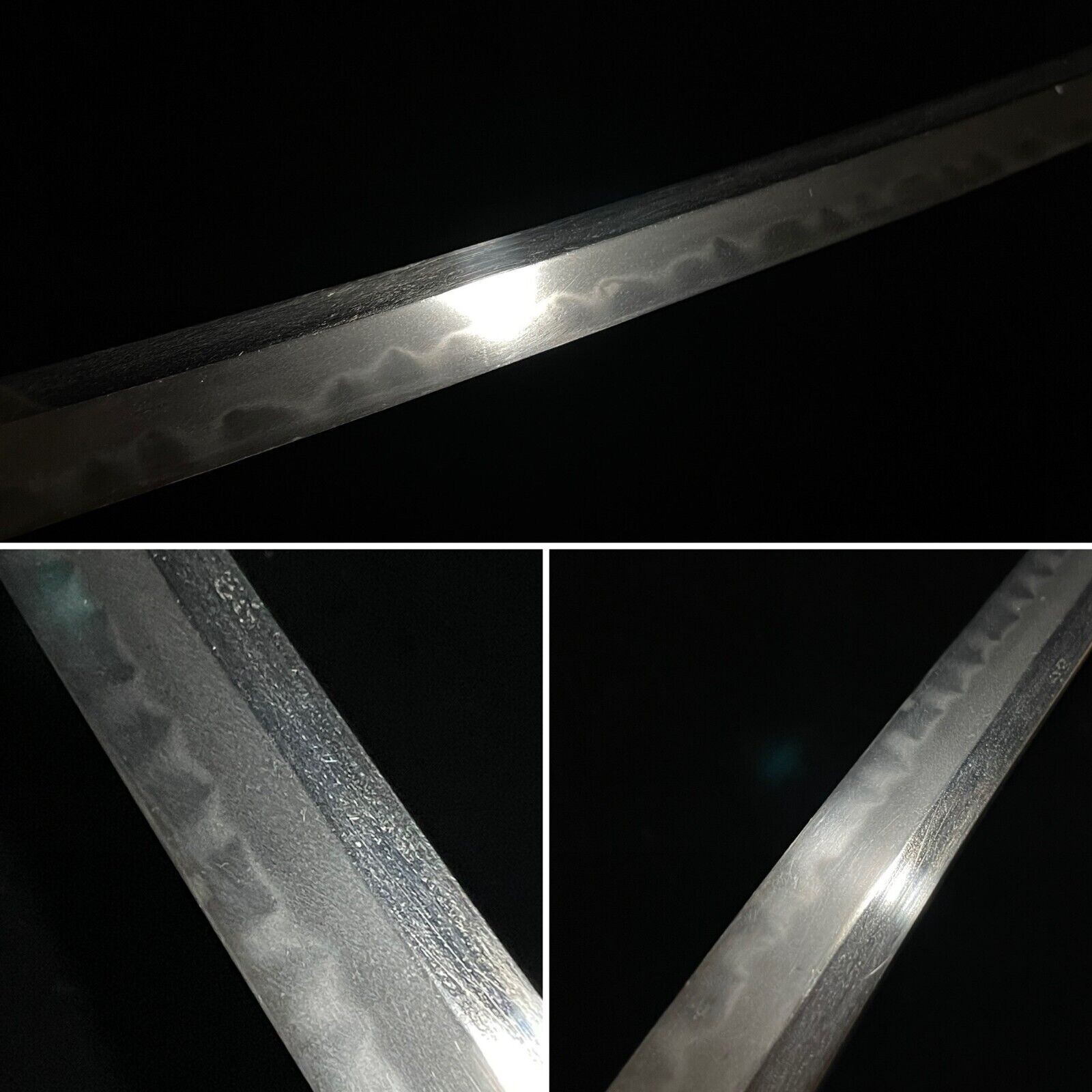

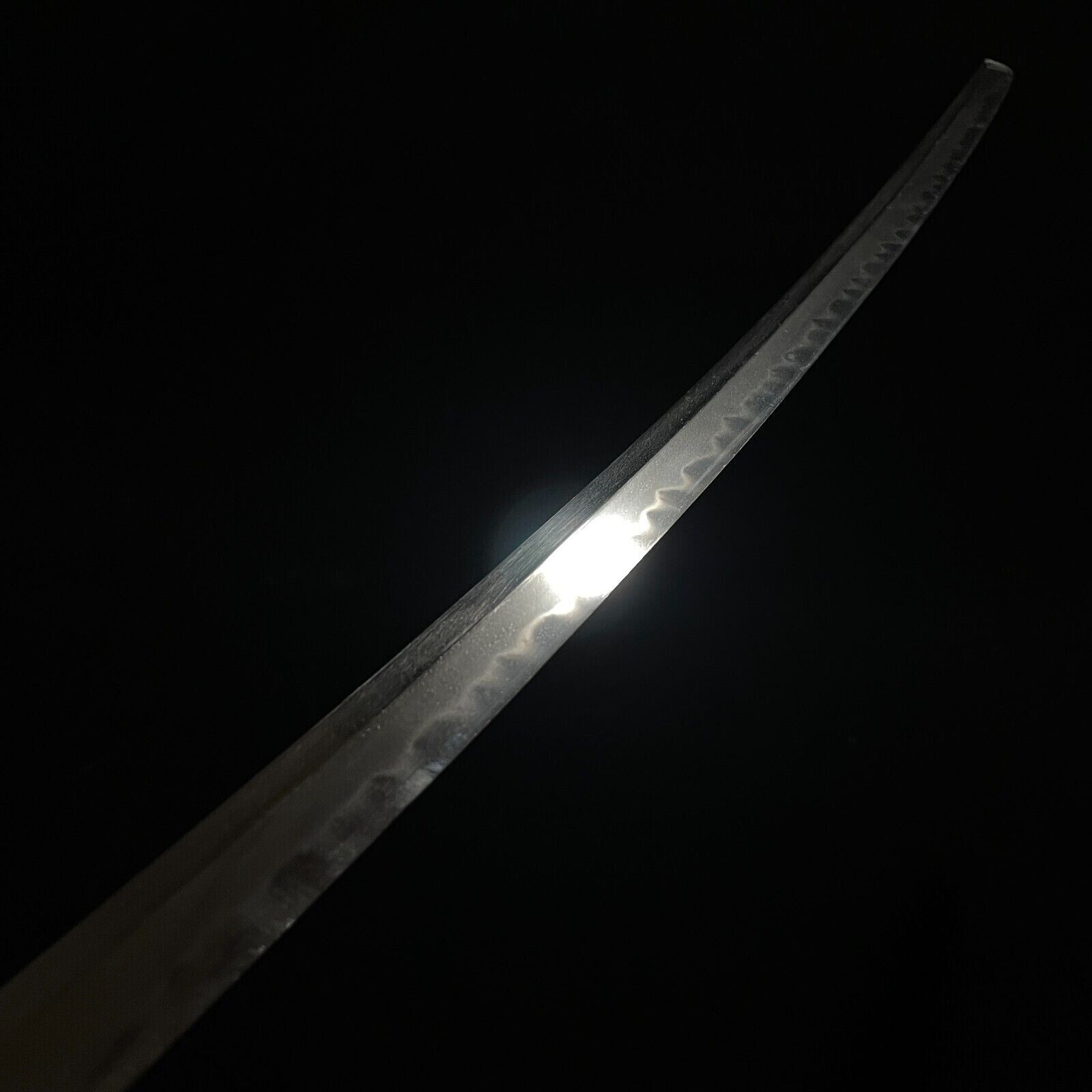

@Michaelr  - this is from an ebay sale.  I think it's still active if you search for it.  It's an undated Yoshikane in shirasaya:
1381620874_s-l1600(5).thumb.jpg.c7b4b2d6af5261196c59d6ad3a481071.jpg399477857_s-l1600(6).thumb.jpg.e8b67d45cb72d48ac68d7673a12f5173.jpgs-l1600.thumb.jpg.091bca3b6c29149d73c8fea142811c8c.jpg
In this state of polish I would not confirm this blade was made from folded steel. The HAMON reminds indeed of an oil quench, but there is no metallurgical reason to fold alloyed industrial steel.
Only a clear evidence of HADA on a traditionally polished blade would be a proof of folded steel. For my old eyes, the above photos do not show that.

Thanks Simon!  So the blade got a Hozon rating even though it's clearly showato.  Reminds me of the Mantetsu that recently got a rating.
So, the evidence that we have in hand still supports that showa stamped blades were showato.
PS: For clarity, I have 30 Kanemichi blades on file - 26 are showa stamped, 4 have the large Seki stamp.  So, technically, this blade could have had a large Seki removed, but the odds are in favor of it being a showa.
