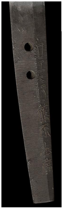

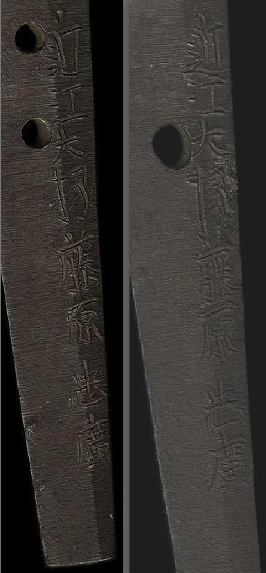

Mark S. Posted July 23, 2009 Report Posted July 23, 2009 Just to highlight this topic. AOI has two Tadahiro (I assume same smith by their description) blades currently for sale. When I compared the signatures side by side, there are some differences that to a complete novice (ME) look like some of the same differences that are discussed on this board for reasons to question whether it is the same smith or gimei, etc. For example, the first character in the mei seems very different and the last two characters have minor differences. Not questioning AOI in any way! Just trying to learn and I thought it was timely that two swords by the same smith were available for discussion. Just wondering if anyone has any thoughts on these mei's and their differences. Mark S. Quote
paulb Posted July 23, 2009 Report Posted July 23, 2009 Mark, I haven't looked at the swords on Aoi but if it is the nidai Tadahiro his workig life spanned over 60 years so there is a lot of variation in his signature. Also his son Sandai Tadayoshi used to produce daimei for his father. It is possible to tie down the period of manufacture of the Nidai's work based on the variations in his mei. Roger Robertshaw's book shows great examples of this. Quote
Jacques Posted July 23, 2009 Report Posted July 23, 2009 Hi, Mark S. said: Just to highlight this topic. AOI has two Tadahiro (I assume same smith by their description) blades currently for sale. When I compared the signatures side by side, there are some differences that to a complete novice (ME) look like some of the same differences that are discussed on this board for reasons to question whether it is the same smith or gimei, etc. For example, the first character in the mei seems very different and the last two characters have minor differences. Not questioning AOI in any way! Just trying to learn and I thought it was timely that two swords by the same smith were available for discussion. Just wondering if anyone has any thoughts on these mei's and their differences.Mark S. If i'm not wrong, the item 08727 is signed Musashi Daijo Fujiwara Tadahiro and is a blade from shodai Tadayoshi the other item 08112 signed Hizen koku Musashi Daijo Fujiwara Tadahiro is from shodai Tadayoshi too but clearly stated as gimei. Quote
Mark S. Posted July 23, 2009 Report Posted July 23, 2009 Probably should have been more specific - I was comparing item 09172 to 08710. Mark S. Quote
Jean Posted July 23, 2009 Report Posted July 23, 2009 Mark, "To be more specific" is to attach the links and not numbers!!!! Quote
Mark S. Posted July 24, 2009 Report Posted July 24, 2009 Not trying to be vague or difficult, just didn't have a lot of time to post last time. Hopefully this might help? Mark Quote
reinhard Posted July 25, 2009 Report Posted July 25, 2009 Mark S. said: When I compared the signatures side by side, there are some differences that to a complete novice (ME) look like some of the same differences that are discussed on this board for reasons to question whether it is the same smith or gimei Mark, There is no standard procedure of how to verify/falsify a signature. What goes for KOTETSU and Kajibei cannot be applied to nidai TADAHIRO's mei and some minor changes occuring during his long span of working. Both mei look quite allright to me and what's more important: They are placed where they should be. reinhard Quote
Jean Posted July 25, 2009 Report Posted July 25, 2009 Mark, before checking the mei, which is the last thing to do, you must check the craftsmanship. Hada, hamon : do they fit the era, the school, the kaji. When you come to the nakago : check the nakago jiri, the yasurime : if they fit the kaji work, only then you can have a try at the mei. That's what I like with koto O suriage blades, you have no pollution coming from a mei. You can concentrate on the school. Kantei is about the same as wine tasting/testing Quote
