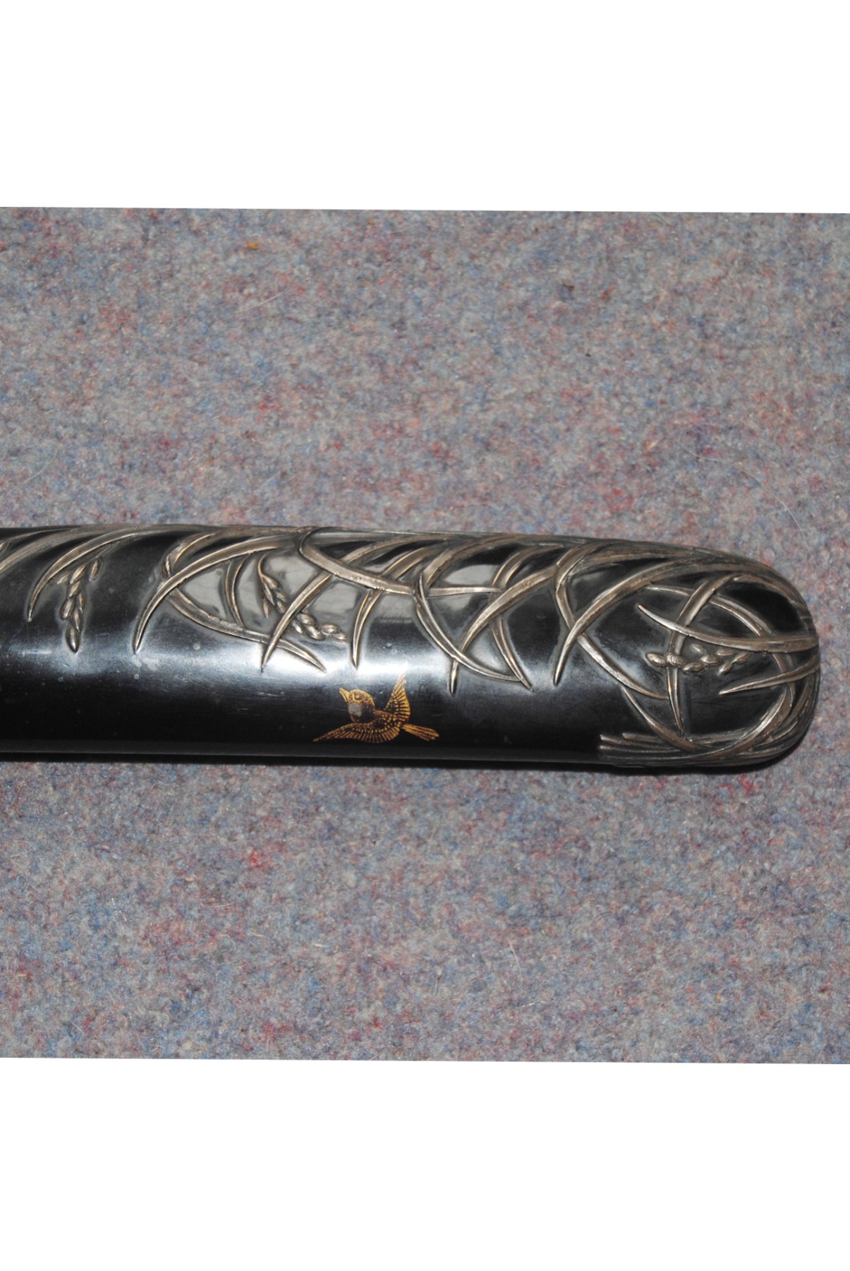

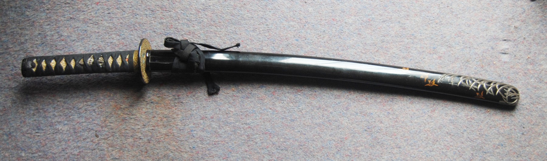

This tale started one evening whilst I was idly scrolling through images of swords coming up for sale on various on-line auctions. Amid the usual offerings of Chinese fakes, guntō, and older nihontō, was an image that showed, of all things, a spectacular silver kojiri partially embedded in the black lacquer of a saya. The only other image of the sword the auction house had posted was a somewhat out-of-focus shot taken from the end of the tsuka, showing that the kashira was missing, that the tsuka maki was black and there was a circular tsuba that was textured in some way. Purely on the quality of that kojiri I resolved to buy that sword if I possibly could. Came the day of the auction I had a brief bidding-tussle with someone before the sword was knocked down to me at a price that was rather more than I had anticipated, but was bearable.

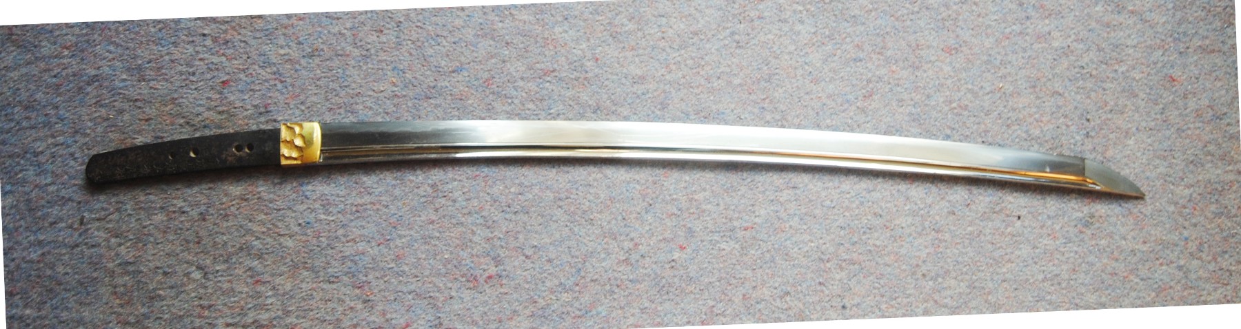

What I had bought was a heavy blade with a 604mm nagasa, 16mm torii zori with a wide hi in the shinogi ji with a narrow hi along the line of the shinogi. The kissaki is of moderate length with only a short kaeri. The hada is a tight itame and there a slightly irregular suguba hamon with utsuri. Swords of this type, designed for use with one hand, are known as katate uchi tō.

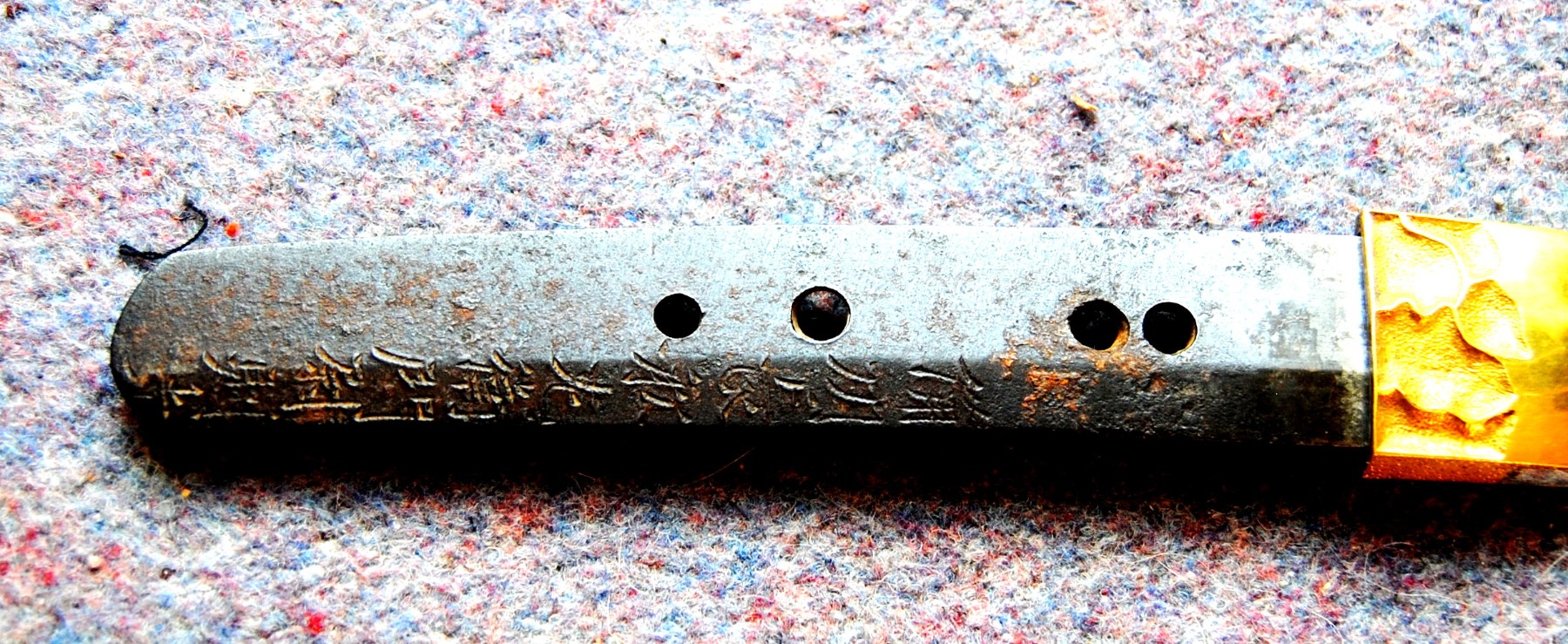

The blade is signed:
Bishu Osafune Saemonjo Norimitsu -  備州長船左衛門所則光
Dated:
Onin 2nd year, 8th month, a day - 応仁ニ年八月日 (1468)
Hawley lists a number of smiths using the name Saemonjo Norimitsu working in Osafune around this time, in particular, three generations founded by one whose work is rated in Afu Watson’s translation of Nihon To Koza as being rated Juyo Bunkasai or Important Cultural Property. The latter work has a complete section on the founder of the group giving details of his work that suggests I may have been rather more fortunate than I initially thought.
Could it be I had acquired a blade by the founder of the group? Was it, a ‘fake’ or had I found a lost ‘masterpiece’? I think I have and will leave the readers of this to draw their own conclusions.

Wow Ian, that’s some kojiri!
how about the f\k , menuki and tsuba?
Habaki suggests quality.
Still trying to work out position of ana vs Mei vs date.  Nakago doesn’t look suriage?
Well done I’d say.
Colin
Nakago is suriage, although better finished than many. Patina on the nakago looks good, and suggests it was done a loong time ago. If it was longer, the sugata looks like it would have been quite spectacular. The hi suggests quality. I'm not qualified to comment on the maker, but it certainly looks interesting. I'd say a good buy.
Interesting. At first sight given the mei's and the date location in accordance with the fashion of the time (Bizen mono) this sword seems shoshin. The nakago is ubu. it deserves to be shown to real experts (NBTHK shinsa).
ps Hawley is not reliable.
I am aligned with Jacques here. Either ubu or close to ubu and slightly suriage. A lot of these Muromachi katateuchi were in the 60-65cm ballpark.

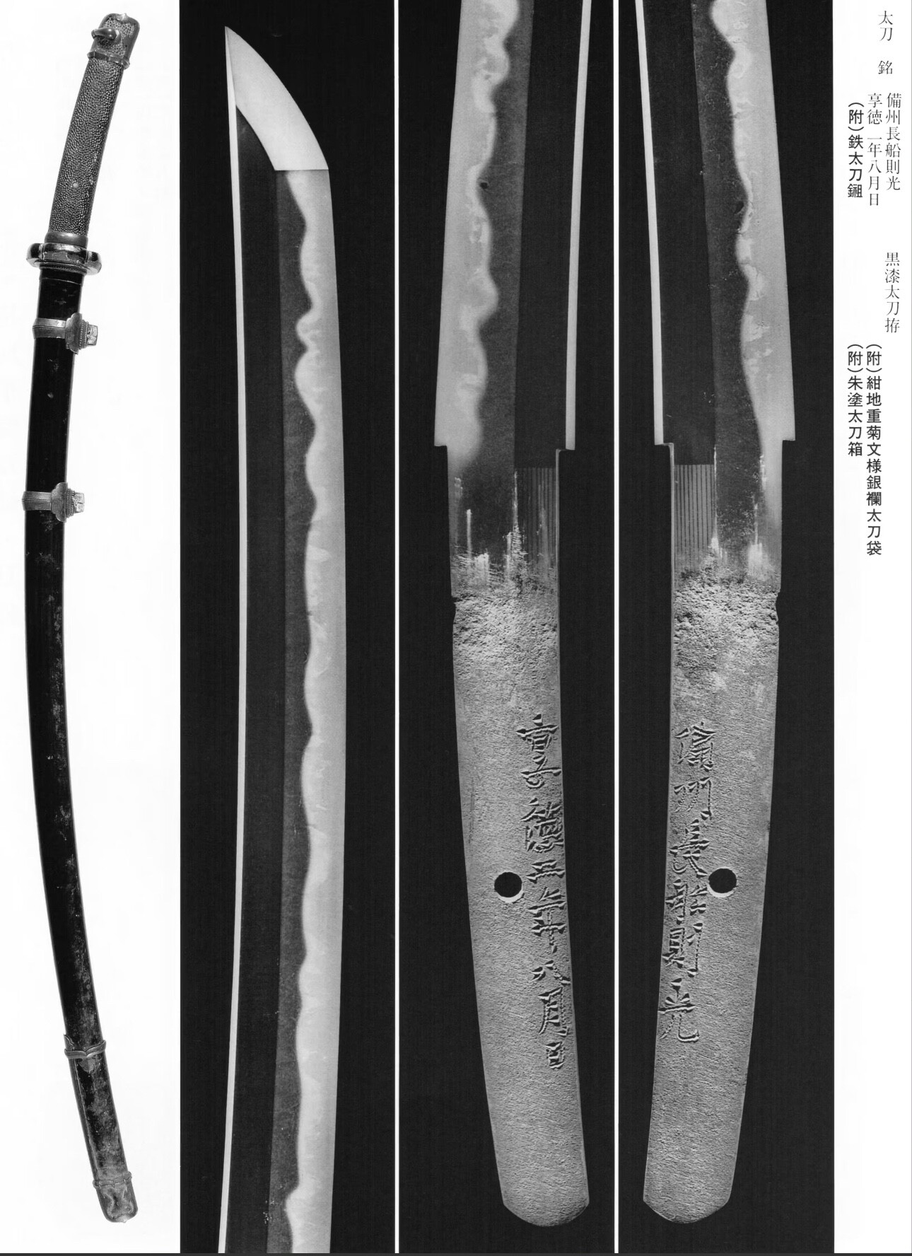

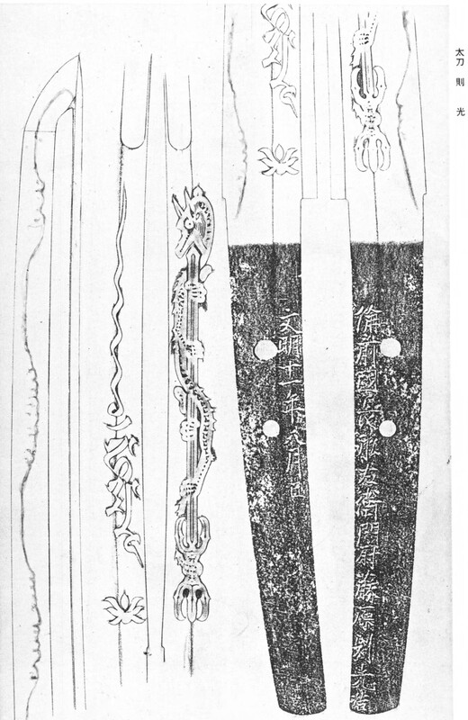

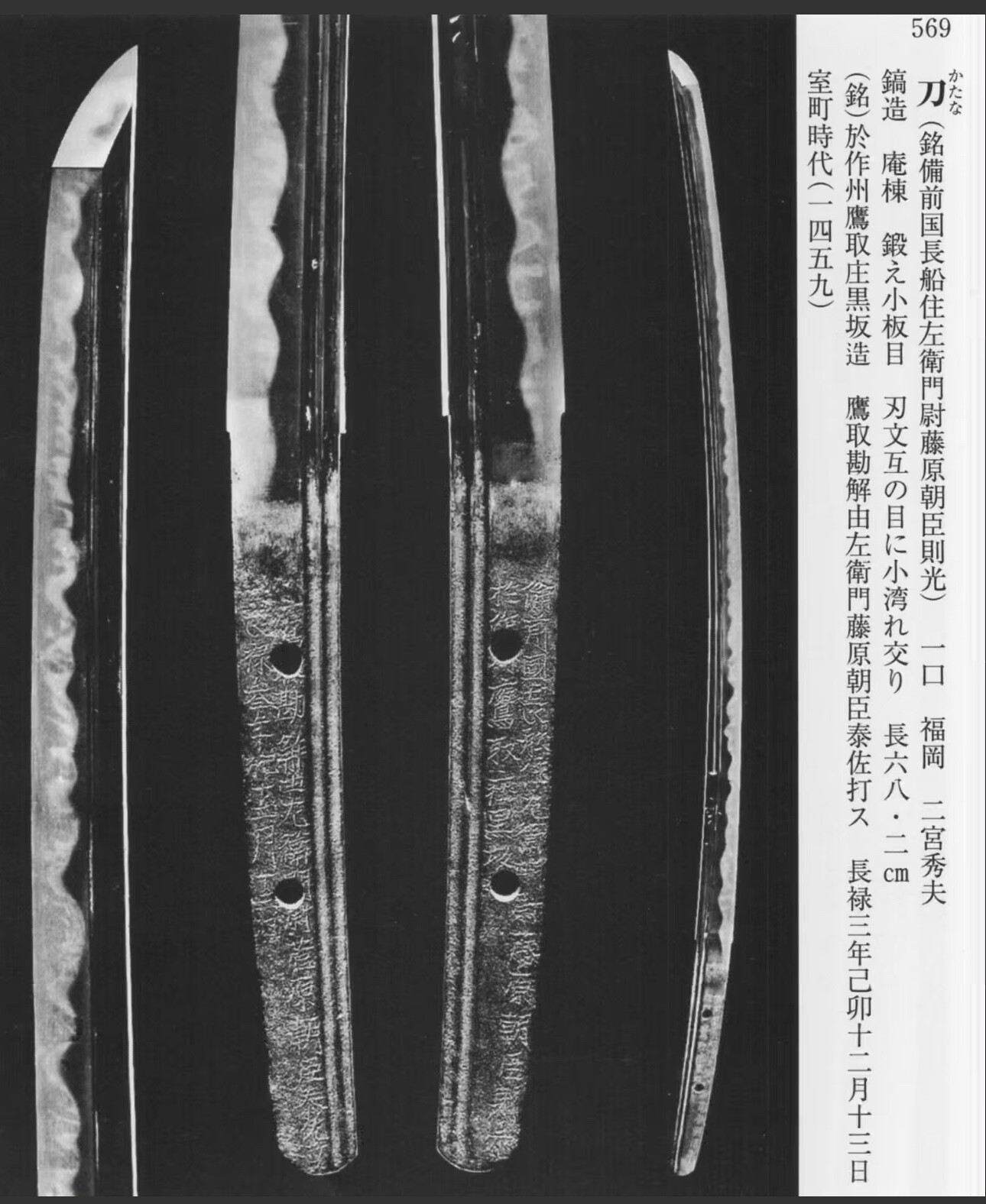

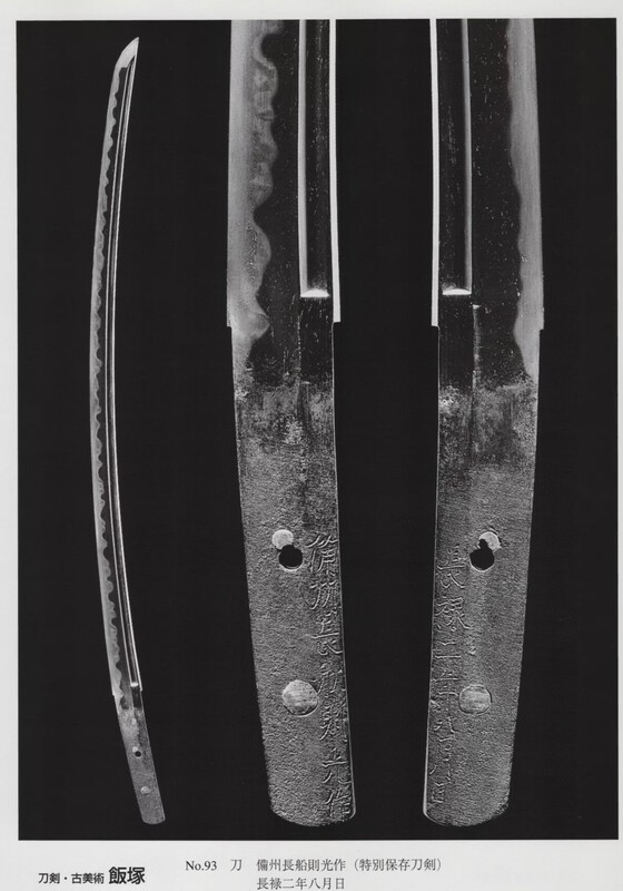

A few of the better Norimitsu swords in the 1460-1480 period attached, including the JuBu.
One (oshigata / earlier Juyo) is signed Saemonnojo.

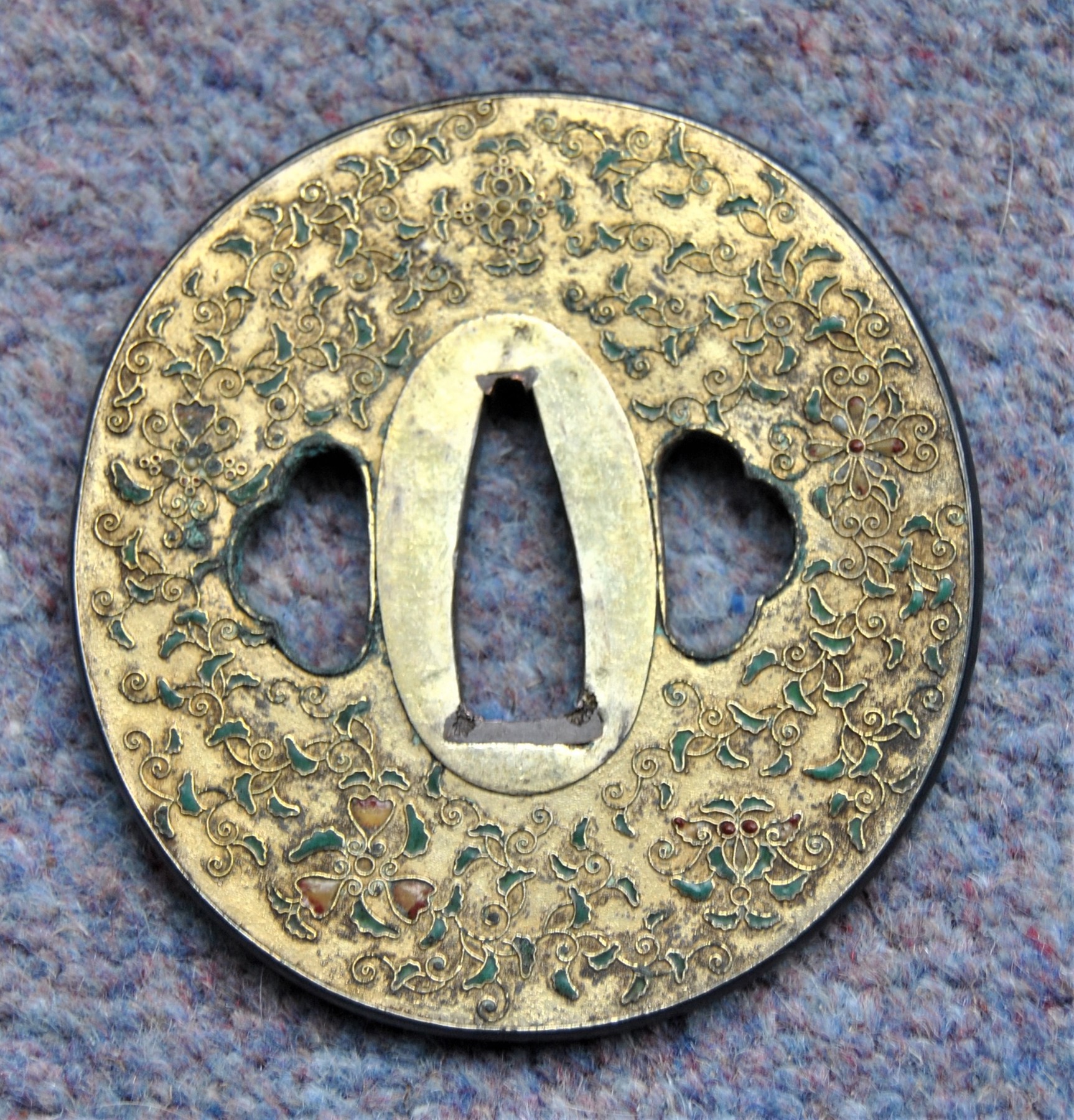

Jean C,  Here is a picture of the tsuba I mentioned. It has been ascribed to late Umetada School, but I know so little about sword fittings I wouldn't like to say.
Ian
