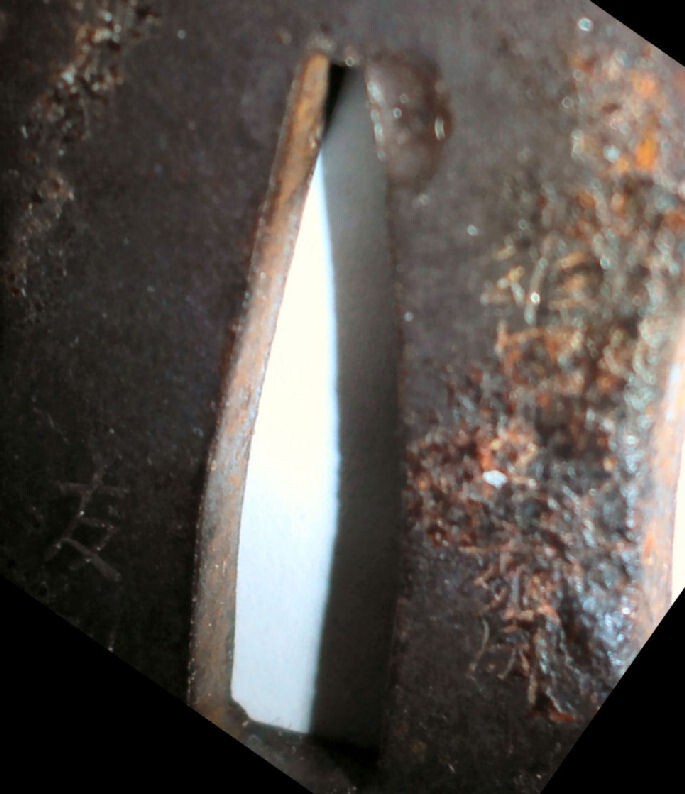

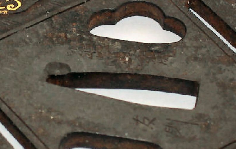

kissakai Posted February 1, 2023 Report Posted February 1, 2023 There is corrosion on the mei as shown in the images Closet I could find making iron tsuba is Yasunori 安則 Haynes H11227 - Chikugo (筑後) ju (住) On the NMB there have been a few swords with similar corrosion that have been translated so maybe someone can help with this one Fingers crossed Quote
kissakai Posted February 1, 2023 Author Report Posted February 1, 2023 Checked in Sesko and Wakayama, nothing I can see Kinko Meikan ref 570a - Yasunori - Hizen circa 1830 and 570b Yasunori saku kore Quote

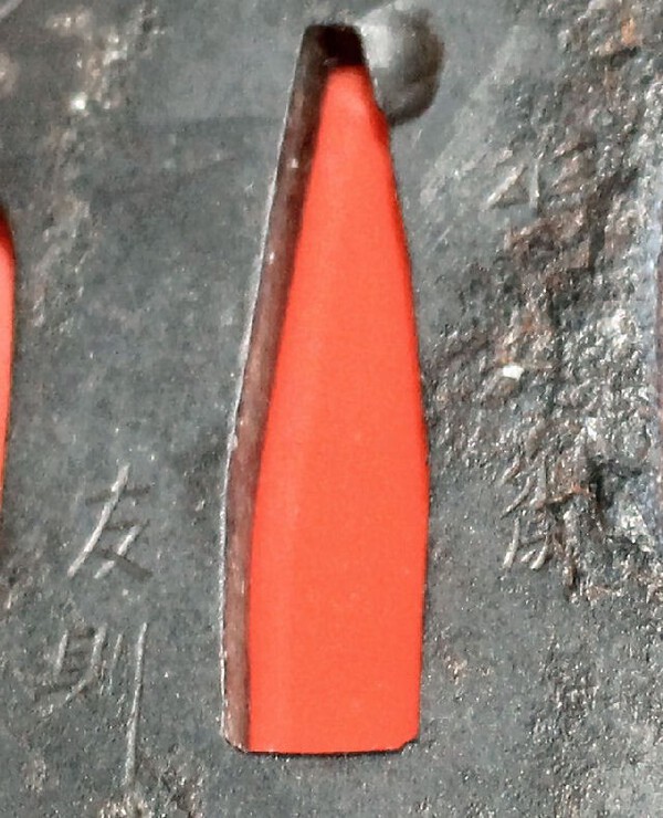

xiayang Posted February 1, 2023 Report Posted February 1, 2023 Not sure about the corroded bit, but the other side looks more like 友則 (Tomonori) to me. 3 2 Quote

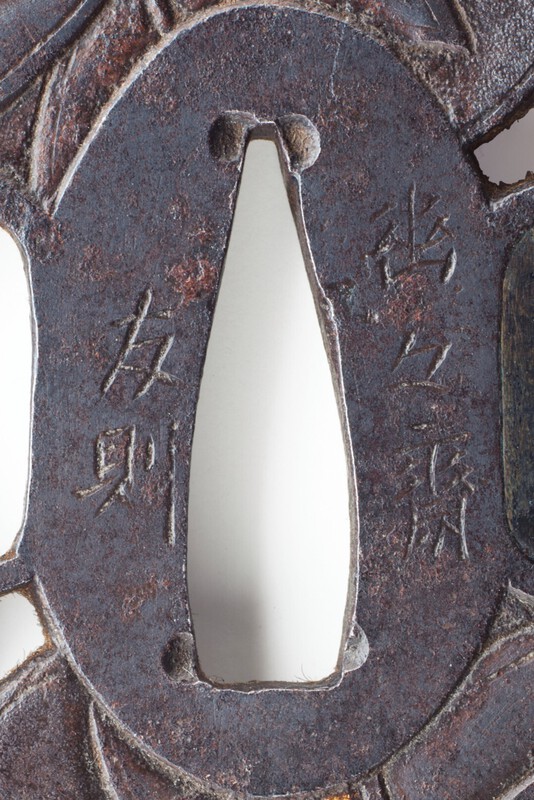

uwe Posted February 1, 2023 Report Posted February 1, 2023 A possibility: “生々斎友則” (Seiseisai Tomonori)?! Quote
Matsunoki Posted February 2, 2023 Report Posted February 2, 2023 Hi Grev For once I think the image is too “close up”. Can you try shining a light source across the area rather than straight down onto it? You can sometimes see a “ghost” of the kanji via shadows. Try it from all sides at various angles. Quote
Matsunoki Posted February 3, 2023 Report Posted February 3, 2023 Sadly doesn’t help much. What I meant (but didn’t explain it very well) was use a torch to shine a beam across the tsuba from the side or all around at various angles to see if it picks up the remnants of the kanji which can appear in the shadows created by the beam of light. It’s a technique I’ve used on corroded nakago with surprising results. It’s difficult to explain…..grab a torch and play around! Quote
Nobody Posted February 3, 2023 Report Posted February 3, 2023 Fine focus is always most important to me. 2 Quote
kissakai Posted February 3, 2023 Author Report Posted February 3, 2023 I think you may have a winner Quote
Matsunoki Posted February 3, 2023 Report Posted February 3, 2023 Bit better! I think we can see enough to say Okan has got it. Quote
