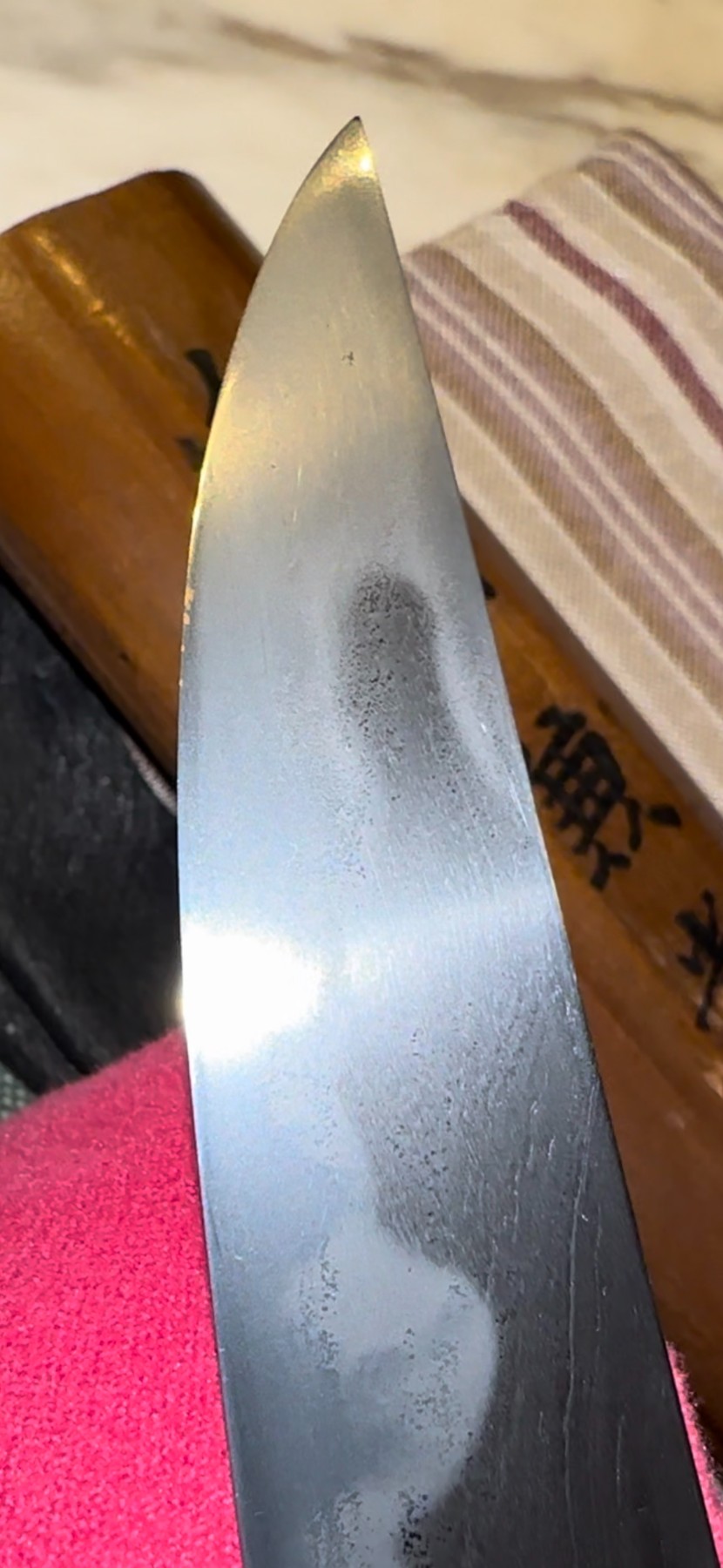

Okan Posted January 30, 2023 Report Posted January 30, 2023 Hi guys, I'm really not sure if this a fresh active rust or an old one..But I seriously don't remember it so must be a new...And I keep them oiled hmm Guess I've missed a spot..Is there a special uchiko method or something? (Polish is not an option) Quote
Wim V Posted February 1, 2023 Report Posted February 1, 2023 Hi, Maybe try rubbing gently with a piece of bone or ivory? I must say I'm quite surprised you have new rust developing in the Netherlands if you keep your swords oiled in shirasaya. Or do you live in a very humid environment? Quote
Alex A Posted February 1, 2023 Report Posted February 1, 2023 Id be surprised if that wasn't already there. Sometimes you just don't notice little marks, then notice them later. Quote
WillFalstaff Posted February 1, 2023 Report Posted February 1, 2023 Blade is ruined. Might as well use it as a hedge trimer or just ship it out to me Is the spot red? If it is it’s probably new active rust. Oopsies happen. Quote

Okan Posted February 1, 2023 Author Report Posted February 1, 2023 On 2/1/2023 at 11:12 AM, Wim V said: Hi, Maybe try rubbing gently with a piece of bone or ivory? I must say I'm quite surprised you have new rust developing in the Netherlands if you keep your swords oiled in shirasaya. Or do you live in a very humid environment? Expand Yeah I'm surprised too! I live in Amsterdam..maybe the rust was already been there I have no idea. Quote

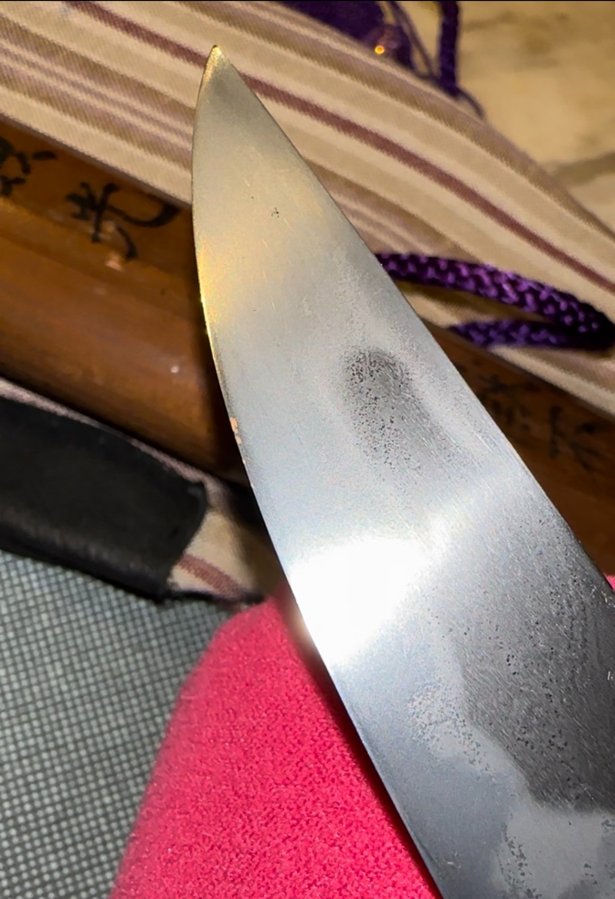

reinhard Posted February 3, 2023 Report Posted February 3, 2023 Okan, Telling from the bright color of the rust, the spots on the ha look pretty new. Removal should not be a problem. Try a tool like a spatula made of horn, soft enough to not scratch the steel. The cause for newly building rust eventually lies within the saya. Old shirasaya, depending on how they were used in the past, should eventually be cleaned. Now that would be a job for a professional. reinhard 2 Quote
Okan Posted February 7, 2023 Author Report Posted February 7, 2023 On 2/3/2023 at 12:16 AM, reinhard said: Okan, Telling from the bright color of the rust, the spots on the ha look pretty new. Removal should not be a problem. Try a tool like a spatula made of horn, soft enough to not scratch the steel. The cause for newly building rust eventually lies within the saya. Old shirasaya, depending on how they were used in the past, should eventually be cleaned. Now that would be a job for a professional. reinhard Expand Yes it's in a very old Shirasaya..Maybe it's time to replace it. Thank you Reinhard! Quote
WillFalstaff Posted February 9, 2023 Report Posted February 9, 2023 You could do the naïve obtuse thing (like me )and try to make your own shirasaya. Might take longer to get a custom new one made, compared to sourcing Honoki wood and getting the proper tools. I think some of the gents on here have repaired the shirasaya themselves, so that's another option. (Or you could mail the blade to me, seeing the disastrous rust spot has destroyed all the value of the tanto ) Quote
Chishiki Posted February 18, 2023 Report Posted February 18, 2023 On 2/1/2023 at 11:12 AM, Wim V said: Hi, Maybe try rubbing gently with a piece of bone or ivory? Expand Bad advice. Sorry, by rubbing it with bone or ivory you will just cause a larger blemish in the sword. Mark Quote
