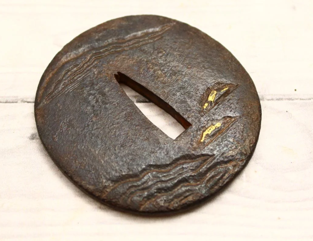

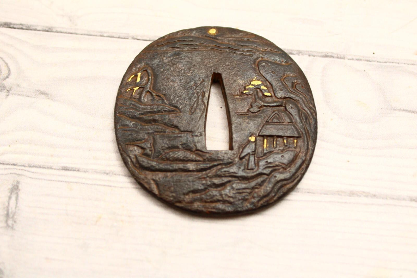

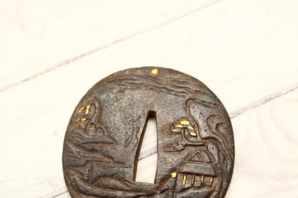

I am looking for an advice because I would like to avoid big disappointment from first purchase and also its not cheap buy. I really tried to figure out if that tsuba is genuine I browse through web and this forum to find information that can help me determine it.
From what I red Nakago on the the bottom should be horizontal and shouldn't be into V shape so that's good sign for me and cast tsuba should have some rim inside Kozuka and also I should have been able to see some bubbles on surface so I believe that this tsuba is genuine but I really want validate my opinion with experienced collectors.
If I misunderstand any of that advises  please correct me.
Seller provide that tsuba with this info:
PERIOD: Edo
DIMENSIONS: 70 mm x 67 mm x 4 mm
NAKAGO: 28 mm x 7 mm ( thickness 4 mm )
Any feedback is much appreciate. I hope this tsuba will be wonderful start of my collection.

Hi Jiri and welcome!
If I see correctly, your tsuba is signed Jakushi. You can Google Jakushi tsuba, to see how yours compare both for quality and price.
Jiří,
welcome to the NMB forum!
If you compare many TSUBA you can find in museums, books and online, you should be able to train your eyes until you feel comfortable for a purchase. Still much better would be the acquaintance with a friendly collector who lets you see and handle his TSUBA.
The depicted TSUBA is crude, the signature is probably wrong (JAKUSHI made much nicer TSUBA than this), and thus  it is not collectable in my opinion. TSUBA like this are usually sold for about € 50.-- .
Be patient with your purchases - there is a big worldwide market, so there is no need for a rush!
Have a look at the many TSUBA for sale here on NMB.
Hi Jiri,
Yes, but. As there are exceptions to every rule you aren't safe buying tsuba that conform to these rules. Not all cast tsuba have rim inside the ana, not all have bubbles, and there may even be a real tsuba or 2 with a v-shaped bottom of the nakago-ana. Do not rely on rules; rather, you need to study good tsuba, either in hand or in good pictures, to learn what you should buy.
The more you know before you buy the happier you'll be with what you buy. As Jean says above, there is no need to rush; there will always be good to great tsuba available.
The tsuba you picture is mediocre and hasn't been mounted (not a good sign on a mediocre iron tsuba); you can do much better. If you insist on buying before knowledge, you need to find a dealer you can trust.

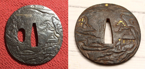

There is almost an identical copy of your tsuba here- https://www.jauce.com/auction/h1046216127
You will nearly always pay more for a well known name on a tsuba - even if the signature is not always correct or the tsuba is not very well made.
My advice is forget about any signatures and concentrate on what pleases you [ if it happens to be signed that may be a bonus but go with your heart first.]
No use having the name of some great maker on a piece you really don't like. As far as price goes, I know some members say save your money and only get the very best - but you won't know the very best straight away so don't spend a fortune on what other people consider you should buy. Ask opinions sure, but the choice should always be yours.
