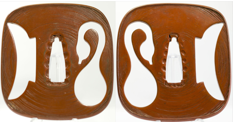

Spartancrest Posted January 30, 2023 Report Posted January 30, 2023 I think it is a Yamagane tsuba by Hirata Hikozo with an odawara fukurin and design of Namako (Sea Cucumber) This one for sale at PRICE: $48,500.00 https://nihonto.com/8-8-19-2/ different sukashi design but same maker or school. Way way way out of my pay grade! 1 1 Quote
Bugyotsuji Posted January 30, 2023 Report Posted January 30, 2023 Hirata Hikozō example, ex display piece from the Niigata Art Museum. 1 Quote

Franco Posted January 30, 2023 Report Posted January 30, 2023 59 minutes ago, Infinite_Wisdumb said: Pretty pricey at over 400,000 yen? Cheap, the question is why, what's the catch? https://nihonto.com/000045/ https://nihonto.com/8-8-19-2/ https://nihonto.com/11-05-19/ Regards, " In Buddhism, desire and ignorance lie at the root of suffering. By desire, Buddhists refer to craving pleasure, material goods, and immortality, all of which are wants that can never be satisfied. As a result, desiring them can only bring suffering." - PBS 1 1 Quote
DirkO Posted January 30, 2023 Report Posted January 30, 2023 According to the seller it's a direct Hikozo. However, no recent papers. Possibly they tried shinsa and it papered to Hirata or even Hirata den. And that makes all the difference... It's not because something was in a collection or a museum under a certain header, that it will pass shinsa as such. Quote
GRC Posted January 30, 2023 Report Posted January 30, 2023 flea market price for that one... could have/should have been much higher. It's special because it's Hirata Hikozo... THE GUY. Ground breaking innovator at a very special time in Japanese history. My question is why did the museum let this one go? 1 Quote

Steve Waszak Posted January 30, 2023 Report Posted January 30, 2023 The question, really, is whether this particular tsuba is Shodai Hikozo or Nidai Hikozo. I have my doubts that this is Shodai work, as the plate comes across as a bit too "tame" or lacking in the vitality that usually infuses Shodai workmanship. The plate here is relatively quiet. This doesn't mean it can't be from the hand of the Shodai, but in the end I suspect it is a Nidai tsuba. I suppose the "low" hammer price may be explained by its being seen as either a lower-end Shodai work or in fact that of the Nidai. Just as an aside, my personal view of Shodai Hirata Hikozo tsuba is that they are -- at their best -- the finest soft-metal sword guards ever made. That is a topic for a different thread, though... 5 2 Quote
rkg Posted January 30, 2023 Report Posted January 30, 2023 7 minutes ago, Infinite_Wisdumb said: so we agree its a legit piece and sold cheap? never seems to happen when im looking (and know what im looking for ) It depends on what you mean by legit. Its probably Higo/hirata work, but the big guy? Maybe, maybe not, which is why the piece is on YJ. It could be by the nidai, could be good later er, utushi, etc. I would guess the seller (0r the P.O.) submitted it to the NBTHK and it bounced or was given papers to somebody else (different generation or the group) or got the dreaded "den hikozo", as even Hozon papers would allow the piece (if legit/attributed to Hikozo with no 'den') to sell for several times the hammer price here. Every once in a while a rube actually does put something up w/o taking steps to maximize value (which is why I guess we all watch YJ), but that is not the case with this seller. They regularly run out some fairly high-grade items (I would posit if he thought it had a snowball's chance in hell of passing as a shoudai piece he would have bought it and had it papered himself even if he couldn't convince the client to do so). I would posit that is why the bidding stopped where it did - that's an OK price for a "den hikozo" piece, but you're taking the risk that its a nidai or a real good utushi, or... Best, rkg (Richard George) 7 Quote

Curran Posted January 30, 2023 Report Posted January 30, 2023 The one on Yahoo!Japan is not a Hikozo. Seppa dai is wrong. I didn't check the mimi, but it looks wrong too. The Den Hikozo is more interesting. I understand the reason for 'Den' on it. I like it, but don't love it. I won't be bidding. 1 Quote
GRC Posted January 30, 2023 Report Posted January 30, 2023 Hikozo works are an area that I'm just starting to sink my teeth into, and just admired them from afar. They always seemed equivalent to the other-worldly "unobtanium" So I humbly defer to Richard, Curran and Steve's analysis on this one , which seems to come to a consensus of: -at best Nidai -but could also be a later "den" -and could even be an "utsushi" made by someone not directly connected to the Higo school smiths I have to say though, if it is indeed an utsushi, it sure had me fooled! Which just goes to show why having only "a little knowledge" in a specific area is dangerous when it comes to high end works. I certainly wouldn't venture into this particular area (with money in hand) until I know a lot more. And I suppose that again affirms why high end pieces benefit so much from having some sort of "official validation" from shinsa.. regardless of how flawed it can be at times. A positive affirmation from papers will go a long way to convince someone (who isn't certain) to pay a higher value. It was a fun auction to watch, and learn from Quote

reinhard Posted February 1, 2023 Report Posted February 1, 2023 The tsuba in question was offered in 2004 at DaiTokenIchi by a Japanese dealer as "Hikozo"-tsuba without papers. Many knowledgeable people must have seen it in the meantime. Being still without papers and offered for a price far less than can be expected for a genuine (shodai) Hikozo leaves me with only one conclusion: There's something wrong with it. reinhard 5 Quote
