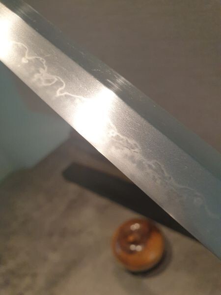

Hey @David Flynn, what leads you to believe this? This model has a mekugi and appears to be sharpened which indicates it has been tempered. It would not make sense, to me, to temper a blade only to etch a hamon over the natural hamon.
Definitely etched, these blades are through hardened in oil and the Hamon pattern is then etched like a normal parade sabre. There is no natural Hamon on these swords made using the Murata process. Best to do some reading on what a real Hamon looks like as you will often encounter such swords in Kyu Gunto mounts.
This was one stamped by Naohiro, a Taisho era smith who also made Gendai.
6 hours ago, Bridges said:
Well that’s unfortunate, although the pattern is still beautiful. By far my favorite hamon.

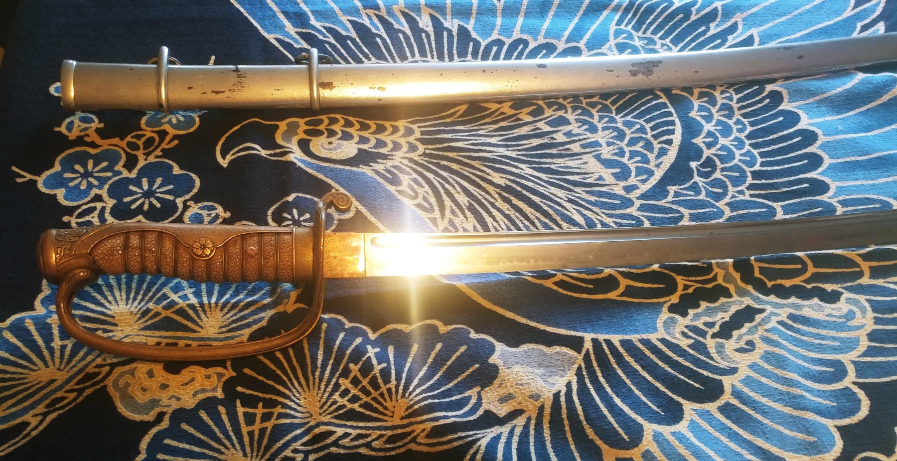

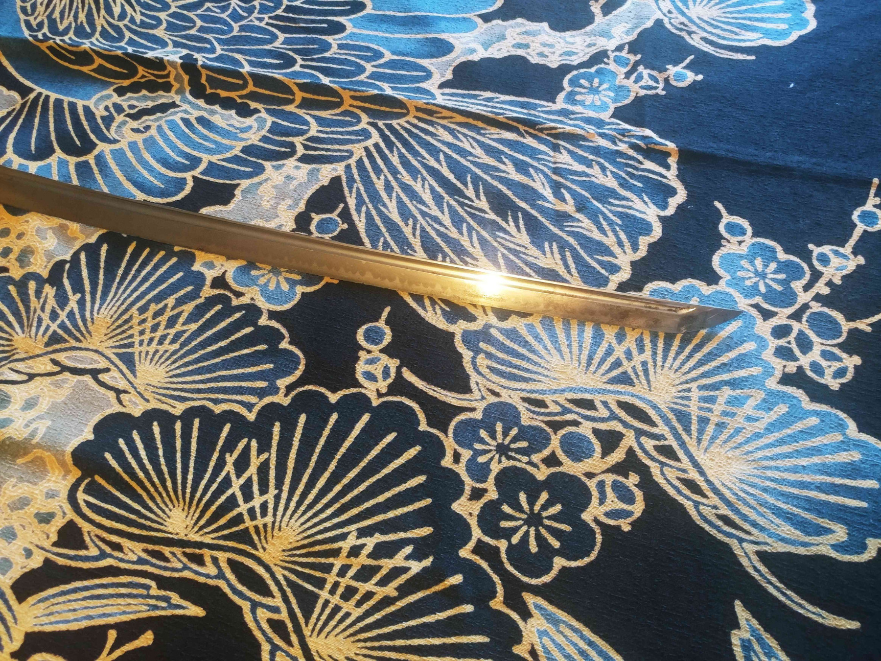

Bruce there is no hamon because it is full tempered.
The temper line is only there because the material is thiner on the cutting edge and cool down faster after quenching in oil.
