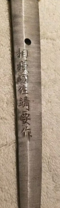

Bryce Posted January 31, 2023 Report Posted January 31, 2023 G'day Guys, I have to agree with Jean on this one. Compare below a nice, gendaito nakago from the same year as the subject blade. Craig can tell us if we are wrong. Cheers, Bryce Quote
NewB Posted January 31, 2023 Report Posted January 31, 2023 I'm sure you guys know more. My take comes from the photo attached. Same chisel outlines and aging inside the Kanji IMHO J. Quote
SteveM Posted February 1, 2023 Report Posted February 1, 2023 相模國住靖要作 Sagami-no-kuni jū Yasukane saku Quote
NewB Posted February 1, 2023 Report Posted February 1, 2023 30 minutes ago, SteveM said: 相模國住靖要作 Sagami-no-kuni jū Yasukane saku thank you @SteveM i must have brought a bit of confusion. I posted it just to compare the patina to the original post’s nakago always there to help, thank you again j. Quote

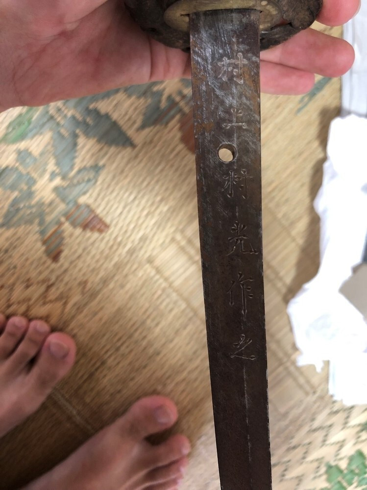

Kiipu Posted February 2, 2023 Report Posted February 2, 2023 村光 = Muramitsu. 皇紀二千六百年十月吉日 = A lucky day in October 1940. I found a sword marked as 村上村光作之 at the link below. https://detail.chiebukuro.yahoo.co.jp/qa/question_detail/q13212120033 I have reposted the picture below for convenience. Could it be one and the same as 村上村光 (銘 正忠)? https://ameblo.jp/busyuu/entry-12527031561.html @SteveM @mecox @BANGBANGSAN 1 Quote
