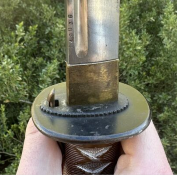

oristt Posted January 28, 2023 Author Report Posted January 28, 2023 On 1/28/2023 at 8:49 AM, vajo said: Its indeed a minefieled Can we give that to the Typ 95 Fake section. Is that fuchi iron or something else? Expand Chris, I can’t say as I haven’t had it in hand. I am looking to buy one and these are the sellers photos 1 Quote
WillFalstaff Posted January 29, 2023 Report Posted January 29, 2023 The bohi definitely gave me a bad scent. I’d side with the Polish determination. Quote

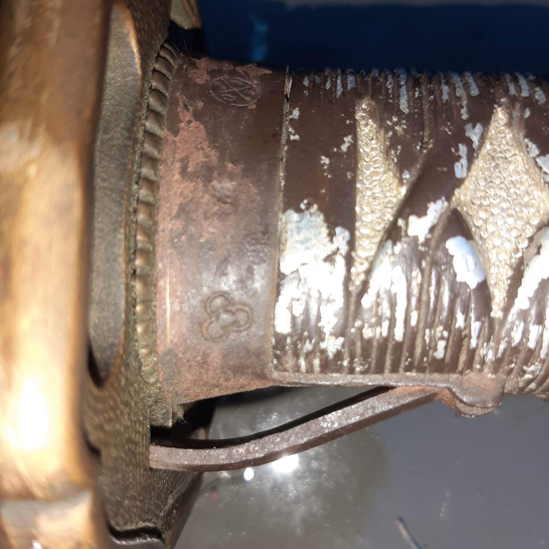

John C Posted January 29, 2023 Report Posted January 29, 2023 On 1/27/2023 at 2:28 PM, vajo said: The sword looks genuine now with the later pictures. Expand Chris: I have attached a pic of a real type 95 tsuba. Note the pattern of dimples match the shape of opening in nice rows. The OP pic seems to be much more random. What do you think? John C. 1 Quote
vajo Posted January 29, 2023 Report Posted January 29, 2023 You are right. Its fake. Like my first intention was that the sword is fake i changed it after your last picture and i was total wrong. Good picture from a nice Iijama sword. You see the Menuki positiv in sharp line. The nanako ist clear and sharp. The stamps are clear and sharp and every detail is seen on every part. All looks solid - not blury. And one point more. The cherry blossom leavs on the fuchi. I don't know why i have overseen that all. Beginning Dementia? 1 1 Quote
John C Posted January 29, 2023 Report Posted January 29, 2023 On 1/29/2023 at 8:01 AM, vajo said: I don't know why i have overseen that all. Expand Actually, Chris, I think your first instincts of the OP type 95 being fake were right on the money! But the dimple pattern does give us another detail to separate real from fake on these, since the fakes are getting better. John C. 1 Quote
