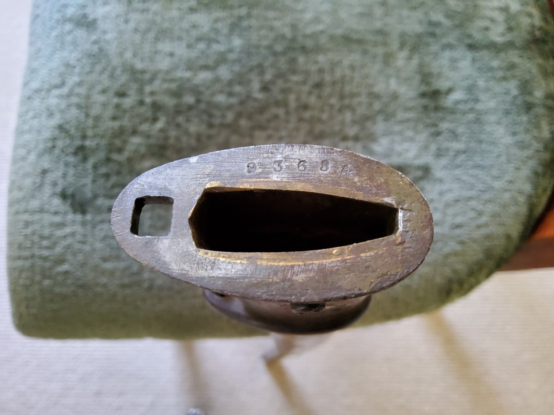

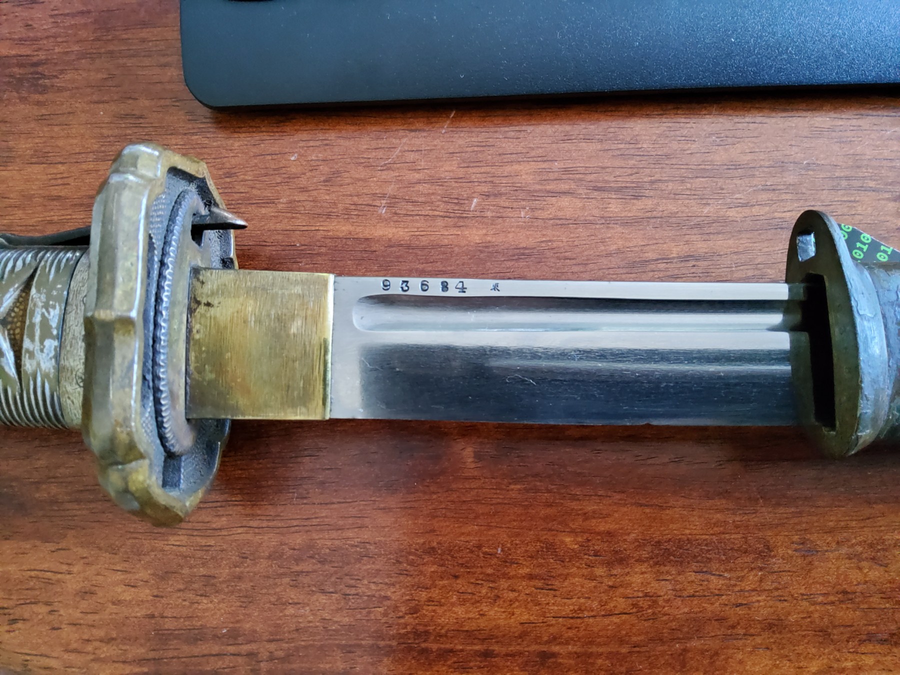

Bruce Pennington Posted January 27, 2023 Report Posted January 27, 2023 I see what you mean about the sides of the throat opening being flat. The dimensions of the bohi seem off. Photos aren't clear enough to see the detail of the bohi start and end, but they seem too imprecise for a Tokyo blade (more like what you would see on a Nagoya). Also, I'd request a clear shot of the stamps on the fuchi from the seller. Photo is too blurry to see them. Serial numbers are a bit far down the blade, and the "TO" stamp is poorly crafted. I have seen this style TO before, but added to all the other off details, it's a question. Better photos of bohi and stamps are needed from seller. Unless @Shamsy or @Stegel can quickly settle the matter. 1 Quote

vajo Posted January 27, 2023 Report Posted January 27, 2023 Kyle the stamps on the fuchi looks good for me. Hmm, The clipper looks correct too on the picture. Its made from forged Iron. I think now the sword is genuine. Sorry for confusing you. But good pictures are allways needed. The nanako looks not inverse now on the last picture you share. 1 Quote

Bruce Pennington Posted January 27, 2023 Report Posted January 27, 2023 Agree with Chris, stamps are good. I was also thinking “why would a fake have old cosmoline?” Good photos make all the difference. 1 1 Quote

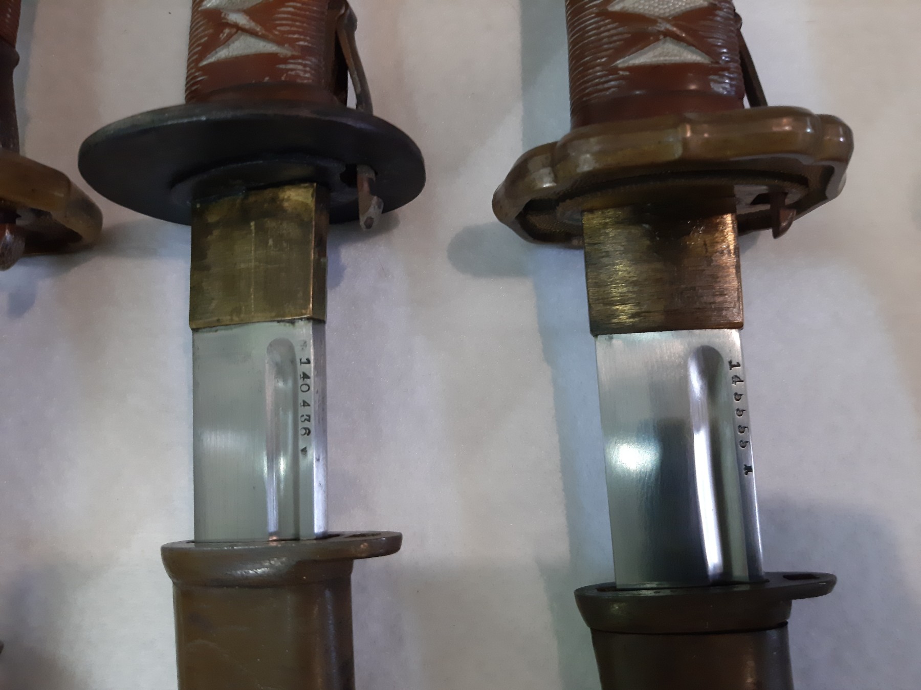

Shamsy Posted January 27, 2023 Report Posted January 27, 2023 Does the scabbard paint look too fresh? Either it's remarkably well preserved or it could be repainted. Or more likely it the photo. The bohi and kissaki looked bad, but if you look at sword 4 and 3 respectively below, these also have the shallow scoop bohi and poorly defined kissaki. Nothing else is amiss, so as usual,judging the sword as a whole, genuine. 1 1 Quote

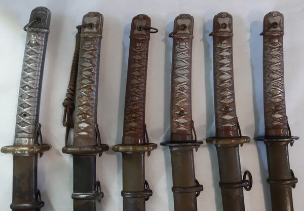

Kiipu Posted January 27, 2023 Report Posted January 27, 2023 This is a very good reproduction that has fooled many. A Polish collector was the first one to ask questions about them and ever since they have been called the Polish fakes. (However, it is not known if they are indeed made there). The serial number font is incorrect and it is in a Suya serial number range. It is not unusual to see these swords aged and additional artifacts placed with them to fool collectors. For the record, I had about seven of these listed as real so they fooled me too. Fake Type 95 Nco Swords, Page 8 1 1 Quote
Shamsy Posted January 27, 2023 Report Posted January 27, 2023 Actually, it was me that first introduced the phrase 'Polish sword'. It came about when I found these swords, far better than the Indian made ones, for sale from Poland. They were not aged but new condition and listed as such, so they were reproduction and not intended to fool. But later, they started appearing with artificial aging and so entered the 'fake' arena. I called them Polish as this was the first place I found them. 2 Quote
oristt Posted January 27, 2023 Author Report Posted January 27, 2023 On 1/27/2023 at 10:40 PM, Shamsy said: Actually, it was me that termed the phrase Polish sword. It came about when I found these swords, far better than the Indian made ones, for sale from Poland. They were not aged but new condition and listed as such, so they were reproduction and not intended to fool. But later, they started appearing with artificial aging and so entered the 'fake' arena. I called them Polish as this was the first place I found them. Expand Steve, you feel this is one of the polish swords? Quote

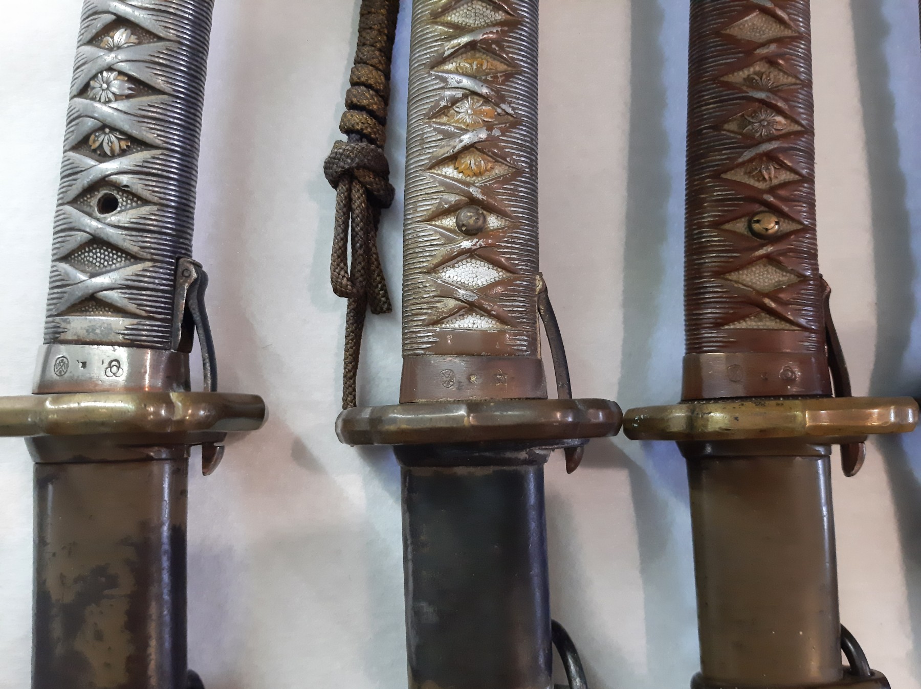

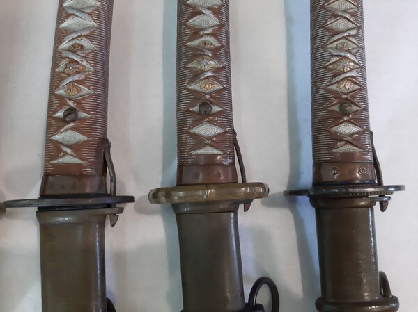

Shamsy Posted January 27, 2023 Report Posted January 27, 2023 Possibly. I'm looking at the stamps... the key thing with the Polish swords are the paint colours (I'm colour blind, but I'd call it a 'darker' shade of green which usually just pops out), the flatter, chiselled looking habaki markings spread a little further apart and the crappy bohi and serial numbers. Crappy bohi and serial check, check. Colour wise... maybe on the handle. I thought the saya was painted and not the darker green, so I thought that a good indication, but Stegel pointed out that it's not paint but rust, so that's a maybe. The habaki stamps... I'm not sure. They are further apart than usual... not sure about the quality. The habaki has pretty thick patina... On the plus side, it doesn't have that obnoxiously over bent retention latch common to Polish. The thing with the Polish swords are that they are very good reproductions. It really is hard to pick them, especially when they are well aged. Each sword must be judged as a whole. There are too many variations in quality and detail of the real things. That unfortunately starts to make it hard and the fact Iijima is the worst for quality and manufacture differences doesn't help. 1 Quote

Shamsy Posted January 27, 2023 Report Posted January 27, 2023 I had a look at my Iijima to compare. The more I look at it, the closer it appears to be the Polish sword made into a fake... 3 1 Quote
Shamsy Posted January 27, 2023 Report Posted January 27, 2023 On 1/27/2023 at 11:06 PM, Kiipu said: I thought I would post the links to the initial appearance of these Iijima's. NMB 2017-01-17: Nco Shin Gunto - Real Or Rotter? WRF 2017-07-02: WRF Is it replica 95 NCO Sword shin gunto? Expand Try this one. I believe this is the original thread that spawned the 'Polish' Swords term on NMB. I checked the other two. The WRF forum links to an Indian sword as the source. I later add "I was very careful when i bought my Iijima with Tokyo stamp and Iijima with Kokura stamp. Poland have been producing high quality replica IIjima 95's for a few years now." So I obviously found out about these earlier than 2017. I'm particularly happy to see that the WRF sword in question was from a collector in Poland. That supports my initial observations about these swords origins. 1 3 Quote
Kiipu Posted January 27, 2023 Report Posted January 27, 2023 My all time favorite Iijima reproduction has to be this one! How about that box. WWII M95 NCO Sword Opinions Comments Wanted 1 2 1 Quote
oristt Posted January 27, 2023 Author Report Posted January 27, 2023 Grate line up you have there steve 🤩 The reason why I asked on the sword was the mouth of the scabbard had straight sides and the menuki details are debossed were yours all embossed am I correct about this? 3 Quote

Shamsy Posted January 28, 2023 Report Posted January 28, 2023 On 1/27/2023 at 11:45 PM, oristt said: the menuki details are debossed were yours all embossed am I correct about this? Expand You're right about that and great eye for detail. 1 Quote
