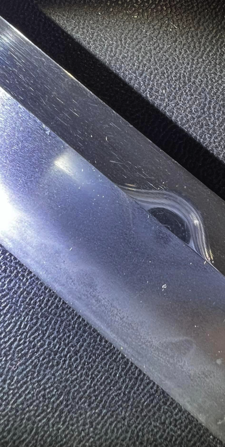

vajo Posted January 25, 2023 Report Posted January 25, 2023 Ara-nie on a mantetsu blade. Very nice. (source: facebook) 1 Quote

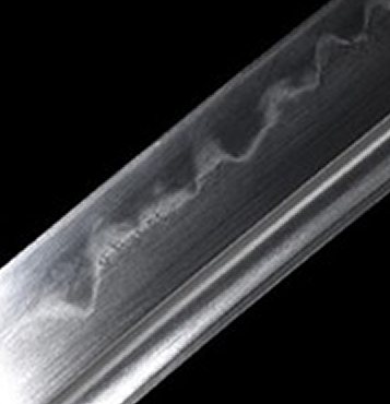

BANGBANGSAN Posted January 25, 2023 Report Posted January 25, 2023 @vajo Chris Ohmura said:例外的に乱刃が存在する。恐らく特注品であろう. There are some wavy hamon blades existing. Probably the special order item. http://ohmura-study.net/222.html Me and Neil both had a mantetsu blade with wavy hamon. 1 1 Quote
vajo Posted January 25, 2023 Author Report Posted January 25, 2023 Trystan did you sie ara-nie (martensit crystals) in the hamon in yours? Quote
Volker62 Posted January 25, 2023 Report Posted January 25, 2023 ops... very rare, thanks for sharing! 2 Quote
Bruce Pennington Posted January 25, 2023 Report Posted January 25, 2023 Thanks for posting that Chris! I only had 3 (now 4) in the "MI" line of blades. Two are Ren stamped and two are Koa Isshin. Nice to see that one. What would you say, still oil quenched? or water? Quote
John C Posted January 25, 2023 Report Posted January 25, 2023 On 1/25/2023 at 2:59 PM, vajo said: Ara-nie on a mantetsu blade Expand Chris: I know ara-nie is sometimes done intentionally, however could this also mean the blade was too hot when quenched? John C. Quote
vajo Posted January 26, 2023 Author Report Posted January 26, 2023 Ara nie is a sign of tamahagene, hardned in water. On koto blades some said it is a sign of uncontrolled heat und a ugly thing that indicates lower quality and value. Ara nie on Gendaito is often seen and a proof of nihonto. I found ara nie most attractive. But i dont know why it is on a mantetsu blade? Martensit isn't build in oil and not on industrial steel. 1 Quote
Bruce Pennington Posted January 26, 2023 Report Posted January 26, 2023 On 1/26/2023 at 7:37 AM, vajo said: Ara nie is a sign of tamahagene, hardned in water. Expand Dang!!! So, we are possibly seeing a custom order Mantetsu made with tamahagane - fully traditional, gendaito? Quote

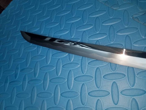

vajo Posted January 26, 2023 Author Report Posted January 26, 2023 I dont know Bruce. Thats why i ask Trystan if he had ara-nie seen on his mantetsu. Btw it doesn't matter which kind of hamon. Martensit only grows in high carbon steel. I was thinking that ara-nie needs water quenched. But i found a picture of a chinese T-10 (selfmade Tamahagene) which has ara-nie too. And this sword is not hardned in water. But i think that mantetsu from facebook was water hardned. Yes i think it was traditional made. (T-10 chinese replica with ara-nie) Quote
BANGBANGSAN Posted January 26, 2023 Report Posted January 26, 2023 @vajo Here is some old photos of my wavy hamon Mantetsu,it's currently at my friend's place. Quote
vajo Posted January 27, 2023 Author Report Posted January 27, 2023 Thanks Trystan but the kind of hamon (notatre, gunome, suguba or something else) isn't the question. I can't see any signs of ara-nie in the pictures. Quote
