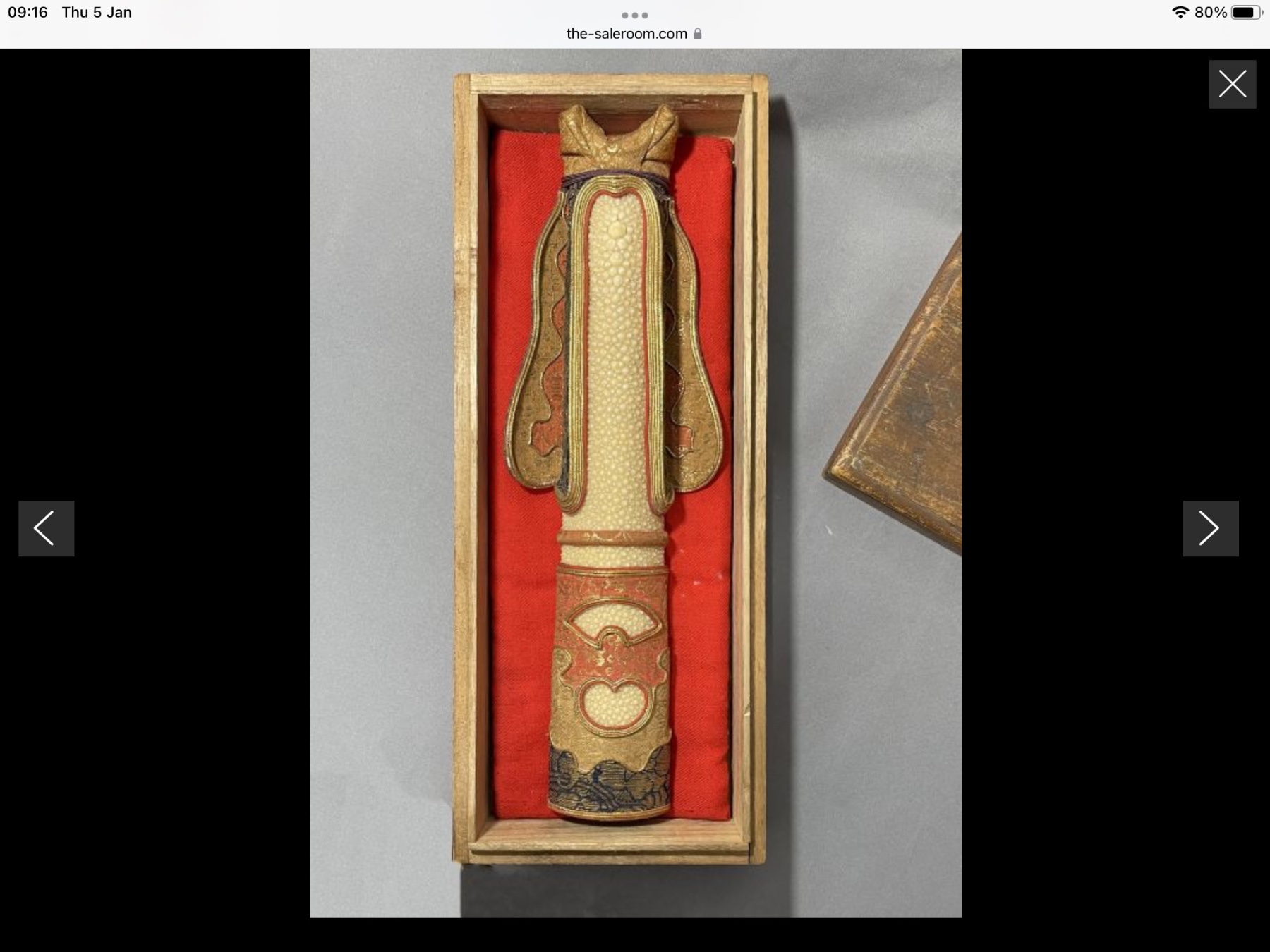

Matsunoki Posted January 26, 2023 Report Posted January 26, 2023 I think (might be wrong!) that there is only one “Emperor node” on same ie the one that is obviously the largest. Leading up to that large node is usually a series of graduated nodes in a straight line. See the image below of very fine same packaged for presentation. Emperor nodes are often “faked” by inserting carved ivory pieces into poorer quality same to make it more impressive. In the original image posted it is difficult to actually see what the pattern is due to the Ito. I don’t think they are all “Emperor nodes”……but there might be one hidden. All the best.Colin 2 1 Quote
John C Posted January 26, 2023 Author Report Posted January 26, 2023 7 hours ago, Matsunoki said: there is only one “Emperor node” on same Colin: I think you are right. These look more like blobs than a well defined node I have seen on samples posted here. A tumor perhaps? Probably celluloid made to look like nodes. John C. Quote
