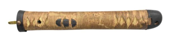

Has anyone cleaned their tsuka?
Hello:
I have a tsuka with old mud and dirt on it. While I know cleaning is generally frowned upon, I don't see the need to preserve the mud. I was wondering if anyone has cleaned their tsuka or ito wrap and if so, how? What are the best methods? I believe the ito wrap used to be white.
Thank you,
John C.
John, just a word of caution as Barry says you don’t want to damage the Ito.
It is very easy to damage old Ito. Over time it deteriorates naturally and a toothbrush, even a soft one could probably cause fraying. The “mud” on yours does look a bit like ingrained grease from handling over the many years and if it is then that is really tough to shift. The areas where the Ito is twisted or in the knot high points are especially vulnerable.It’s so easy to end up wishing you’d never started…..
speaking from experience!
All the best. Colin
