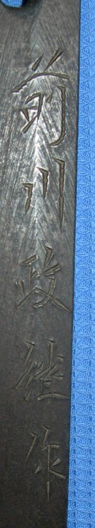

Please do not tell me what the name is if I got wrong. I am trying to learn to read mei. This is maybe not even the right sort of sword for this forum, in which case forgive me. It has a showa stamp on it. Yes, it is in military mounts.
I think it says Tsu shu (Tsushima) Toshi Muni Saku
Helpful, "you got the 3rd (or whatever) character wrong" comments are welcome though.
Cheers
Mark

OK, my final attempt unless I get at least 2 characters right
Gio or Yoki Gawa Masa Michi Saku
Please, if I do not have at least 2 right (if so, please tell me which ones are right), put me out of my misery and tell me what the mei actually is, please :cry:

Hi,
OK, Seki Shu Toshi Mune Saku
You recognize only “saku” kanji correctly.
"Shu" is correct too :D

OOPS, i need to open my eyes this morning i confused shu 州 with kawa 川 :oops:
Hi,
Greatly improved!
1. NG.
2. seems to be correctly deciphered, but usually reads “kawa” in this case.
3. Masa - correct
4. NG.
5. saku - correct

Please, if I do not get it this time, please put me out my misery and tell me the full mei. I do not think he is such a worthy sword-smith to cause me such eye and head ache; the steel looks western and the hamon too regular (undulating).
Kiku Kawa Masa Nori OR Yoshi Saku

I think that the mei is
前川政継作 – Maekawa Masatsugu saku.
The first kanji might be a little tricky.
BTW, I also make mistakes sometimes.
Hi Koichi
Thank you very much :thanks: . I can see now the first character, the one you have doubts about. But it is actually the 4th character, the one you say is "tsugu", I have problems reconciling. Please do not get me wrong, :bowdown: I do not doubt what you say, it is just as long as I stare at the character on my tang and the one for tsugu, I just do not see it :dunno:
So thank you, I would never have got it.
Mark
Kanji in signatures can differ strongly from textbook examples. That's something you will encounter quite frequently. It's the same with our personal handwritings. Most of it cannot be deciphered by somebody, who is not familiar with Roman letters and our language in general. - After seeing and understanding many mei, you will get a feel for it.

A big chunk of trouble in learning is that text books and online Kanji charts are print and the signatures on swords are handwriting; they often don't look alike.

Think of it like a doctors handwriting. Most of us can't read it easily, but a pharmacist easily makes it out. It is still English, and legible, but you won't recognise many of the characters. Such is written kanji.
