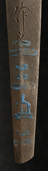

John C Posted January 13, 2023 Report Posted January 13, 2023 Hello everyone: I have some questions about this Kanehide gendaito you all might be able to answer. 1. Do you think the mounts are original to the blade? I ask because there is no makugi-ana near the bottom of the nakago. 2. Why would there be two sets of painted assembly numbers? Is that related to possible changing the koshirae? 3. The blade is star stamped with two small seki stamps (one in the date and one on the mune). The stamps are correct, however, seki and not NA stamp? Is that common? Thank you, John C. Quote

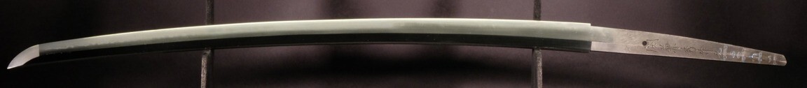

John C Posted January 13, 2023 Author Report Posted January 13, 2023 More pics of the blade... taken from the auction site. I could not capture any good shots. John C. Quote

francois2605 Posted January 13, 2023 Report Posted January 13, 2023 3 of the pictures shown in this thread come from this Yakiba's page: https://yakiba.com/kanehide-nakata/. If you look at the Yakiba's sword description, you'll see that the sword comes with a shirasaya, not a koshirae. I'm a bit confused. Are those 6 pictures from the same sword ? I'd say no. Even the paint on the nakago is different: 1 1 Quote

Bruce Pennington Posted January 13, 2023 Report Posted January 13, 2023 The yakiba blade and the one John posted are two different blades, both dated 1944. I have them both on file. The use of the small Na stamp was dominant in 1943, but was tapering off in '44 and a few are seen. The small Seki became dominant in 1944/45, with a few seen in '43. So there was overlap in '44 of both stamps. John, I have seen several blades with double painted numbers, some of them, like this, with double ana. To me, this speaks to the idea the blade was re-mounted at some point, but we can only speculate. Yakiba blade: Even the yakiba blade was double numbered: I don't have close shots of the blade John posted. 2 Quote

John C Posted January 13, 2023 Author Report Posted January 13, 2023 7 hours ago, francois2605 said: 3 of the pictures shown in this thread come from this Yakiba's page Francois: You are correct! After looking at the sword in detail, the seller used pictures of the actual sword and "augmented" the listing with pictures of the Yakiba sword! Attached are pics of my sword in hand. Everyone please comment on this sword. My feeling is the sword and mei are correct, however what the seller did bothers me. John C. 1 Quote

Kiipu Posted January 13, 2023 Report Posted January 13, 2023 15 hours ago, John C said: 2. Why would there be two sets of painted assembly numbers? Is that related to possible changing the koshirae? Star stamped swords from Gifu Prefecture usually have two sets of painted numbers on them. As far as I can tell, one is the Nagoya Arsenal production number and the other is the koshirae subassembly number? Regardless of one's personal opinion, there does seem to be a pattern to these painted Nagoya RJT blades. The colors noted so far are red, green, and blue. 2 Quote
John C Posted January 14, 2023 Author Report Posted January 14, 2023 5 hours ago, Kiipu said: The colors noted so far are red, green, and blue. Thank you Thomas. Mine uses the green and blue paint. In addition, the blue is written using the letter A with Japanese numbers on the mei side and Arabic numerals on the date side. Malcom Cox has a Kanehide with the same style of blue numbering. So I guess the numbering is valid, at least. John C. Quote
John C Posted January 14, 2023 Author Report Posted January 14, 2023 9 hours ago, Bruce Pennington said: To me, this speaks to the idea the blade was re-mounted Bruce: I concur. The blade does not have the second mekugi-ana near the base of the nakago, as would be typical with Rinji mounts. In addition, the scabbard is black lacquered wood and the tsuka has only one chuso button. And oddly, the ito was white (now filthy with dirt and mud) and not lacquered. So would it have originally been a type 98 mounting? John C. Quote

Kiipu Posted January 14, 2023 Report Posted January 14, 2023 18 hours ago, John C said: The blade does not have the second mekugi-ana near the base of the nakago, as would be typical with Rinji mounts. The shinobi ana 忍び孔 was frequently added by the fitting shop and not by the swordsmith. It is not unusual to see Type 100 blades with only the mekugi ana 目釘穴. There was a Type 100 which had a shinobi ana drilled right through the Tōkyō 1st Arsenal serial number. This would imply that the serial number was stamped before the hole was drilled. There are no hard and fast rules when it comes to Japanese military swords. Shinobi Ana 忍び孔 2 Quote

John C Posted January 14, 2023 Author Report Posted January 14, 2023 Thomas, Bruno, and Chris: Thank you all for the info. I thought it was interesting that the English letter A was used along with Japanese 930 on the mei side and Arabic 930 on the date side. Could they have been using parts (or their bins) from Western manufacturers? John C. Quote
