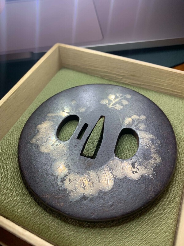

Okan Posted January 4, 2023 Report Posted January 4, 2023 Hey guys, Quick question. I'm not sure if the overlay material is sahari or silver but there is little rust going on here. Do you think some choji would hurt the 3-6-4 kiri mon? (want to remind you it's not inlay) Thank you!! @Spartancrest I already know your answer but I'm not gonna do it no spitting 1 1 Quote
ROKUJURO Posted January 4, 2023 Report Posted January 4, 2023 Okan, It doesn't look like SAHARI on this photo, but even if it were silver I would not expect problems with a little oil. Another question is, if oil could really stop corrosion. My take would be to remove the rust first (with pointed antler pieces - in case you don't have them, I can send you some) and then prevent new rust forming with oil. Otherewise an interesting TSUBA! 1 Quote
Okan Posted January 4, 2023 Author Report Posted January 4, 2023 Dear Jean, It probably wouldn't stop corrosion but would give a nice black look for a day or two. I can try antler pieces but I'm afraid I don't have any so I would very much appreciate some. Quote
