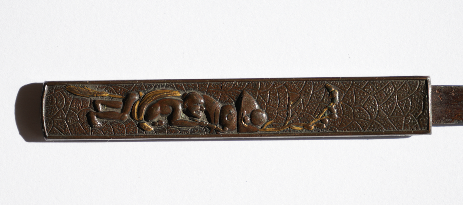

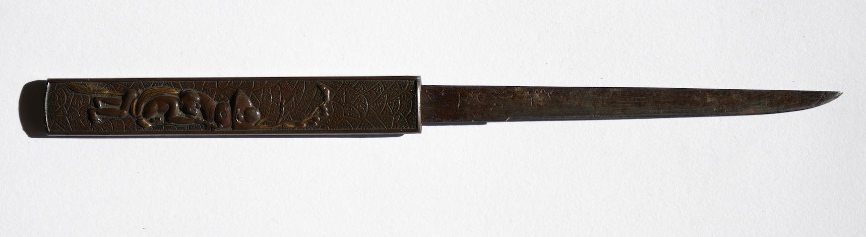

Antonis Posted January 3, 2023 Report Posted January 3, 2023 hello everyone, I was hoping I could get some help in identifying how old this kozuka is and help translating the signature/text present on its blade. I'm also interested in finding out whether the depiction on it has a deeper cultural significance or if they relate to a certain Japanese myth or story. The kozuka in question still has its blade which is chiselled with what I believe is a signature. The kozuka itself is made of a copper alloy with gold gilding at parts that have sadly worn off a bit. The depiction in it is that of a bald man holding a Tobacco pouch and smoking a pipe. Behind him, a broom can be seen. The man is looking up at a stone lantern on which a snail is on its top. Behind, a branch can be seen. -19.7x1.4x0.4cm (including blade) Thanks in advance, Antonis Quote

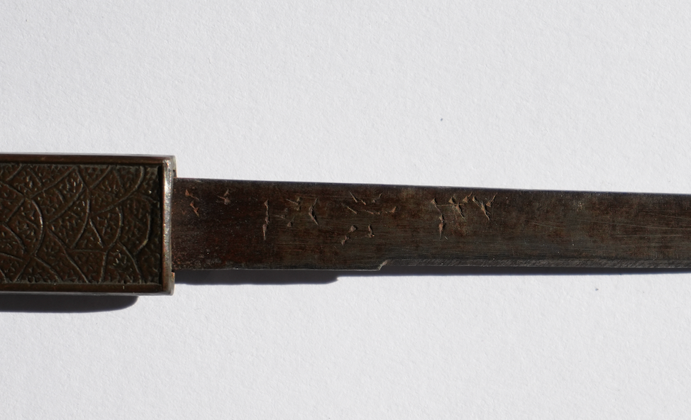

Antonis Posted January 3, 2023 Author Report Posted January 3, 2023 Here's a close-up of the inscription: Quote
Matsunoki Posted January 3, 2023 Report Posted January 3, 2023 Antonis hello again. Have you tried a magnet on this kozuka? From the images it does not look like a typical iron example. Test it without the blade in (assuming the blade slides out easily) 1 Quote
Antonis Posted January 3, 2023 Author Report Posted January 3, 2023 On 1/3/2023 at 3:44 PM, Matsunoki said: Antonis hello again. Have you tried a magnet on this kozuka? From the images it does not look like a typical iron example. Test it without the blade in (assuming the blade slides out easily) Expand I just tested it out. The magnet does not stick on the Kozuka but does on the blade. So it is not made of iron but rather a copper alloy. Quote
Matsunoki Posted January 3, 2023 Report Posted January 3, 2023 On 1/3/2023 at 4:33 PM, Antonis said: The magnet does not stick on the Kozuka but does on the blade. Expand Sorry to say……I think you have another cheap pressing rather than a traditional kozuka. The blade however looks OK ie genuine. Quote
Franco Posted January 3, 2023 Report Posted January 3, 2023 Hello, Kozuka, not traditionally made. Probably Meiji period made for export. Ko gatana's chippy mei also suggests a production piece. Regards, Quote

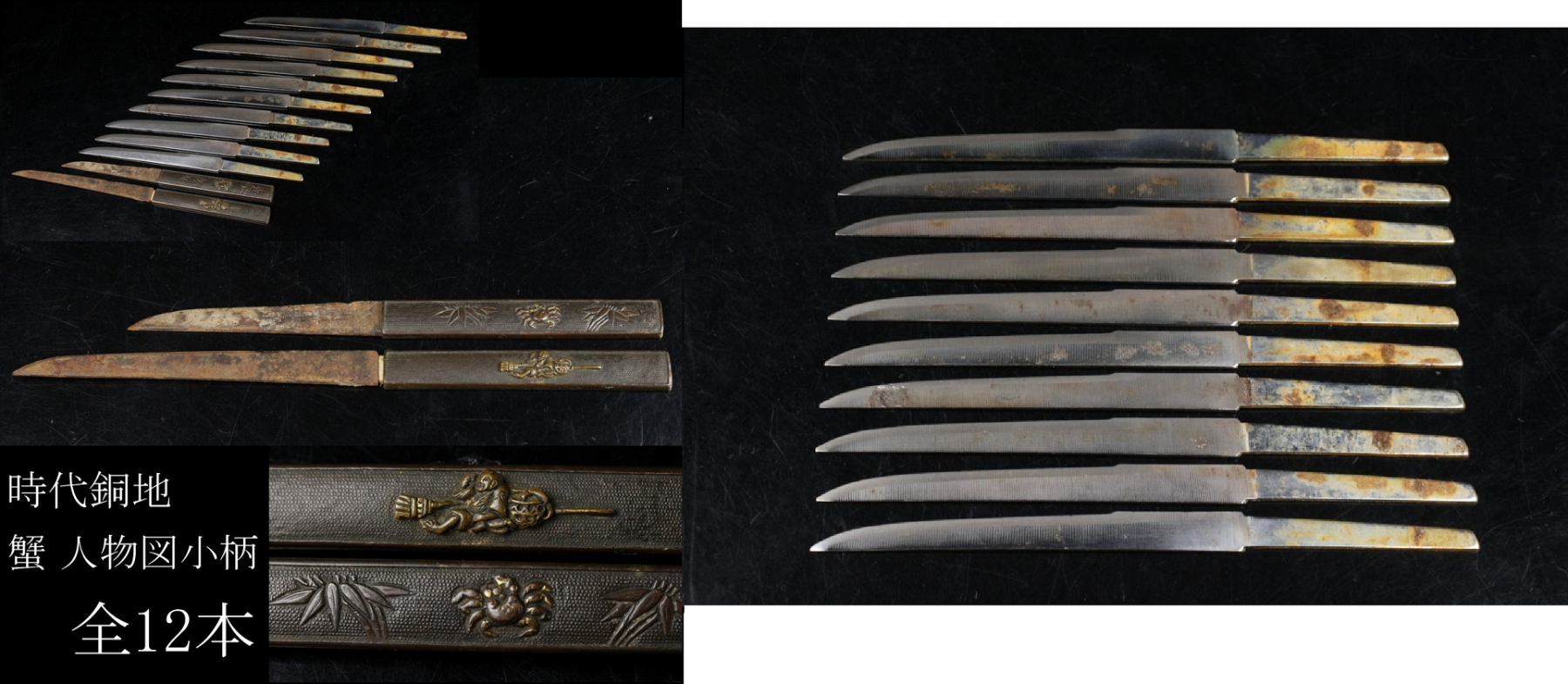

Spartancrest Posted January 3, 2023 Report Posted January 3, 2023 Anyone in the market for replacement Kozuka blades? With two handles, also possible Meiji or later. Reproduction at least [possibly 'retro", more than 25 years old, from their condition?] https://www.jauce.com/auction/r1077425737 Bulk buys are a real giveaway they are not genuine, but something to fill your handles with! Quote
