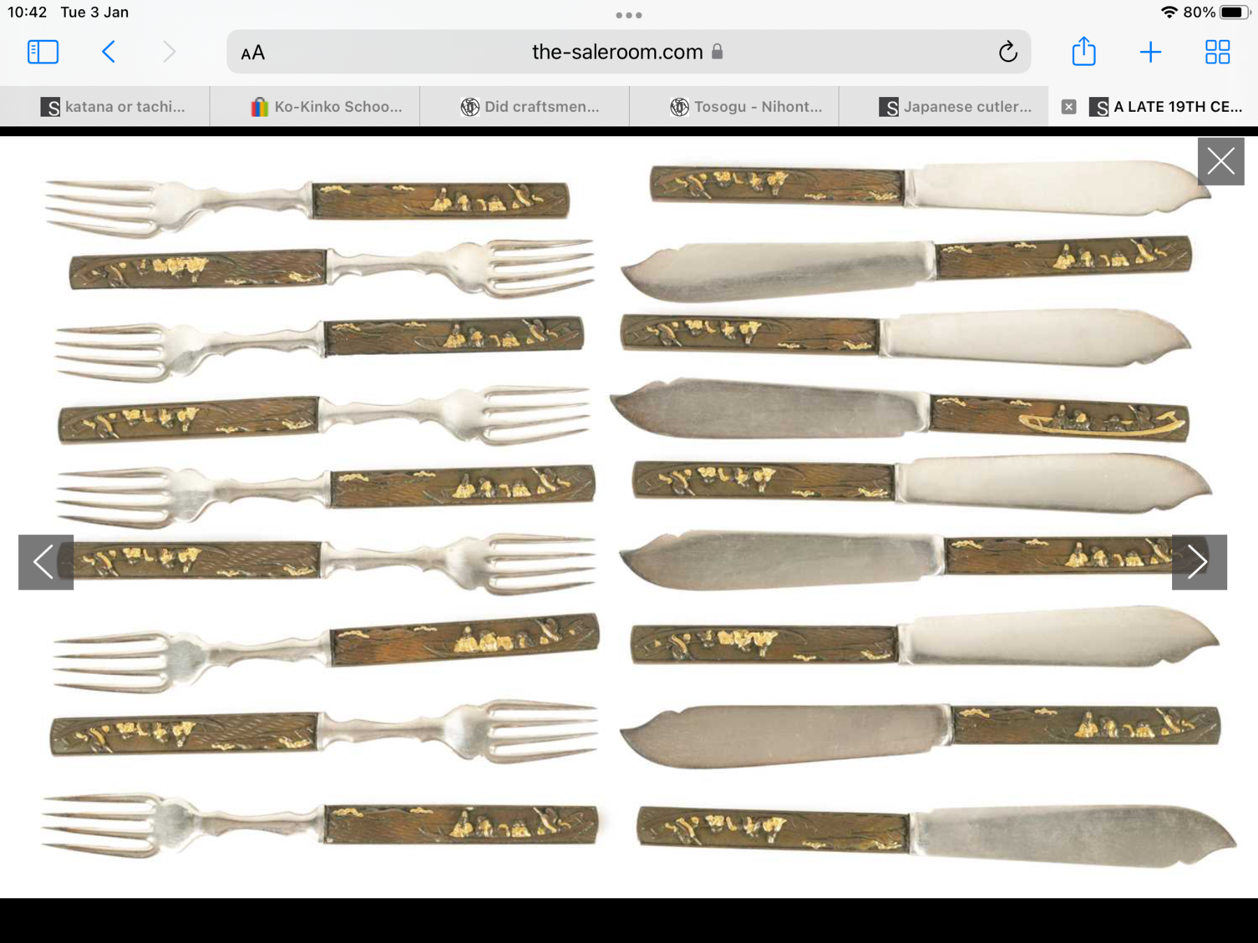

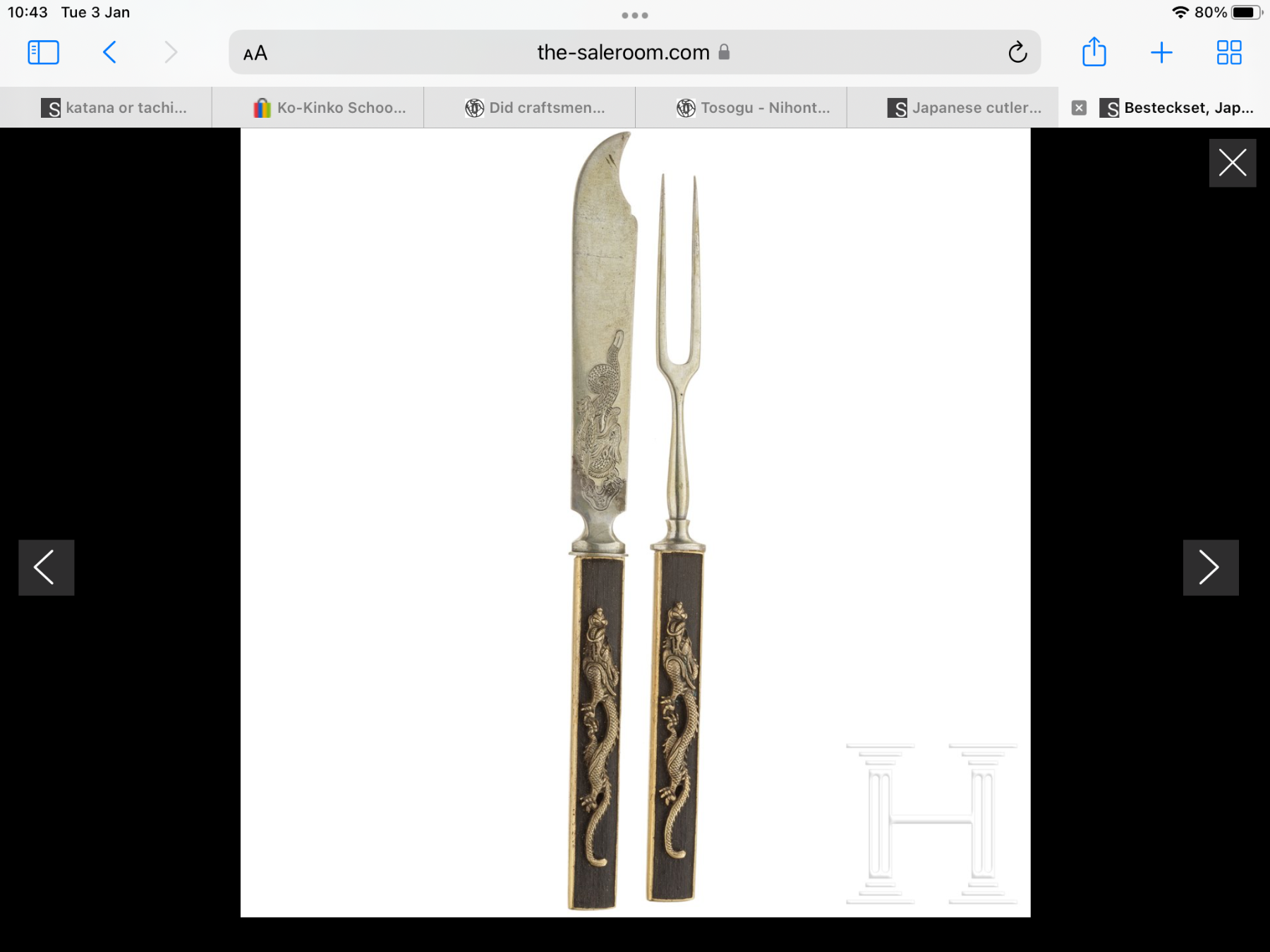

Many “kozuka” were made cheaply and non traditionally in the Meiji period for sale to foreigners. They are often found as handles on cutlery sets intended for Western consumption. It is very common to find exactly the same design used more than once within the same boxed set of knives, forks etc.
The method of production is to use a solid substantial back plate with the front plate simply being a pressing stamped from a thinner sheet of various metals. The design can be convincingly mulitpatinated and gilded to give the impression of a traditionally made item. I believe they are called “shiremono”….but I may have spelt it wrongly.
Of course as multiples are pressed from the same mould they are exactly the same.
The “kozuka” in question here does look like such a pressing and a quick glance suggests it is exactly the same as the one for sale looking at the background pattern especially.
Just an opinion …….but hook your fingernail into the blade aperture and see if the front edge of the top plate has a lip on it where it has been rolled over to give the appearance of a thicker plate of metal.

Here are a couple of examples of the “fake” pressed kozuka that I refer to. I am sorry to say I believe yours is one such piece….but I do understand your question….you simply wish to learn and I wish you all the best.
