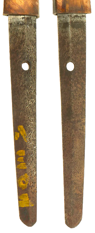

brainlet Posted January 2, 2023 Report Posted January 2, 2023 I recently received a sword from my father who received it form my Grand uncle before he died. It is a Kai Gunto. It isn't stainless steel because it rusts, and I have a signature. However I don't exactly know what kind of steel it is made out of. Would it be possible to find out what kind of steel it uses . 1 Quote
Brian Posted January 2, 2023 Report Posted January 2, 2023 Seki stamped Showato. So a regular arsenal made sword during WW2. Made from the typical steel used at that time, crafted and then oil quenched. Quote
Beater Posted January 2, 2023 Report Posted January 2, 2023 In case you are unaware, your sword is signed: “Noshu ju Tsukahara Kanetsugu kin saku”. (Respectfully made by Tsukahara Kanetsugu, living in Noshu province.) Another similar oshigata can be found on page 95 of “Swordsmiths of Japan 1926-1945”, by R. Fuller & R. Gregory. 4 1 Quote
Bruce Pennington Posted January 2, 2023 Report Posted January 2, 2023 We'd enjoy seeing shots of the whole sword and fittings Karl, if you'd honor us with some photos! A couple of close, clear shots of the temper line (hamon) would help also. The blades with the large Seki stamp, like yours, are probably not made in the traditional manner. There have been some rare exceptions, but the vast majority of them seem to be well made, non-traditional blades. So, if a smith was cranking out large numbers of blades for the war effort, using non-traditional methods, it's unlikely (not impossible) that he was using tamahagane. But we're talking odds and chances here, since it's not possible to know conclusively. There are some guys at NMB that are really into metallurgy and steels that may be able to comment, but if the smith didn't specifically say on the mei (signature line), then we don't really know what steel was used. Quote
vajo Posted January 2, 2023 Report Posted January 2, 2023 Smith's real name was 塚原 次郎 (Tsukahara Jirou) 濃 州 住 塚 原 兼 次 謹 作 Noshu ju Tsukahara Kanetsugu kin saku Noshu is another name for the old Mino Province. He was also listed as RJT Swordsmith (Nihonto Meikan, Tosho Zenshu) He got the 4th seat/ Gifu (Slough) Province Gifu was created from the provinces Hida (northern part) and Mino (southern part). 1 Quote
John C Posted January 2, 2023 Report Posted January 2, 2023 Karl: FYI The yellow painted numbers (2477 I think) are assembly numbers. Do the other parts have this number stamped on them? John C. Quote

Kiipu Posted January 2, 2023 Report Posted January 2, 2023 3 hours ago, John C said: The yellow painted numbers (2477 I think) are assembly numbers. I think this is 七四七七 as the initial character has an upward swing in the upper left corner. Compare it to the bottom character. What do you think? 七四七七 = 7477. Quote
John C Posted January 2, 2023 Report Posted January 2, 2023 16 minutes ago, Kiipu said: I think this is 七四七七 You are most likely correct. It's hard for me to tell sometimes. John C. Quote
Kiipu Posted January 2, 2023 Report Posted January 2, 2023 Sometimes you are not alone. I initially thought it was a 〇 (zero)! Quote

brainlet Posted January 3, 2023 Author Report Posted January 3, 2023 5 hours ago, John C said: Karl: FYI The yellow painted numbers (2477 I think) are assembly numbers. Do the other parts have this number stamped on them? John C. I have Different numbers 0 3 1 or 1 3 0 stamped on them Quote
