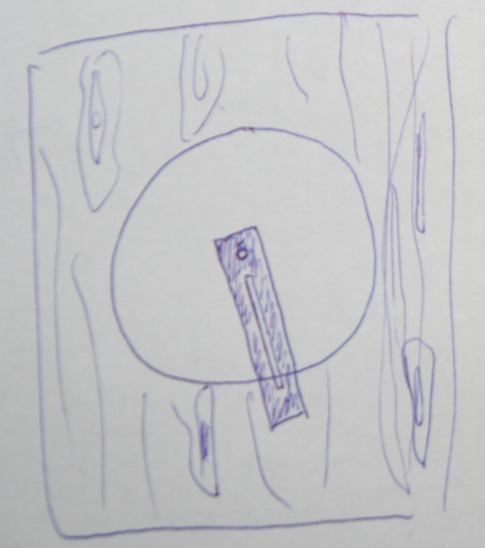

Hello Gentlemen,
I haven't tried it yet, but if I would have to make this kind of delicate yasuri I would use a hand-driven cutter like goldsmiths do. See picture for a few of these, of course the widths and cutting profiles vary endlessly. The mushroom handle lies in the palm of the hand for power, fingertip on the cutter point for control. The handle is flattened on one side to allow a shallow angle. You wouldn't want the cutter to dig itself in...
An idea for the jig/rig would be a piece of wood with a nail through it, point upwards. Drill a similar sized hole in the exact middle of the tsuba blank, place it over the nail and then place another thin piece of wood (plastic, metal) with a slot for the cuttingtool over it. There you have the desired central vanishing point and guidance for the chisel. Move the the guide or the tsuba after each cut. See picture (and note the lovely mokume :D )
After all the grooves are made cut out nakago- and other ana's.
Btw; I too love the tusba that started this thread!
Kind regards,
Eric.
Zugabe; I guess that with this rim you could cut towards it until you are stopped by it, or start at the rim with the cutter vertical, belly against the rim. Then use the rim as leverage when pulling the cutter handle backwards.
