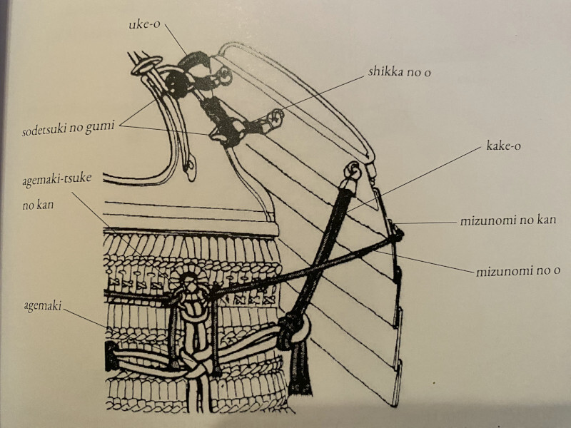

Hello Alex!
Depicted are so called ō-sode. There should be 4 cords:
uke-o (on the frontside, for connection with the watagami)
shikka no o (middle, also for connection with the watagami)
kake-o (at the backside, for connection with the agemaki loops)
mizunomi no o (on the kōgai-kanamono, for connection with the agemaki no kan)
I admit, a tad complicated. If you like, I can post a pic tomorrow?!

Please keep in mind, that only applies for “real ō-sode”. During the Edo period you can find some simplifications to the sode as also to the accompanying dō!
