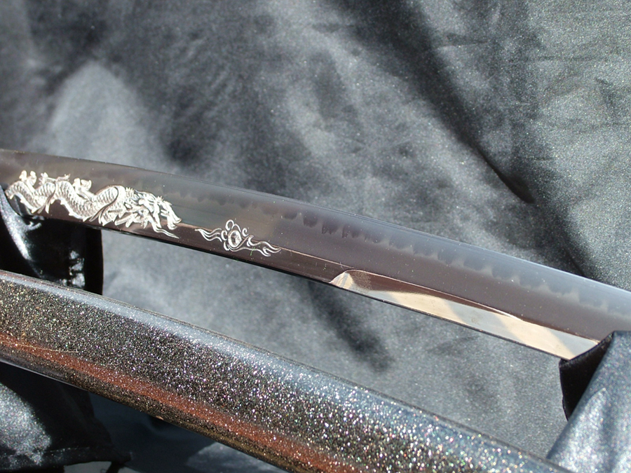

SwordGuyJoe Posted June 21, 2009 Report Posted June 21, 2009 All, I am looking to restore my Kanehiro and mount it. It needs a light polish and I have been given a few names on who to contact - Fred Lohman or Chris Osborne - but these names came up for non-gendaito polish of my Mantetsu. I don't want to assume that this is showato nor do I want to assume gendaito. So here are my questions: 1. How can I tell? Can someone help me? Here is a link to pictures of the sword with closeups: http://web.me.com/joseph.kraninger/Joes ... ehiro.html 2. If Gendaito, who can I contact? If Showato, does anyone have any other contacts? 3. The shirasaya is original and has seen better days - so I would like to mount it. Either shirasaya or koshirae. For Koshirae, I would need a habaki. I would like to get this done all at the same place (Polish and Mounting). Any suggestions on who to send it to for both Gendaito and Showato? 4. Finally - what can I expect to spend on all of this? I think to really understand the cost, I would need to know if this is gendaito or showato, since my understanding is that the gendaito polish will be more expensive, but I may be wrong. Thanks in advance for the assistance. Quote

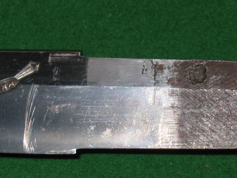

nagamaki - Franco Posted June 21, 2009 Report Posted June 21, 2009 Greetings, Based on the images this looks like a machine made piece of steel, a showato (showa military acceptance stamp), that is not water quenched, there is "no activity", "no nioi", "no nie". Quote
pcfarrar Posted June 22, 2009 Report Posted June 22, 2009 I agree with Franco its almost certainly a Showato. Polishing it would be a waste of money, IMHO its not so bad in the current state anyway. Instead of remounting/polishing better to spend that money on buying a decent gendaito. Or buy something like this with the hard work already done: http://www.nihonto.us/UDA%20IAI%20KATANA.htm Quote
SwordGuyJoe Posted June 24, 2009 Author Report Posted June 24, 2009 What would make you think "machine made" rather than handmade, oil quenched? Quote
nagamaki - Franco Posted June 24, 2009 Report Posted June 24, 2009 Greetings, SwordGuyJoe said: What would make you think "machine made" rather than handmade, oil quenched? Quote recognition - An awareness that something perceived has been perceived before. Where is the evidence that this steel is hand forged, and from tamahagane no less? Quote
SwordGuyJoe Posted June 24, 2009 Author Report Posted June 24, 2009 Answering a question with a question? I have only been collecting for a couple years and I don't ask what may be perceived as stupid questions, by people who have been collecting longer than I, to annoy or to imply I know more than they do. I ask them because I am new to this hobby and I am looking to learn. I am not implying that this is hand forged, nor did I make any mention of tamahagane used as the raw material. I asked so if I see a blade, there may be telltale signs I am not aware of, and if I know of them, I will be able to make a more informed observation and think to myself, that Nagamaki really helped me out. In my comparatively limited understanding, I have read of machine made blades that have had a hamon chemically induced, but that is typically suguha. This is not suguha and the hamon does not have the look of blades with chemically generated hamon - a dull uniform hamon, with little to no variation - and the time it would take to create a fake hamon of this shape would seem like a waste of time. I am anxious to hear about why you think that this is machine made. When you mean machine made, are you implying that it was partially machine made or completely made by a machine, as NCO katana are? Quote
Stephen Posted June 24, 2009 Report Posted June 24, 2009 I've had a good look at the blade, hada, hamon with nioi, no doubt in my mind that this was forged ...as in folded and hammered out...not a stamped out machine blade...to me this is one of those blades that's on the fence post, I really don't know why it has a Army stamp on it. The dark hardness at the peak of the hamon puts ones mind into oil quenched I don't think it so in this case. Over my few years on nihonto I can tell you as in life there is no absolutes, each must be measured on its own merits Quote
nagamaki - Franco Posted June 24, 2009 Report Posted June 24, 2009 Greetings, In looking at the images carefully again, this sword has what I perceive as "homogenized" steel, where I see no evidence of itame, mokume, masame, not even muji. Even muji is patterned to the point that it can be recognized as being hand forged, where homogenized steel is simply, well, "homogenized". And, again, I see no nie or nioi activity and have to conclude that it is not water quenched, wavy hamon or not. Now, did this sword smith take this machine made steel and work it into a sword, yes. Stephen, the reason this sword has a showa stamp is that it is a showato, not a gendaito. Quote
