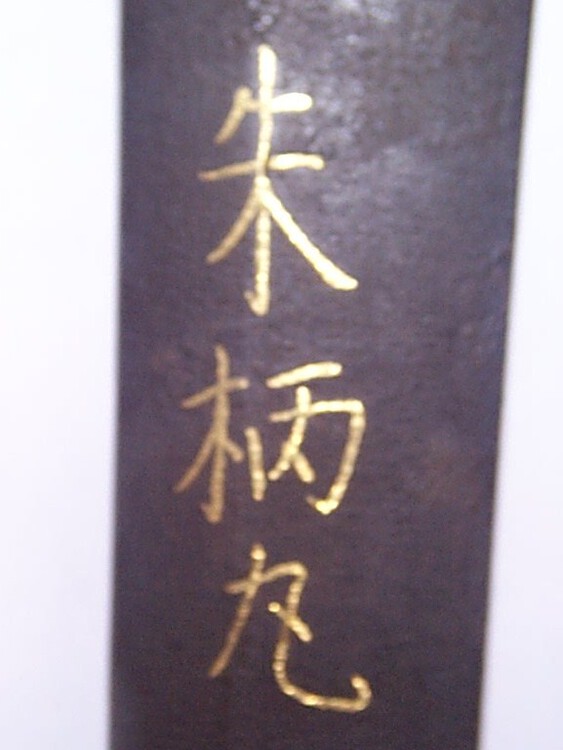

can anyone tell me what shu e maru means
i get blood red stick or vermillion stick

red tsuka mr/ms
apart from the obvious does this have another meaning?

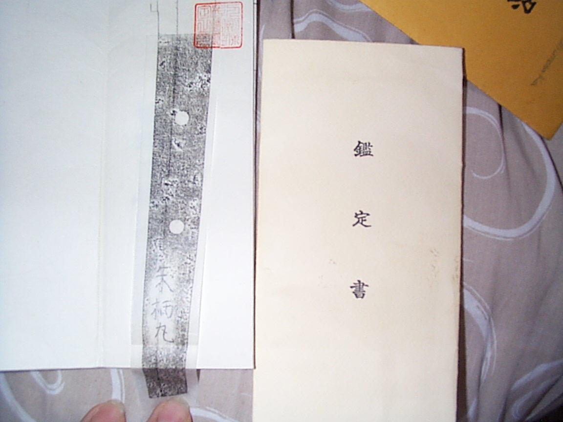

Can we see these papers, please? Otherwise it's not worth a second look.

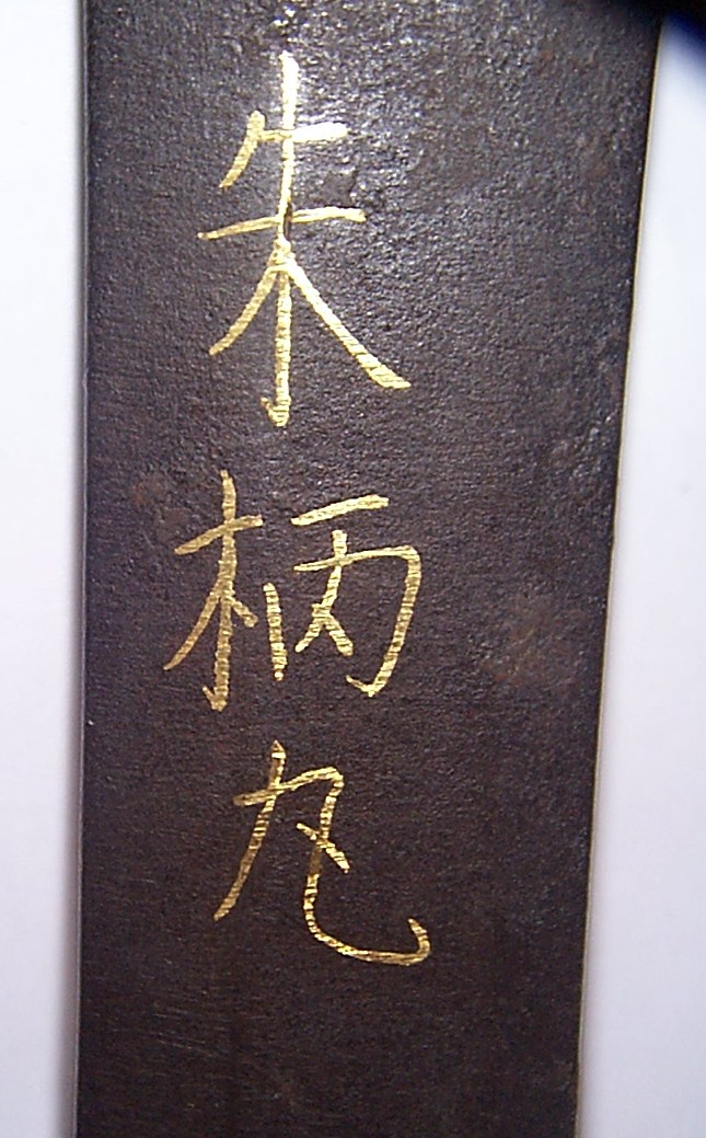

The suffix "maru 丸" is used traditionally for names of ships, boys and swords. It's an indication that the sword was named in regard to its Koshirae, but there are - as we know by now - always exceptions when it comes to Nihontō.
"aka 赤" and "shu 朱" both mean "red", but the latter is used for the vermillion hue we find with ink seals, traditional lip coloring, lacquer etc. in Japan and China.
The color, poor execution and unevenness of the surface of the Kinzôgan-Mei, along with the fact that one hardly finds the name of the Koshirae inlayed in the Nakago, makes me think that it's a recent addition. I, too, would be very interested in a scan of the papers and what they say.
Here's a neat trick for determining the age of kin zogan (gold inlay). When the inlay is done the gold and surrounding steel will be at the same height. With time, the steel corrodes and expands a tiny bit; gold doesn't corrode so it stays the original height. If you can't feel a very slight difference in the 2 metal's heights, you can assume that the zogan was done relatively recently.

here are the papers i bet money someone ,oh i give up

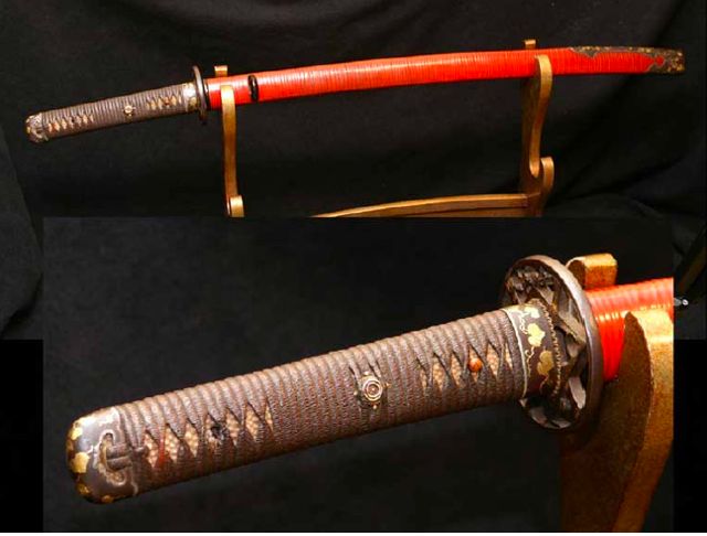

i was only pointing out that the original saya was a rusty brown colour .if the original tsuka wrap was red it might have matched the saya??
Thought you had misread the reply.
I don't think there is any corrolation between the colour of the tsuka and the saya in most cases. Maybe nowdays when we have this "thing" for matching furniture, but I believe in my opinion the original owners were far less meticulous about koshirae matching.

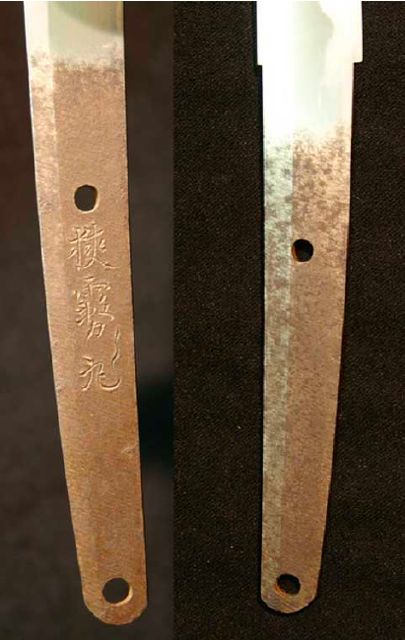

Please forgive me if I am taking this thread in a slightly different direction, but I find the subject of named swords quite interesting. There was one for sale at Christies a few weeks ago, a mumei blade attributed to Suzuki Masao and inscribed on the nakago and described as a kiritsuke-mei, were the charcaters "Kiyomu Maru" translated as "Mist Pincher" the significance of which escapes me. As the fine sword had a bright red saya I think it may have been a kinno-to.

The sword was offered in 2006 by a dealer at € 11980. This is what he wrote ... "A signed Katana from Edo period with attribution to TSUEKIRI MARU by NBTHK. This blade is not signed by the smith, but the signature is the sword owner's name"
Since I have a particular interest in swords by Kiyomaro and his mon I have saved the pictures. I have never owned this sword. Perhaps there is an explanation on the origami, left beside "Suzuki Masao".
Eric
The NBTHK paper only shows the inscription and describes that it is a Kiritsuke-mei other than the attribution.
This is my guess:
The inscription looks 梜霧丸 to me, and I think that it is the name of the sword. The name may read "Sagiri-maru", although other kanji is usually used for the term. It just means mist (霧: kiri). In the context, “sa (梜)” is a prefix without exact meaning, and “maru (丸)” is a suffix to be used for a name of a sword.

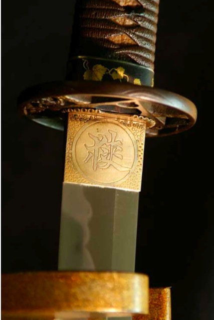

Further quoting from Christies catalkogue on the Masao, it states that there is a "Silver habaki engraved with the characters for "hasamu-kyo" and "kiri-mu". What is the meaning of this, is it different from the nakago kiritsukr-mei or simply a different way of reading them?
Clive
I suspect that the kanji on the habaki are the same name on the nakago. However, the first kanji might be deciphered incorrectly by the reader. (FYI: http://www.christies.com/LotFinder/lot_ ... ID=5205401 )
