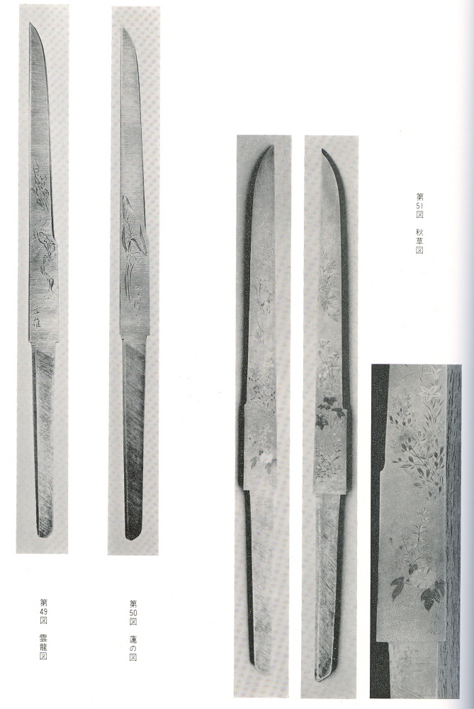

As a result of earlier discussions of the work of Natsuo I bought a book on his work from Craig at Bridge of Dreams (great sale BTW) In any case there is no mention of him making a kogatana. There is a picture of a couple of pipes which I found unusual. Ford's posting of photos of his work led me to buy the book. Thanks for the contribution Nobody San.
I hope I'm not out of line here, but as a newbie, could I ask that someone give a brief explanation of the who, and why of this "rare" piece? Nothing extensive, just a brief background for us that know nothing. Or a point to reference material. Much appreciated. Thanks.

Hi Colin,
Kano Natsuo (1828-1898) is considered my many connoisseurs to be one of the, if not the, finest artists in the kinko tradition.
He seems to have been a good businessman and ran a very productive studio. Many of his assistants/students went on to become celebrated Meiji period artists in their own rights. Natsuo was appointed "Teishitsugigeiin" to the Emperor's court, this was the sort of position that would eventually be better known as "Ningen Kokuho", the holder of an Important Intangible Cultural Asset.
His workmanship, from a technical point of view, is always flawless and incredibly sensitive and delicate. He had a very refined, elegant and understated aesthetic which for many epitomises the highly cultured court life of the Heian period.
I've seen a few kozuka by him but I suppose they are a bit of a rarity. The inscription is in a clerical script that evokes a strong antique feeling, and would have done so even when it was new. I'd suggest that the quality of the piece lies as much with the actual carving of the kanji as with the calligraphy. What I mean is, this would be a fine piece of calligraphy even if it was "merely" painted on paper....all the more impressive that it's carved, so perfectly, in steel.
It's very easy to overlook much of the real beauty of work like this, particularly when only viewing a photo, but there is a great deal more here than first meets the eye. It's this sort of subtle and sophisticated chisel work, almost regarded in an abstract way, that is most highly prized by the Japanese connoisseur, whereas in the West the most commonly appreciated aspect is the subject matter.

Excellent, Ford. I see what you mean. Thank you so much. The bio and critique are really helpful. Little bits like this reinforce the oft repeated manifesto of "quality, quality, quality." And, of course, the straight info is good for us neophytes as it just adds to our knowledge base. As I said, much appreciated.

I just have to emphasize Ford´s observations with a double-underline, and I take the liberty to add something for the context.
The clerical script (reisho) which was chosen by Natsuo was especially in fashion at that time (from the mid-19c into the Meiji period).

Thanks Markus, there is nothing I can correct.
I found that the poem on the kogatana is a part of a poem composed by Li Bai (李白).
