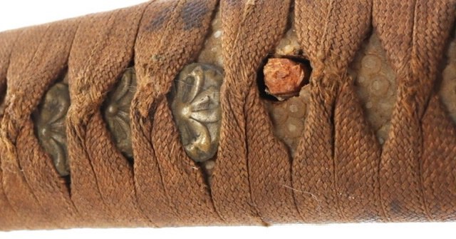

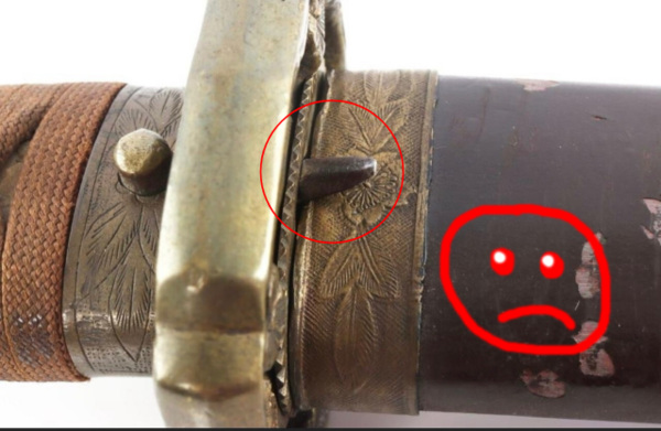

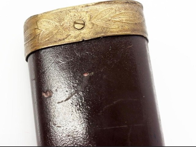

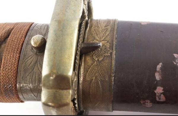

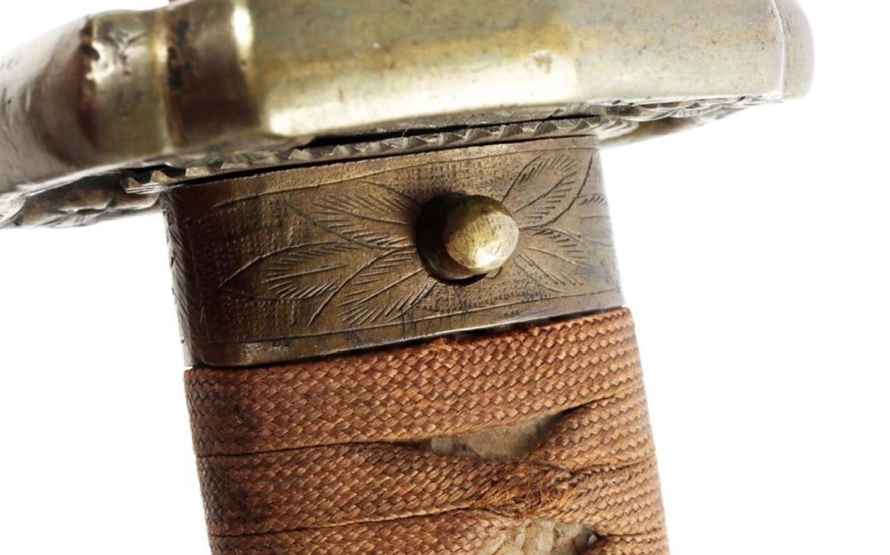

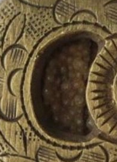

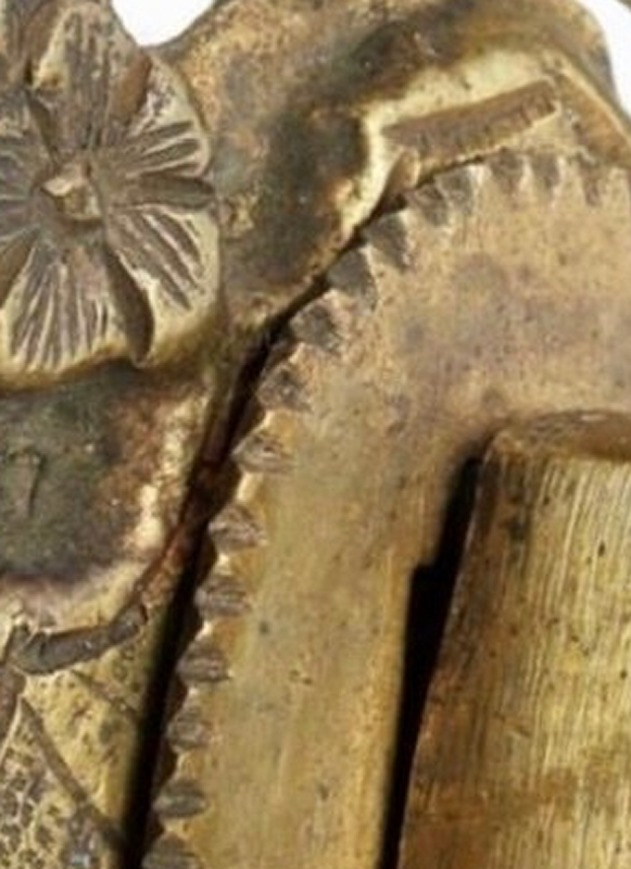

Bridges Posted December 20, 2022 Report Posted December 20, 2022 Hey guys, this type 98 fittings are NOT matching up with the ones I’m seeing in Dawson’s guide. Can someone steer me in the right direction? Quote
vajo Posted December 20, 2022 Report Posted December 20, 2022 Looks like custom made fittings. Late war or island made i don't know. This looks not like fake. The kabutogane is chissled, also the fuchi and the koigane. To much work for a fake sword. The ito looks Japanese made. Can you show us the rest of the sword? 1 Quote
vajo Posted December 20, 2022 Report Posted December 20, 2022 Late war gunto for me. Is it yours Noah? What about the blade? 1 Quote
Stephen Posted December 20, 2022 Report Posted December 20, 2022 Chinese copy. No island BS 5 1 Quote

vajo Posted December 20, 2022 Report Posted December 20, 2022 Hamfish why they chissle all the fittings? Is it it not a little to much work for an modern fake? Seppa is cut out by hand Every piece is made by hand on this. All that work for a cheap gunto replica? For me it is a handmade type98 sword. Not Japanese but authentic. I would really like to see that offer and the blade? Anyone knows where these sword auction is? 1 1 1 Quote
Stephen Posted December 20, 2022 Report Posted December 20, 2022 Not sure I understand Chris there's Chinese fakes out there that are almost hard to spot this is obviously a copy it's not an island sword brother 3 1 Quote

Bruce Pennington Posted December 21, 2022 Report Posted December 21, 2022 8 hours ago, Bridges said: Hey @Bruce Pennington! I thought this was a late war type 98?! That's as good a label as any other. Assuming it's not a fake, which is still possible, but I feel it's not a fake, then we don't know much about the swords made in occupied territories. We don't know a timeline. Many Japanese units were sent into vast areas and told to live off the land, with no hope of re-supply. So, were swords like these made throughout the war? Or were they just made in the last year when production was moved off the mainland? It is a common term, recognized by all, so fair enough calling that. Sorry for getting vague, but there is little we know about these. 1 2 Quote
lonely panet Posted December 21, 2022 Report Posted December 21, 2022 well the last sucker hasnt been born, if anyones attempting to legitimise this sword. its all junk 2 Quote
vajo Posted December 21, 2022 Report Posted December 21, 2022 After all what i learned here about island swords, emergency last stage swords, occupied territories made sword, field repair teams and extemporaneous made field swords i will never say - never. To much pictures out there with chinese in Japanese uniforms with sandals and crude looking Type98. There is wide range between fake and authentic. This sword is so much individuel made in design and shows so much sign of wear. Someone put a lot of work in this fake. We all know the typical chinese fake swords. This is not one of them. Are those swords collectible - no, not for me. Its trash. But also trash can be authentic. And if a collector wants to collect these type of swords? Why not if he likes it. People collect everything. Some collect ww2 sake cups, others the shitty pants of German soldiers. 4 1 1 Quote
Dave R Posted December 22, 2022 Report Posted December 22, 2022 I would go with wartime Chinese made, possibly for Ta Tao. The Ito-maki is wrong for anything assembled by a Japanese artisan...... A view of the tang would answer some questions though. 3 1 Quote
