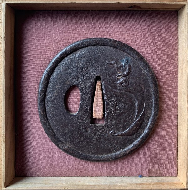

Bugyotsuji Posted December 16, 2022 Report Posted December 16, 2022 Just stretching/decorating the topic a little here, (apologies!) but this might also be Daruma crossing the river on a reed? Faint signature 金家. 3 1 Quote

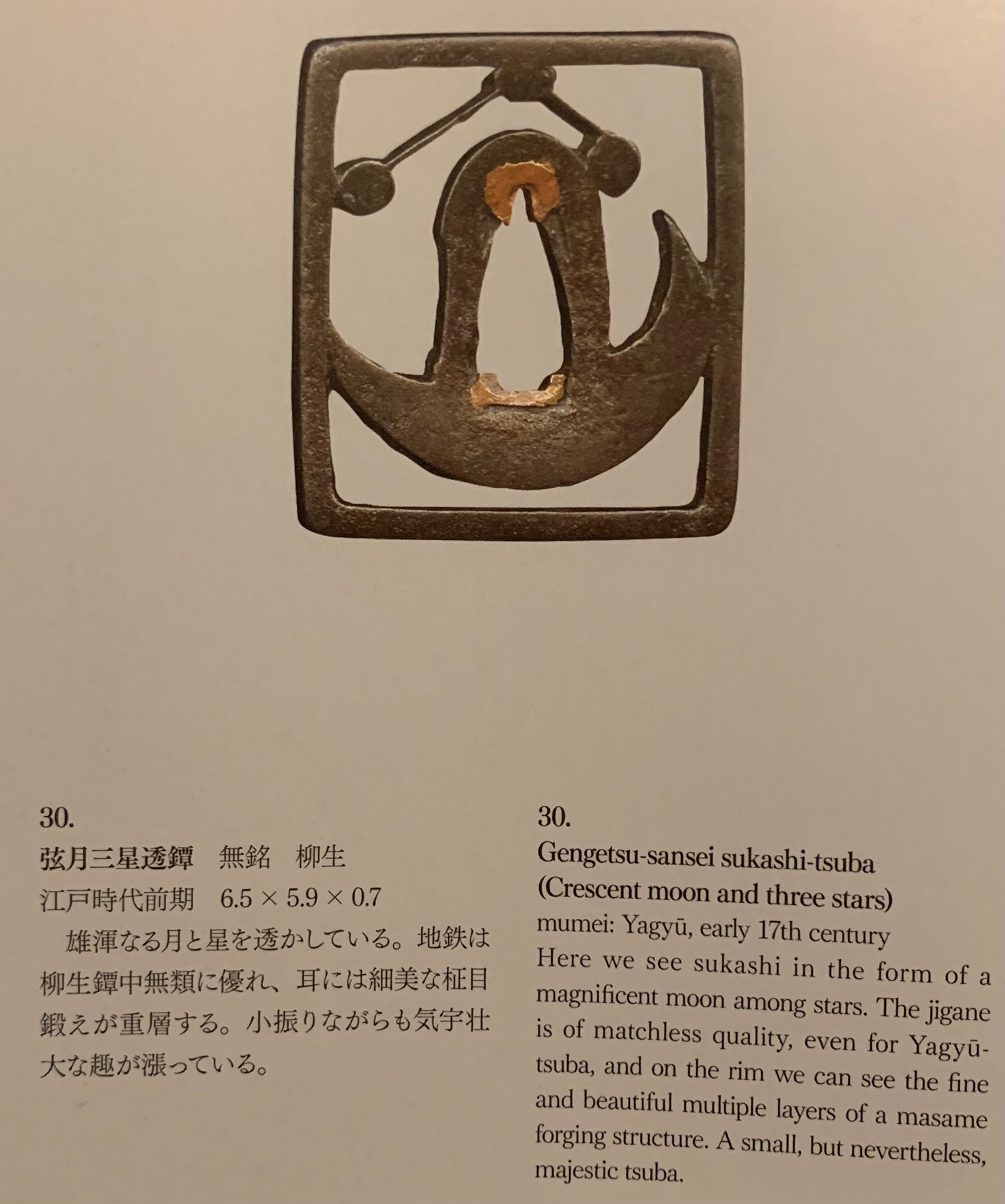

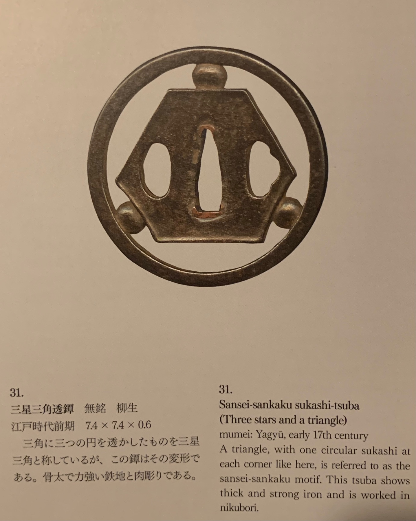

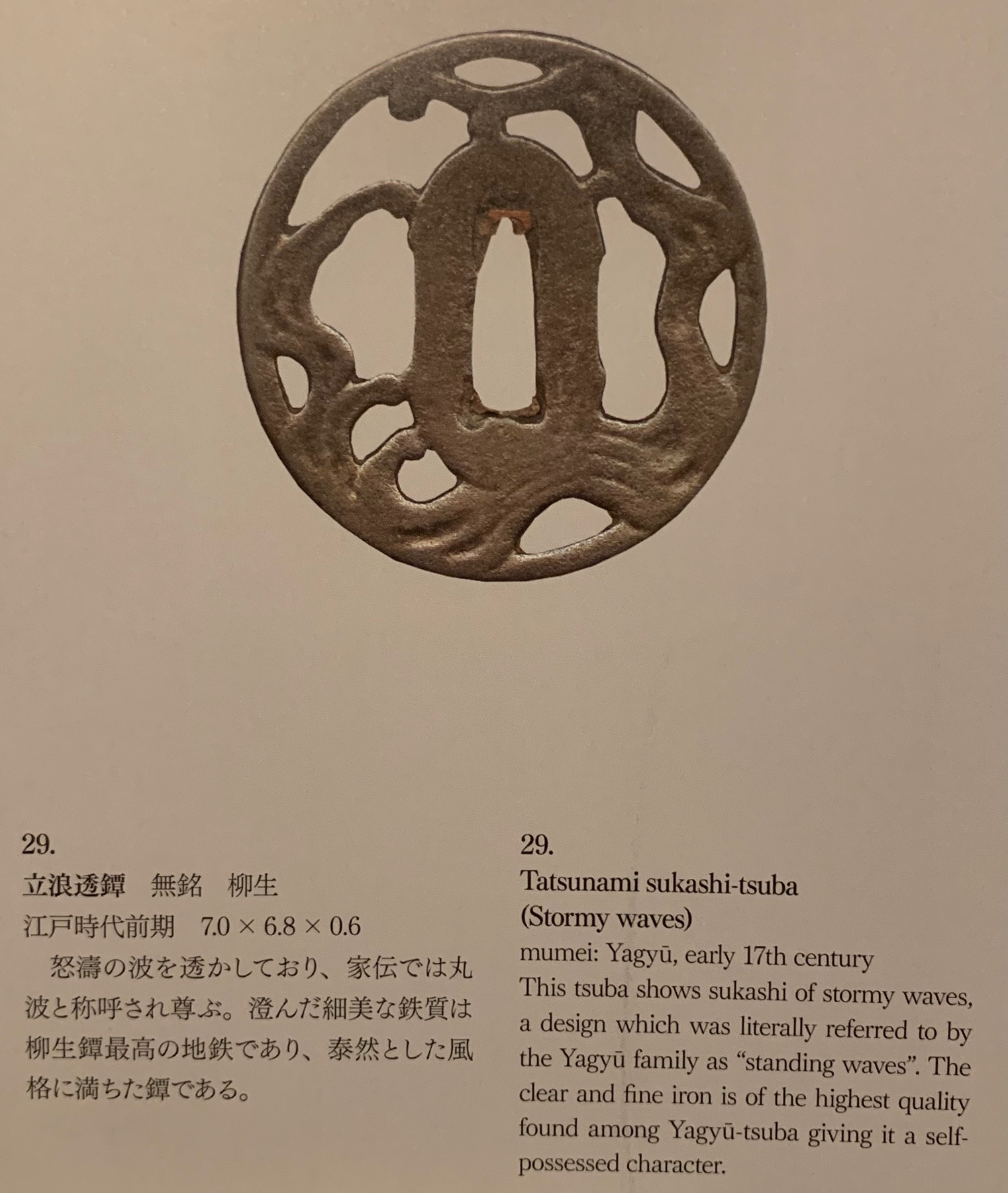

Bugyotsuji Posted December 16, 2022 Report Posted December 16, 2022 Jean, these Yagyu are from ‘Iron Tsuba, Kurogane no Hana’. 2 Quote

OceanoNox Posted December 16, 2022 Report Posted December 16, 2022 2 hours ago, Bugyotsuji said: Jean, these Yagyu are from ‘Iron Tsuba, Kurogane no Hana’. Piers, is it correct to assume Yagyu tsuba usually have a theme linked to Shinkage ryu's teachings? 1 Quote
Bugyotsuji Posted December 16, 2022 Report Posted December 16, 2022 45 minutes ago, OceanoNox said: Piers, is it correct to assume Yagyu tsuba usually have a theme linked to Shinkage ryu's teachings? Dunno, the idea makes sense, I’ve seen it written and heard the rumours, so guilty until proven innocent I guess, but I’d be interested to find out more! Quote
OceanoNox Posted December 16, 2022 Report Posted December 16, 2022 The reason for my question is that I have checked in a book (100 tsuba and sword accessories, a guide to evaluation and appreciation, by Kazuo IIDA and Michiko HIRUTA, Tankosha (2004)), and there are two Yagyu tsuba. The first is round with a triangle whose tips are pierced with a round hole each. It is said to refer to the 三磨 (sanma, the three learnings). The other is a "billowing sail", which is said to be a teaching about imitating the power or movement of a sail. 1 Quote
