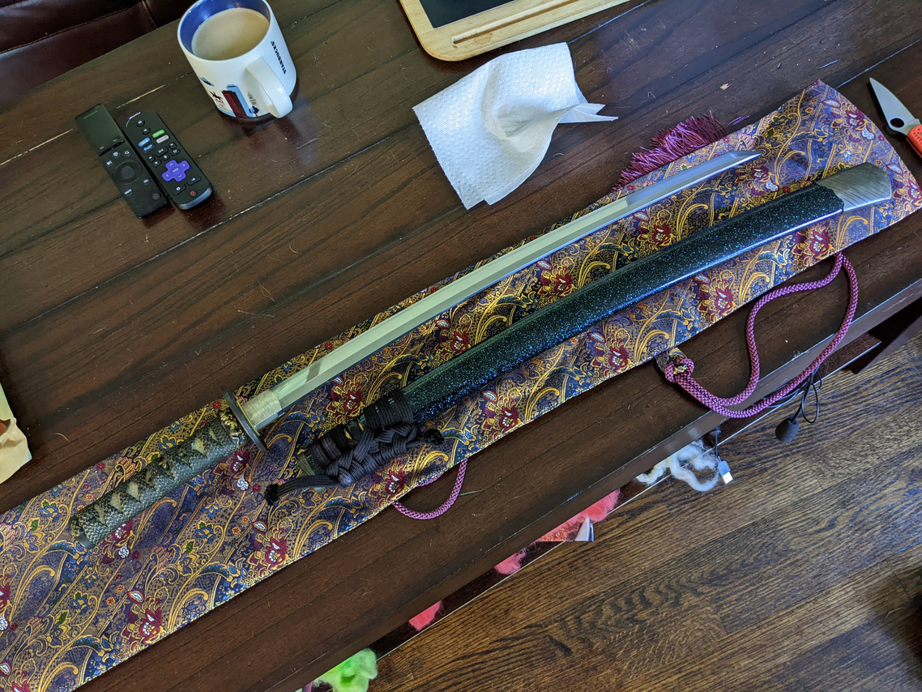

Greetings!  I am coming over from the SBG forums having purchased my first Japanese piece.  I am very surprised at how old these blades can be, and at how well they have survived.  To find something equivalently preserved on the hema/european side is almost unheard of.  I hope to expand my collection beyond this initial piece, but so far this first one has proved to be very impressive!  Any insight into it's history would be greatly appreciated
I did have one additional question:  The tsuba is very loose.  The hole that the blade passes through is significantly larger than the tang itself.  Is this something that you should attempt to repair/fix with an older weapon like this?  Or is it best to leave it alone and preserve it's condition

If the hole is too large, copper pieces are usually fitted in the tsuba to fit it to the blade. However that isn't easy for the average owner, so I would just add some leather pieces to tighten it up. You won't see them anyways.
Tsuba are often swapped out, and I think most average swords have had some pieces swapped out.

If you Google semigame you’ll find tutorials about how to fit your tsuba. Your tsuba shows the cut outs where copper was previously used to fit to the nakago. If you cut out copper of the same thickness and shape and anneal it, you can easily fit it in place and expand it by hammering with a punch to fit tightly.

Ben, I use a pliable metal to fill in gaps on the tsuba and then file it smooth.
But, being new to the Nihonto world, Grey's advice is the best.
I have made some cast copper fittings for tsuba that are done in wax first and then cast the same way a gold crown for a tooth is made. The are usually staple shaped and fitted to the top and bottom of the tsuba opening then removed and cast. They are closely adapted but not exceptionally tight and are just friction fitted and no filing or hammering takes place on them as they are placed so that there is no potential for damage to the tsuba itself.  Like anything else - in any attempt at any endeavour - do no harm. Now that said if you do not have access to a casting machine or a dental lab you are probably out of luck !
Jesse,
you can make SEKIGANE just by hammering, sawing and filing them out of a solid copper sheet (about 5 mm thickness), but you will have to know how this works and what can be done to avoid damage to the TSUBA.
