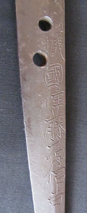

I know Nobuyoshi has been discussed here before, however this discussion takes a slightly different path. I have a signed Yamashiro (no) Kuni Ju Fujiwara Nobuyoshi katana in shirasaya. The problems are: 1) the signature on the blade looks different than 7 other reference samples I could find and 2) there does not seem to be any official source showing any of the Nobuyoshi generations signed this way.

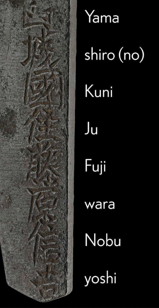

Below are just two examples of other papered signatures along with my signature (with gray background) and the origami. Specifically, the Kuni character (using rounded vertical strokes) and wara character (vertical stroke not in the right place) are very different than the reference samples. And I would add, all seven of the reference samples were papered and very similar to each other.
Question 1: Why would NBTHK approve a signature that looks this different?
Hello,
To begin with the NBTHK will have available more resources than we are likely to come up with. Years ago I had a signed katana that did not match any of the 12 published signatures available to myself and to friends with very extensive libraries. Yet, after being sold to another friend, it passed both the NTHK shinsa before being polished and the NBTHK shinsa after being polished with flying colors. It should be stated that that sword matched the textbook descriptions to a 'T.'  Which once again affirms the notion that the sword confirms the mei and not the other way around.

Jussi: Those are the other references I have of that particular mei (a total of seven of them). The "wara" character in particular, looks much different than those examples. Indeed, the "kuni" character is different as well. Therein lies the problem. All of the examples are similar except for mine.
Additionally, I cannot find that particular wording of the mei in any referenced/published resource for Nobuyoshi. Perhaps, as noted by Franco, I just don't have access to enough sources.
John C.

Not being a specialist on Nobuyoshi by a very long shot...
If this was a european auction house they would provide a similar signature upon request in an established publication or database, but we deal with different standards here, so we can only guess.
Generally signed items are checked with some rigor against the published examples.
With two or more generation smiths one tends to assume somewhat greater variability as "normal", much more so if its Muromachi.
With "chujosaku" smiths one typically does not apply the same level of scrutiny as with jo-saku and above.
Generalities aside, what can be relied upon here is that the "tempo" of signatures is actually very similar.
Distance between kanji and between lines of kanji, the number of distinguishable strikes per line are similar, the pressure points are similar, and most importantly this "tempo" remains consistent throughout the signature. Usually with gimei there are weird pauses where the signer looks at the template in front of him and adjusts the chisel a bit for the next stroke "to get it right". If he does not do it, the whole signature will be more and more divergent from the original towards its end, if he does you see a discontinuity in the execution.
On your photograph the signature looks extremely slanted, but on the papers its much more straight, it slants just a bit, so some of this is probably a distortion due to using a wide angle lens against a curved object like nakago.
The signature is a bit condensed, and many dislike condensed signatures as a reflex, especially on wakis, where unskilled gimei artist can fear there is not enough space so overcondenses from the beginning and then has to continue like this till the end), but the examples you compare against are also condensed, so it seems to be his writing style.
That the individual lines point in different directions is not a definitive proof of gimei for the majority of signatures.
Rivkin:
Thank you for that concise analysis. I suspect, then, the process of gimei is similar to that of bad check writers, who often stop to look up at the signature in order to get it right!
You are probably correct about the distortion the light causes on the characters. I hadn't considered that. I couldn't reconcile how the smith could get a character so wrong by misplacing a stroke (the vertical stroke on the "wara" character appears to start on the right rather than on the left).
Thank you again,
John C.
The vertical stroke in the 原 character you mention is a somewhat normal writing convention, particularly in handwriting/calligraphy. Its not that the smith got it wrong, its just a slight calligraphic flourish. You can click on the link below to see it written in cursive style.
https://ryohkei.com/kanji-gen-cursive-2-83.html
This is why the shinsa team looks at the entirety of the sword. Slight variations in signature are tolerated if the sword looks every bit like a Nobuyoshi sword.
