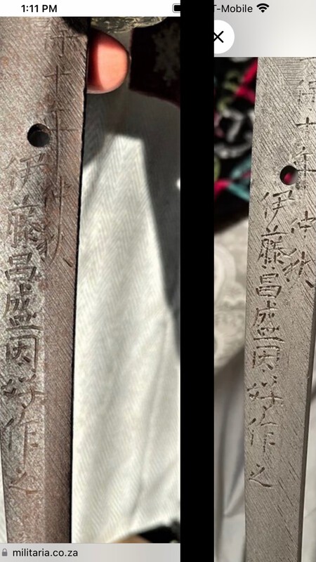

 He answered my inquiry with the following Nakago pictures just a few hours ago:
Ura:

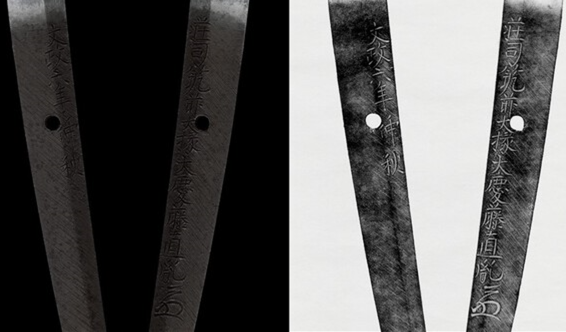

大慶直胤 - Taikei Naotane allegedly
Omote:
Made in the 10th Year of Tempo - 天保
Wasn't really able to work out the rest grammatically in a way that made sense to me- 伊藤昌盛因好作之

I agree with Brian the mei looks sloppy both in strokes and placement compared to what I have seen on the web. My mind does wander to what this blade would look like in polish, it very well could be a nice mumei blade. :dunno:
It's back up on ebay - https://www.ebay.com/itm/134375920654
Seems the seller in their grand "wisdom" cleaned the Nakago.... In any case, the sword seems spurious to me in terms of being even a legitimate Nihonto, something about the way the sword appears in the photos leads me to believe it is of Chinese production but I could be wrong.

Yep a nice new cleaned nakago and I’m sure a little sandpaper and a final turn on the buffing wheel for good measure. Nothing a good squirt of
WD-40 and Brillo pad can’t fix. If I ever have a headache I’ll be sure to hire the closest Neanderthal with a blunt rock to fix my ailment 🙈🗡 R.I.P. Naotane!!

I can see trace amounts of rust on the nakago, they did a bad job of doing a bad job lol people on eBay throw their money at anything  (sometimes I’m included)
