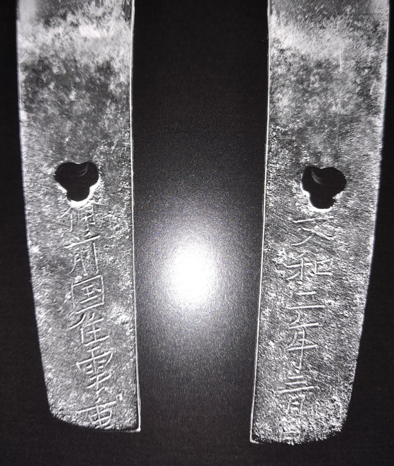

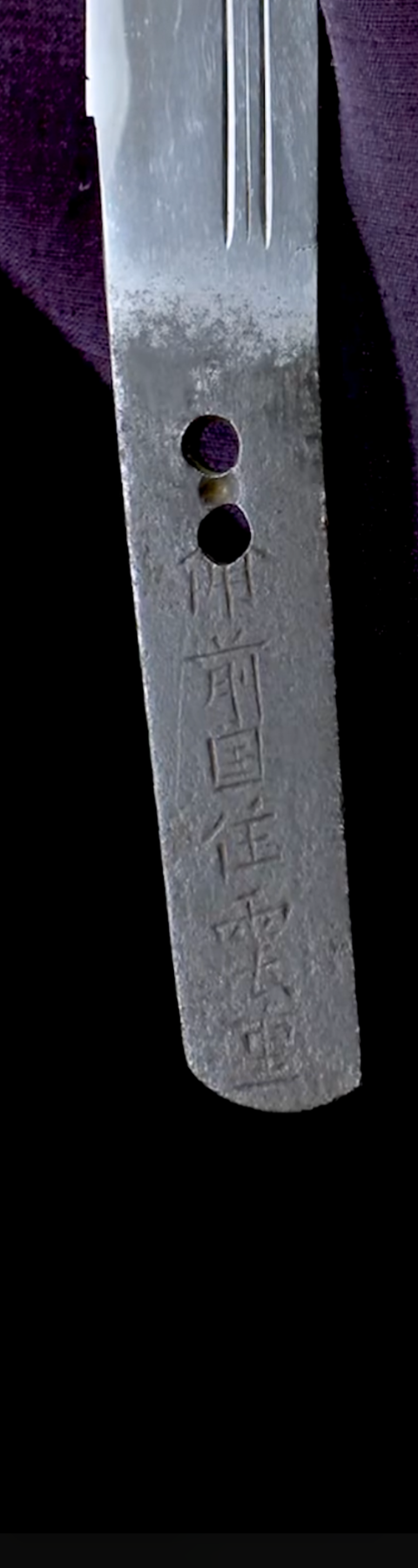

MrTT Posted December 9, 2022 Author Report Posted December 9, 2022 On 12/9/2022 at 4:23 PM, Okan said: It's a sunnobi tanto(ko-wakizashi)..Looks Bizen-ish..Is it signed? Papered? Expand Signed : Bizen Kuni Ju Unjū Quote

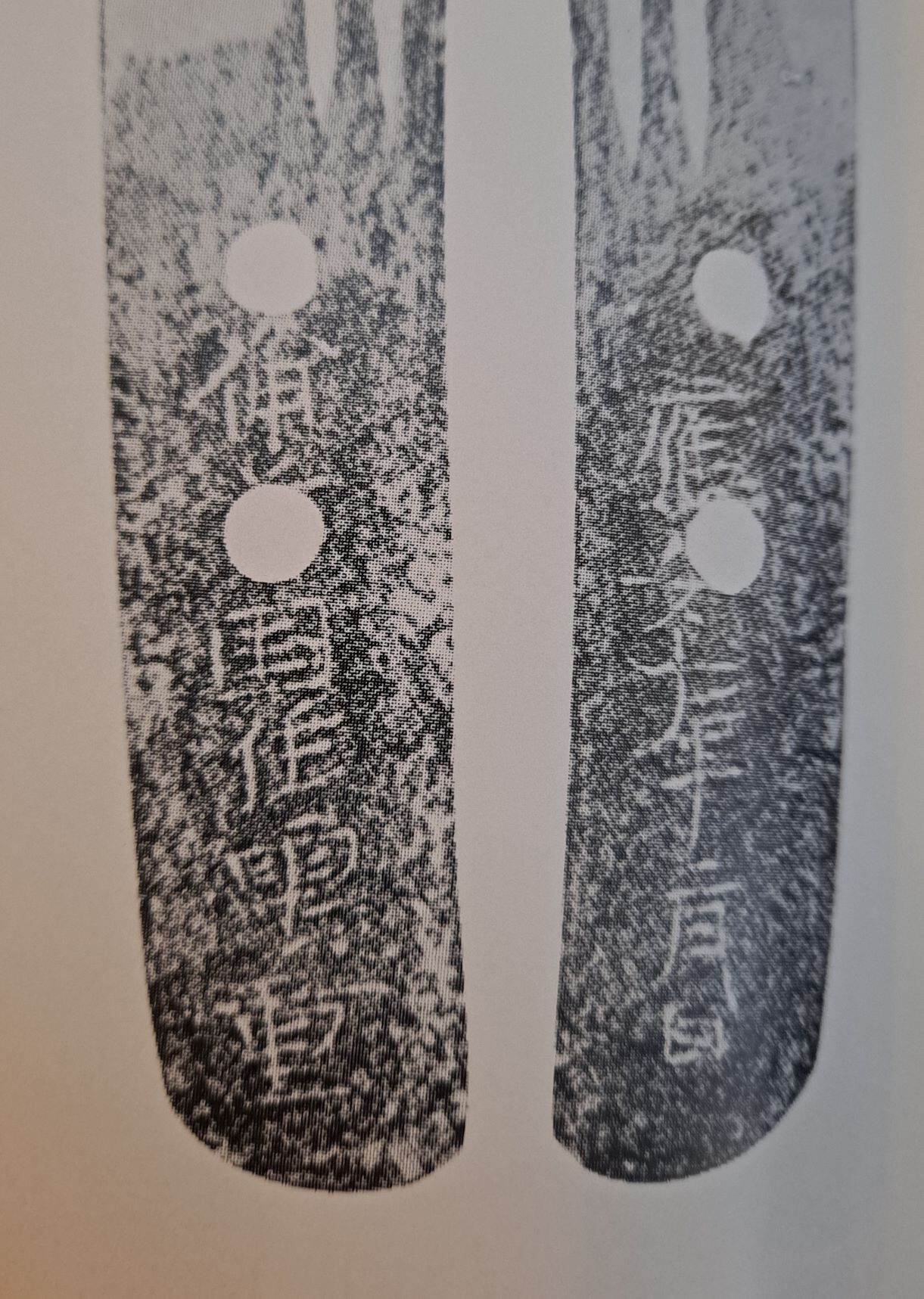

Okan Posted December 9, 2022 Report Posted December 9, 2022 I might be wrong but this looks gimei to me. If you have the sword in hand please compare these two signatures. A bit hard for me to see from the picture. @Ray Singer would know better. Quote
MrTT Posted December 9, 2022 Author Report Posted December 9, 2022 On 12/9/2022 at 8:16 PM, Okan said: I might be wrong but this looks gimei to me. If you have the sword in hand please compare these two signatures. A bit hard for me to see from the picture. @Ray Singer would know better. Expand Another picture. I was thinking of buying it. Hmm 🤔 If gimei, not good. Quote

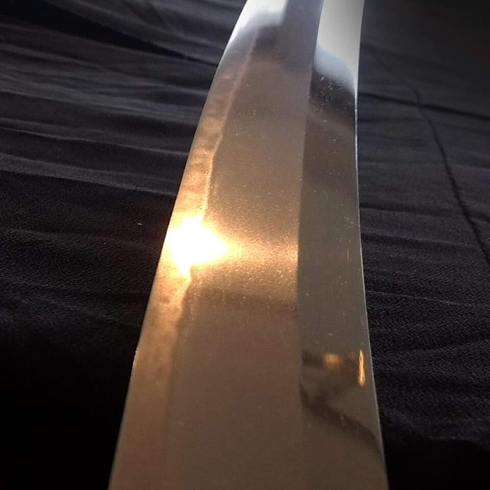

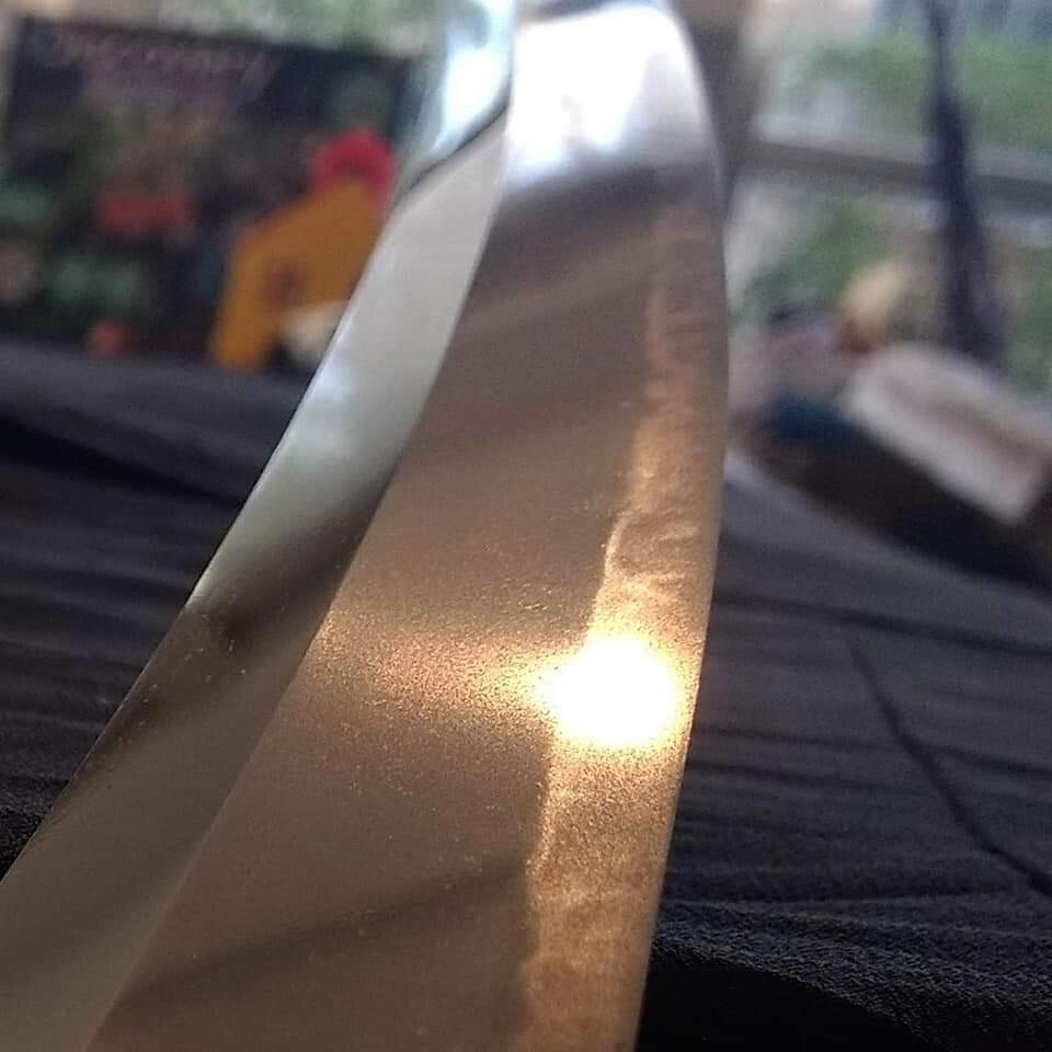

John C Posted December 9, 2022 Report Posted December 9, 2022 Dave: Depending on what the blade costs, I would not immediately discount it because it is gimei. Gimei blades are very common, and as I am sure you have read on various threads, assume ALL blades without origami are gimei until proven otherwise. That said, I would be more concerned by the hamachi/mune-machi line. It does not appear to line up in the pictures, which can be a common sign of Chinese manufacture. Just my humble 2 cents. John C. Quote
ROKUJURO Posted December 9, 2022 Report Posted December 9, 2022 Dave, buy the blade, not the signature! 3 Quote

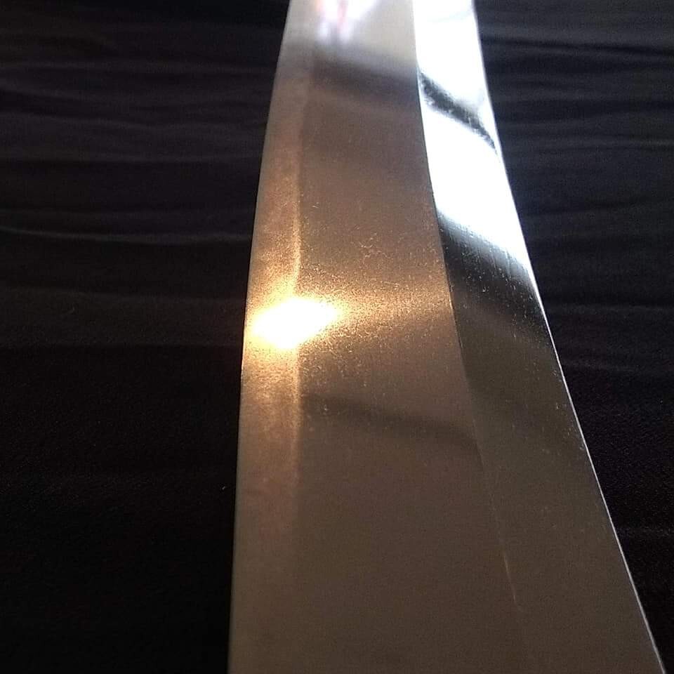

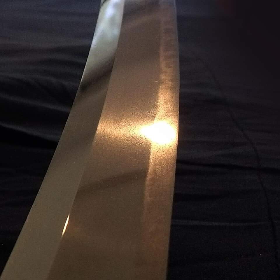

MrTT Posted December 10, 2022 Author Report Posted December 10, 2022 On 12/9/2022 at 11:55 PM, John C said: Dave: Depending on what the blade costs, I would not immediately discount it because it is gimei. Gimei blades are very common, and as I am sure you have read on various threads, assume ALL blades without origami are gimei until proven otherwise. That said, I would be more concerned by the hamachi/mune-machi line. It does not appear to line up in the pictures, which can be a common sign of Chinese manufacture. Just my humble 2 cents. John C. Expand Some more pictures. Quote
Okan Posted December 10, 2022 Report Posted December 10, 2022 On 12/9/2022 at 11:56 PM, ROKUJURO said: Dave, buy the blade, not the signature! Expand Agreed, but there would be roughly 3k euros difference between gimei and real Unjū Quote

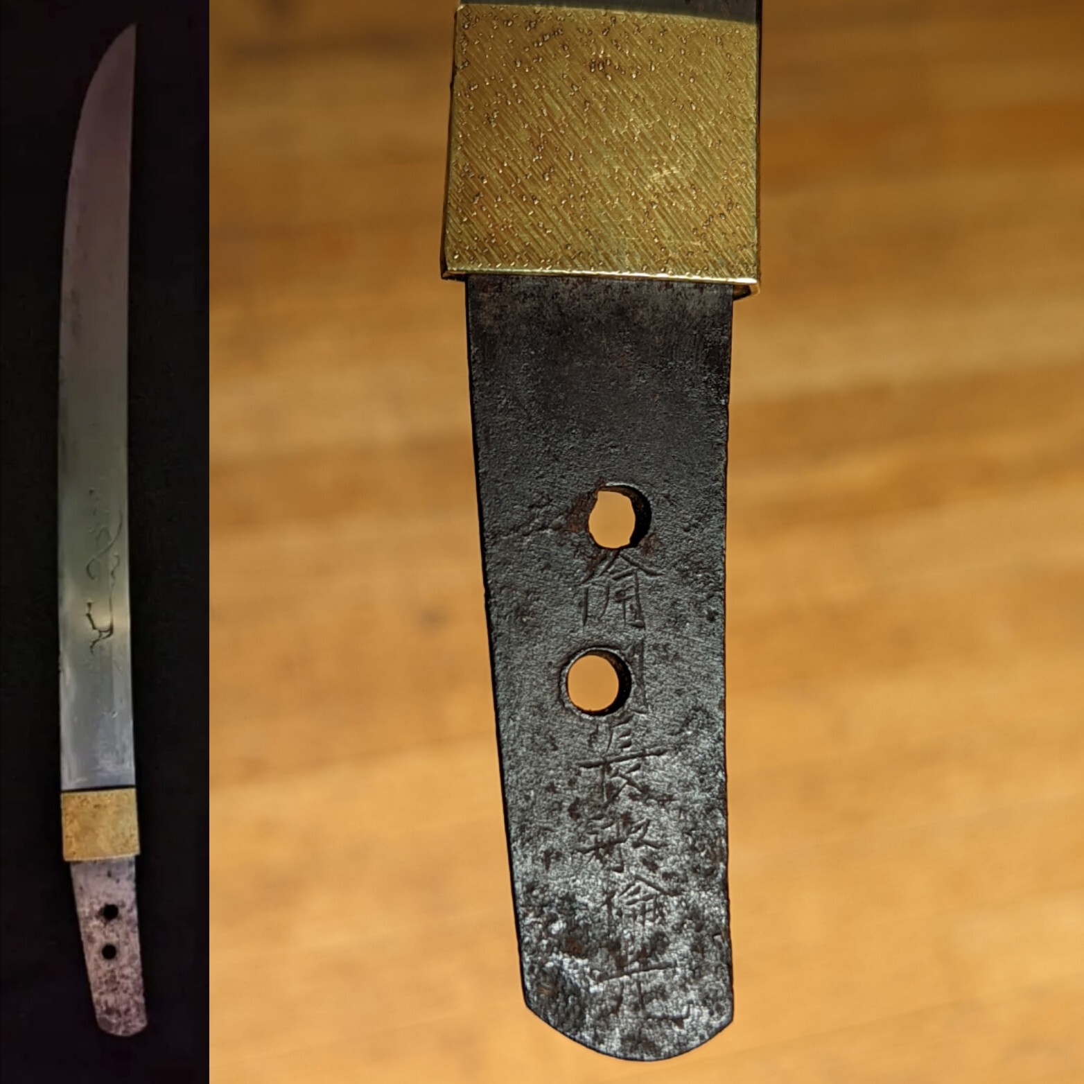

Ray Singer Posted December 10, 2022 Report Posted December 10, 2022 It is helpful to see the entire sugata, rather than in small sections. As an example, this is a Nanbokucho hirazukuri tanto I just sent out for shinsa (which has already been evaluated by Tanobe-sensei). Quote
Ray Singer Posted December 10, 2022 Report Posted December 10, 2022 And a tokubetsu Hozon Unju I own. 3 1 Quote
MrTT Posted December 10, 2022 Author Report Posted December 10, 2022 On 12/10/2022 at 1:00 AM, Ray Singer said: It is helpful to see the entire sugata, rather than in small sections. As an example, this is a Nanbokucho hirazukuri wakizashi I just sent out for shinsa (which has already been evaluated by Tanobe-sensei). Expand Some more pictures 🙂 Quote

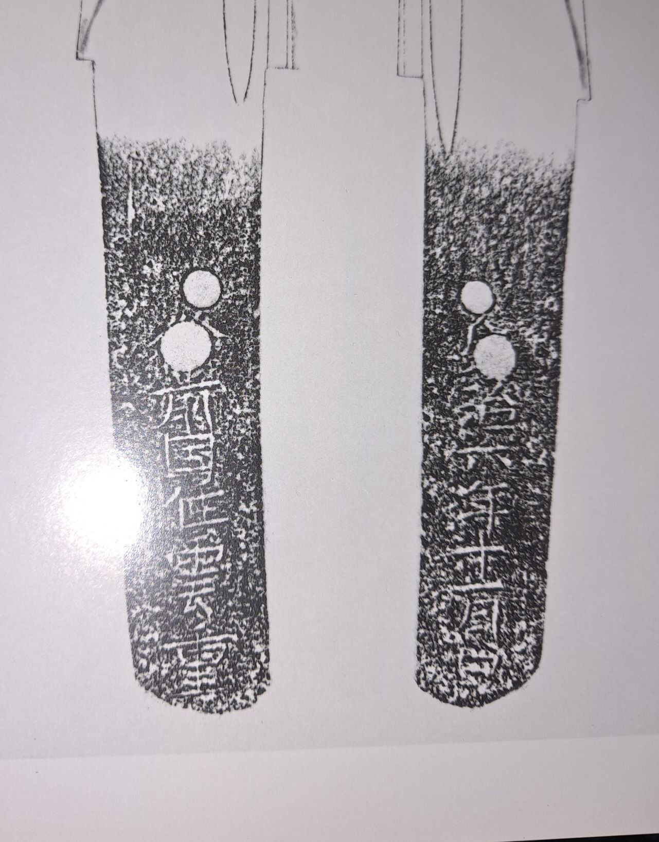

Jussi Ekholm Posted December 10, 2022 Report Posted December 10, 2022 Here are 4 legitimate Unjū signatures on tanto & short wakizashi I have found so far. You can see some variation in the 4 reference signatures but I would be quite skeptical of the signature of the blade posted in OP. 1 Quote
MrTT Posted December 11, 2022 Author Report Posted December 11, 2022 Ok, then we know its mumei. Thank you Quote
