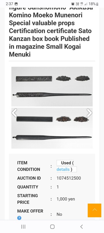

Hi all,
Just interested?
Came across these in Japan.
Firstly I can't see how these are a match- the foliage doesn't seem to match - but maybe me!
Due to this I was surprised to see an origami with all on it! Can't translate it so wondering if there is any clues on it?
Also is the same stigma with grey papered tosogu as with blades?
Regards and thanks

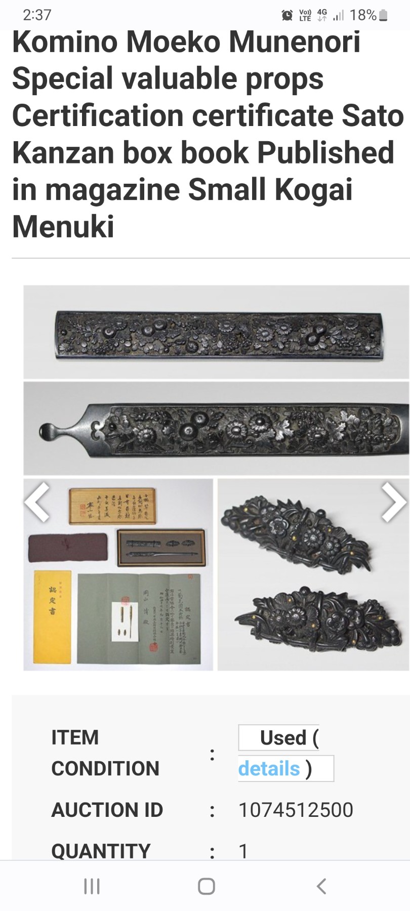

Hi Piers,
Apologies for pics, screen shots off listing. Yes mumei so I was wondering about Munenori? No attribution on paper I suppose- rare for that anyway I think. Probably can't see but menuki has subtle gold/ brass highlights and completely different foliage- just surprises me that this could all be papered the one?
So grey or green- reliable?
Cheers
Nothing there that shouts reliable. Deliberate or not? Nothing to really tie all these parts together.
Can you show a link to the original Japanese listing, Mike, where at least some of the answers may lie?
I believed I looked at this one on Yahoo!Japan the other day.

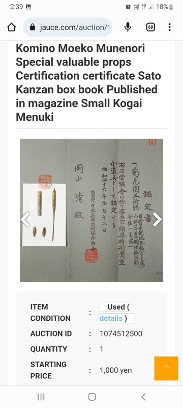

Old green papers (1970s) that paper these to "Mino".
Not "Ko Mino". Big value difference.
Otherwise, I didn't see anything wrong with this auction. Just some up-selling to call these Ko-Mino (roughly pre-1600) when they are Edo Mino.
While writing an update (found the originals), Curran posted above. Agreed.
The guy makes out that they cost ¥650,000 originally, but for something *'Soten'. His reputation is 99%, but he could have given us clearer shots of the paperwork and photos. Too many little inconsistencies, I feel, although the Kanzan box attribution to 'Mino' looks right for whatever was in there originally.
(The menuki only are given Ko-Mino on the old NBTHK paper.)
PS Recently an 'expert' told me that the old distinction between Mino and Ko Mino is no longer thought provable, so people tend to avoid it now.
*Ah, this must be the Munenori he refers to, though I cannot yet work out what Moeko is...?

My two cents: the paper and the auction listing are at odds, the paper is an old, unreliable paper... so there are two red flags already on the field. There is nothing about this auction that makes me think this is a an interesting purchase.
On the other hand, if you are looking for a cheap set of mitokoro-mono, and you don't go overboard at the auction, your downside is not going to be too extensive. But I wouldn't go into it thinking its a papered set of any great value.
The paper says the menuki are Ko-Mino, and the other items are just Mino. I don't trust the papers in the first place, but I wonder if such a set would even get looked at as a proper "mitokoro-mono" nowadays. Anyway, its just another flag on the field.

Hi.   Just a note regarding the tokubetsu kicho papers, they may look greyish now but they are green papers.
The NBTHK give zero credibility to these papers, even with fittings.
This year I submitted menuki for Tokubetsu Hozon Shinsa, they had green papers to Umetada.   When my contact took the menuki to  NBTHK there were dismissive of the green papers, didn't want them, totally ignored but my contact persisted and they took the papers and munuki.   After shinsa, when the new Tokubetsu Hozon Papers were picked up (Umetada again) the NBTHK had discarded my original green papers which upset me as they wiped some provenance.    Once upon a time green papers were a direct gateway for modern TH judging but not any more.   I think it was Curran who said something changed about 8 years ago and now we have to start at the beginning.
So the NBTHK have wiped the validity of green papers completely which is a remarkable shame as they are in most cases still a valid opinion of appraisal.   Such as this case with my menuki.   I would still pay attention to green papers but knowing in the eyes of NBTHK they mean nothing, as yes of course you could get a different result in a modern shinsa.   As if modern day judges know more than the scholars of the 70's, I wonder.
Mark
For many years the NBTHK accepted the "1970s" green papers (most are from the 1970s, not all) as a ticket giving you a discount on modern papers. After 20-25 years of this, they seem to have said no more. Probably it was about 8 years ago, when there seems to have been a significant changing of the guard behind the doors at the NBTHK.
I'm surprised the NBTHK kept or lost your green papers.  --> I have an important tsuba out of the woodwork with old green papers. I think the signature 98% correct and better than some in the Wakayama references the NBTHK relies on so heavily. I'd like to present the green papers with other evidence, but do not wish to lose them. A color photocopy and scan might be in order.
Green papers are not considered 'valid' anymore, but have a certain gamblers element to them. The very old base white paper have/had practically no value.
Some newbies think they (green and white) are valid papers.
Some more advanced collectors think they have 0 (zero) worth.
       In practice, my opinion is that (green papers) are somewhere in between. You have to do your own research. Two of my "Favorite 10" are old mumei pieces that came with green papers that were best effort opinions in the early 1970s. Since then, they've done much better TH to specific makers of great reputation. One of them I will give a shot at Juyo shina next year or the following, though odds of passing are low since not signed.
Conversely, something green paper with Somin, Soyo, Omori Teruhide, Yamakichibei, Nobuiye or other such bigger names is unlikely to paper that way in the modern era. Could happen, but it probably won't.
