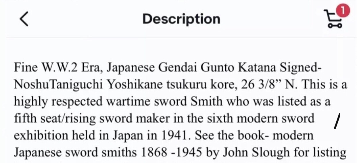

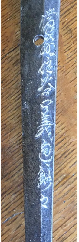

Swords Posted December 4, 2022 Report Posted December 4, 2022 I know this Swords been posting before but I raise these question because I get different answers Our all sword traditional Swords use tamahagane or dose It have to be star stamped? I hear that a sword should be judged by its own merit! having been 5th seat dose it make it a higher grade because of the after polish hamon or dose make any difference I know I need to read more books Just bought a book of The Craft of the Japanese Sword will buy more When I figure out which ones 1
vajo Posted December 4, 2022 Report Posted December 4, 2022 For me a showa-to. Oil hardnend and etched. 1
Swords Posted December 4, 2022 Author Report Posted December 4, 2022 No It’s Gendaito! Also oil quench wouldn’t look like this hamon !! I think you should some read books The one I listed has good information 1 1 3
David Flynn Posted December 4, 2022 Report Posted December 4, 2022 Steve, your comment to Vajo, is like the pot calling the kettle black. I also vote for Showato. 1 1 1
John C Posted December 4, 2022 Report Posted December 4, 2022 Steve: Tamahagane steel was issued sparingly to RJT smiths only. But the military wanted to differentiate traditionally made swords using tamahagane steel so they developed the star stamp. Some blades, however, are not fully traditionally made. For example, they may be hand forged yet oil quenched (which is safer for the blade). Early RJT blades may be traditionally made, yet not have the star stamp because the stamp program was implemented later. This is why studying the blade characteristics is far more important than the stamps. By the way, Vajo is a very respected member of this community and that respect is well deserved. John C. 1 1

PNSSHOGUN Posted December 4, 2022 Report Posted December 4, 2022 The Hamon does have the telltale signs of oil hardening but there is distinct Hada and other activity visible. It is more likely to be a partially forged sword but perhaps quenched in oil rather than water. Definitely a tricky one to pin down. 1 3

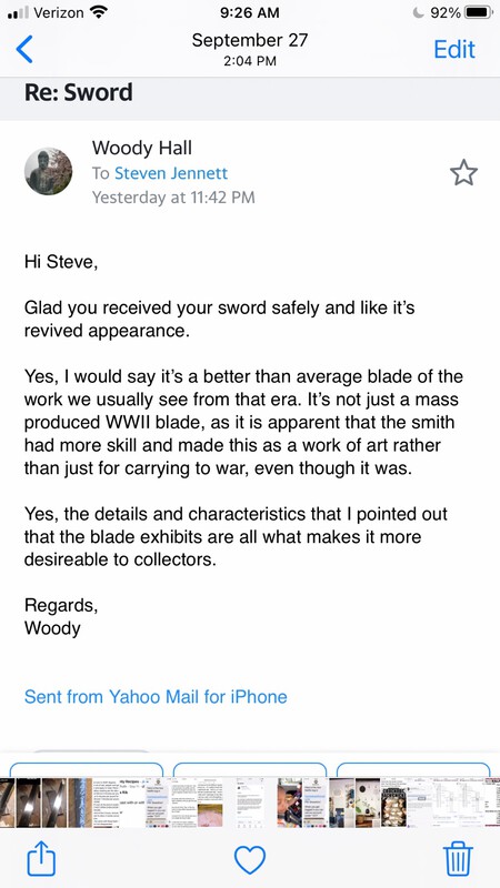

Swords Posted December 4, 2022 Author Report Posted December 4, 2022 My apologies to vajo I was thinking Arsenal when you said Oil quench if that’s the case is it folded the same as water using oil instead? And what is partially forged To answer the question why I had it polished Was because Woody thought it was good enough and the price was right! I had posted this Sword before and got positives from others 2
John C Posted December 4, 2022 Report Posted December 4, 2022 2 minutes ago, Swords said: And what is partially forged Steve: Some blades were both machine made and finished by hand (hence only partially forged). With the pressure to produce enough swords for the war effort, oil quenching is safer and results in fewer cracked blades. I suspect it is also a faster way to produce swords, however I would not know for sure. John C. 1

Bruce Pennington Posted December 5, 2022 Report Posted December 5, 2022 Back to the blade.... Guys are saying this, but let me try to paraphrase it all - A WWII smith could have made a blade using any steel, and there were several kinds other than tamahagane. Using this 'other' steel, he could have hammered and folded 13 times. Then, using clay, he made a fabulous hamon pattern. Like Jean pointed out on another thread, he finishes the blade with an oil quench to safely harden the edge. It would come out looking like the blade in this post. Quite beautiful, but made of steel other than tamahagane and it was oil quenched. The tell-tale sign, and I agree with Chris, is if you zoom in on the hamon, you see dark areas just inside the peaks of the hamon. This is one of the key signs to look for when trying to differentiate between gendaito and showato. To me, it is silly to look down upon showato. There are many fabulous blades made with great care, and quite beautiful, that were oil quenched. But in Nihonto-World, this will always be the case. Fortunately for me, I live outside Nihonto-World. Not a snub on Nihonto guys, just an observation and opinion. No offense intended to anyone! 2
David Flynn Posted December 5, 2022 Report Posted December 5, 2022 Steve, it appears you are suffering from ignorance, topped with arrogance. Why not ask Woody if it's a Showato? 3 1
Swords Posted December 5, 2022 Author Report Posted December 5, 2022 Thanks for the Tip would been been easier then all the name calling ! Why hell I might as well join in! Flynn you’ve been riding me !! I may not be as experienced or have a gold tier but that doesn’t mean I act like a jerk but if the shoe fits! As for the others who spent time giving me good advice I do appreciate it more than you know As far as the other name callers you can go f your self along with your Netherland boy friend I thought the forum was supposed to be for discussion not bashing people I’ll probably get kicked out of the forum now but I don’t need insults from anyone who thinks there above any one else My day fought the Nazis my father in law the Japanese I’m a Vietnam Veteran and proud to be an American so I don’t need any sh— from the likes of you mate Gday 1 1

Brian Posted December 5, 2022 Report Posted December 5, 2022 A lot of the questions being asked are answered in the FAQ that is prominent at the top of the forum. Including the various types of wartime manufacture. This one clearly has a nice hada and an interesting hamon. There is no doubt it is forged and folded. I agree that there are some signs of oil hardening, which would make it a hybrid, using either tamahagane or a mixture of steels. I don't think this one is fully Gendaito, but also not an average arsenal or Showato. The polish looks good on it, it's not a financially sensible choice to spend that money on it, but certainly rewarding in terms of appearance afterwards. As for the attitudes and rudeness all round, I'll be addressing this shortly as it is getting out of hand. 1
