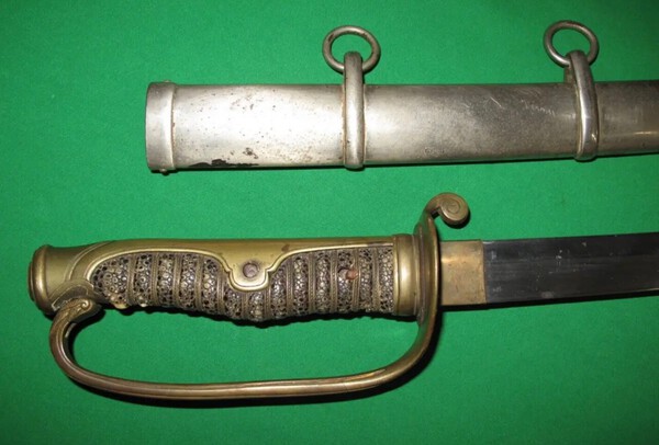

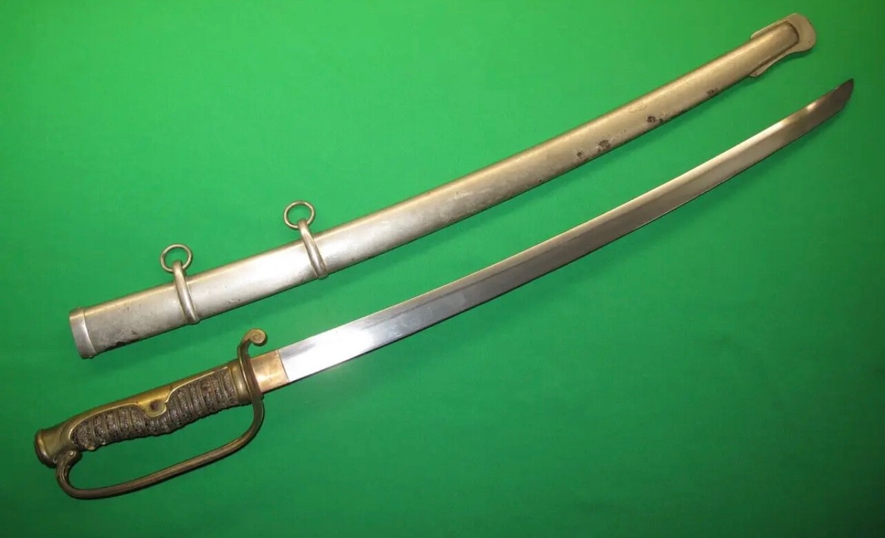

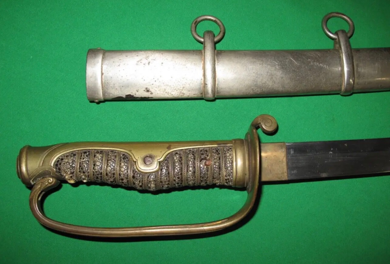

This army kyu-gunto seems to be legit. It is a typical early type with no decoration on the backstrap. The original decoration on each side of the handle (red circle on picture) seems to be missing . It should have been some sakura. Like John said the blade was sandpapered. Otherwise, seems to be OK. This sword dates back the russo-japanese war (1904-1905).

I agree, Gilles.  It's a fascinating idea, Noah, that the sakura might have been intentionally removed before surrendering it, like the defaced mums on rifles.

I agree with Gilles that this is authentic. The parade sabres have a slightly curved handle whereas the nihonto bladed versions have a straight handle to accomodate the nakago. The same' on the handle appears to have been originally black and has worn nicely. The wire wrap is in tact as well. Notice the center belly node of the same' towards the rear of the handle.

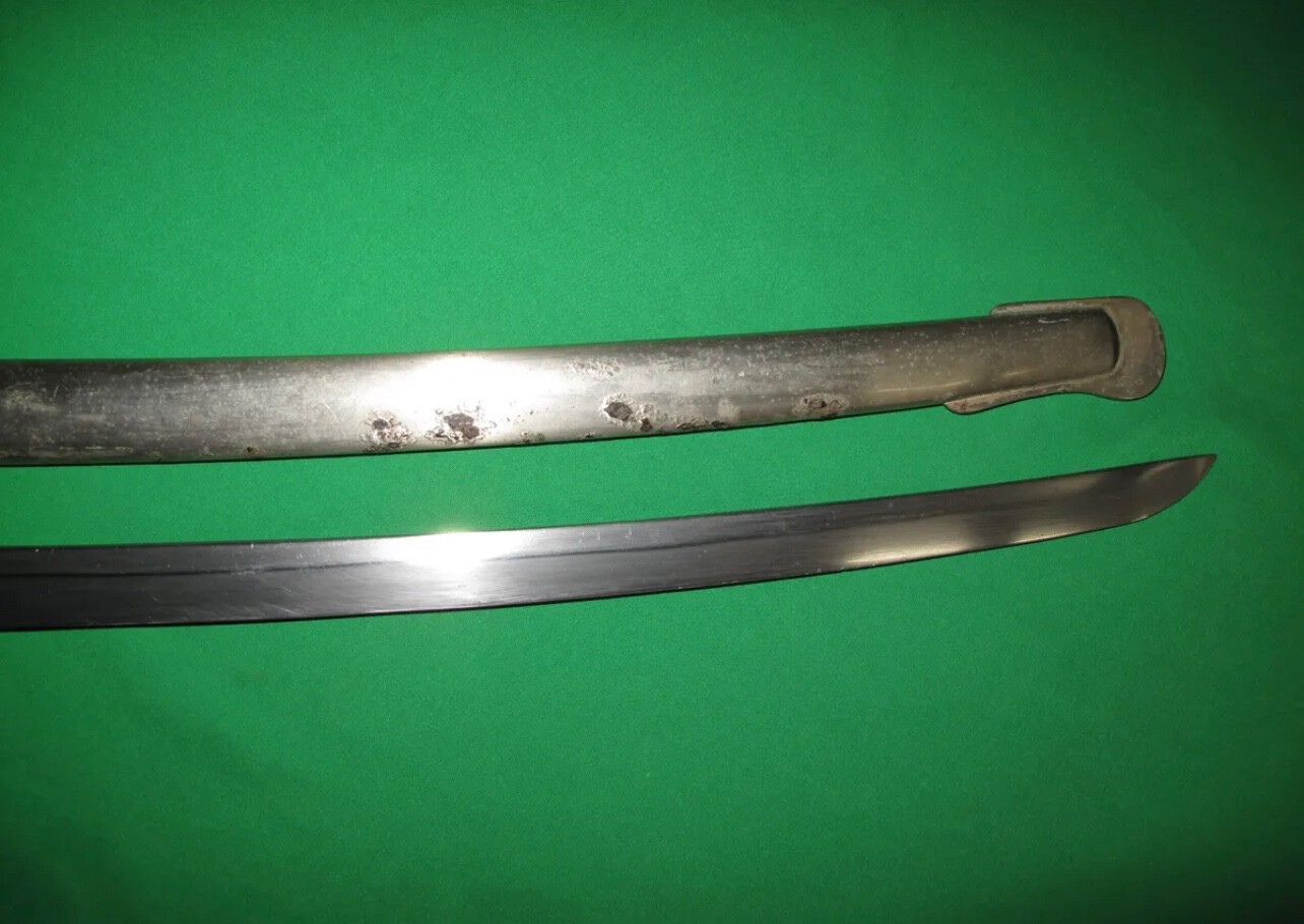

Tough to tell from the pics, but the shinogi appears to be high and the blade width looks to taper towards the kiaaski (fumbari). Leads me to believe this could be a koto period blade. Again, provided photos leave a bit to be desired. I would be interested to see the nakago to see what the blade really is.
Worth $500? I would say yes. This type of mounting (Especially early like this one) is getting harder to find. Perform your due diligence and examine the blade closely for hagire, fukure, and if you can see the hamon at all, look for tiredness. (Hamon dropping off the edge of the blade).
On a side note, never could identify the backstrap decorations per F&G, Dawson, or any other ref material. Guessing it's an early version of the field officer grade decoration.

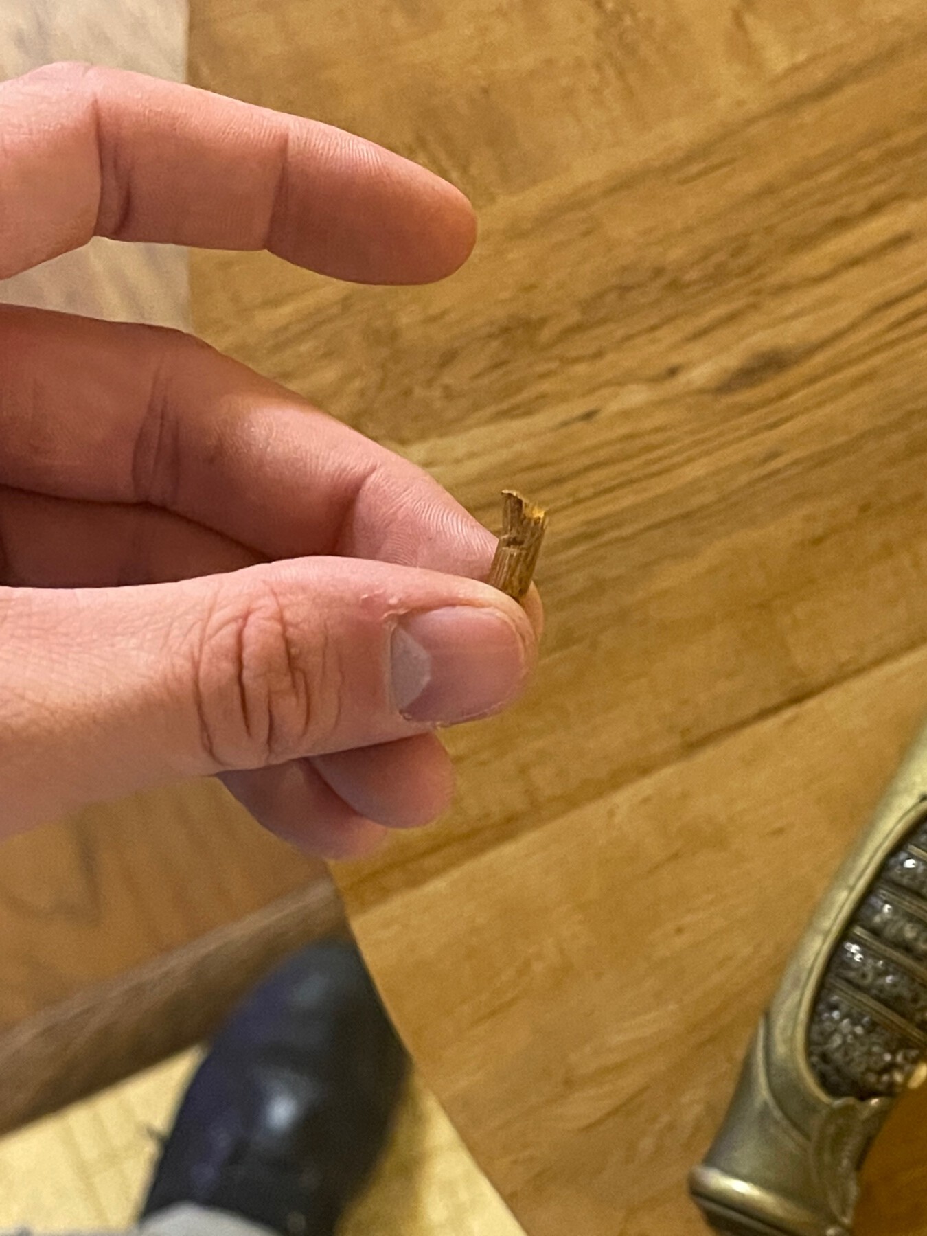

note the “tail” on the end of the nakago and the cross looking spot on the nakago. There is a spot for the retaining spring in the scabbard, on fittings but no spot for it on the handle nor the hilt (there is no retaining spring at all). I’m not sure what the handle is made of, either plastic or bone but maybe plastic. The hole mentioned by another user that stated it had a screw in mekugi has been filled in on the handle. The mekugi it came with is severely bent, I’ll post pic on thread.
