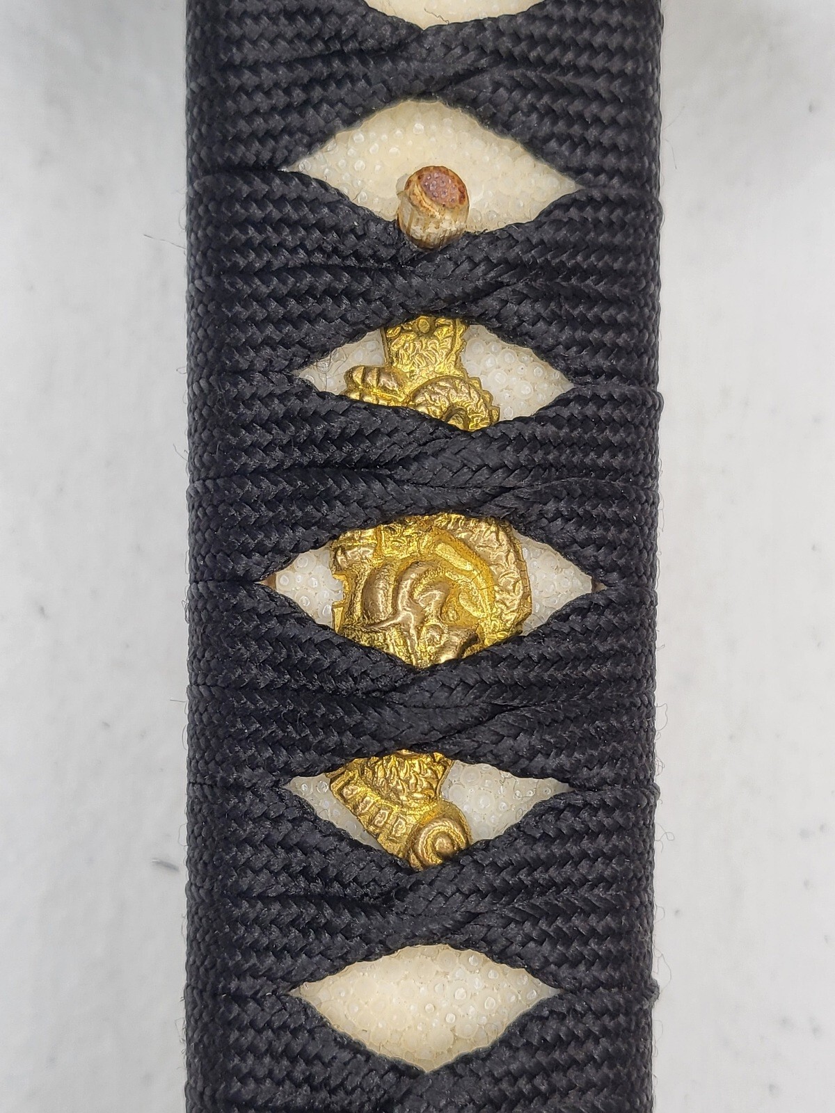

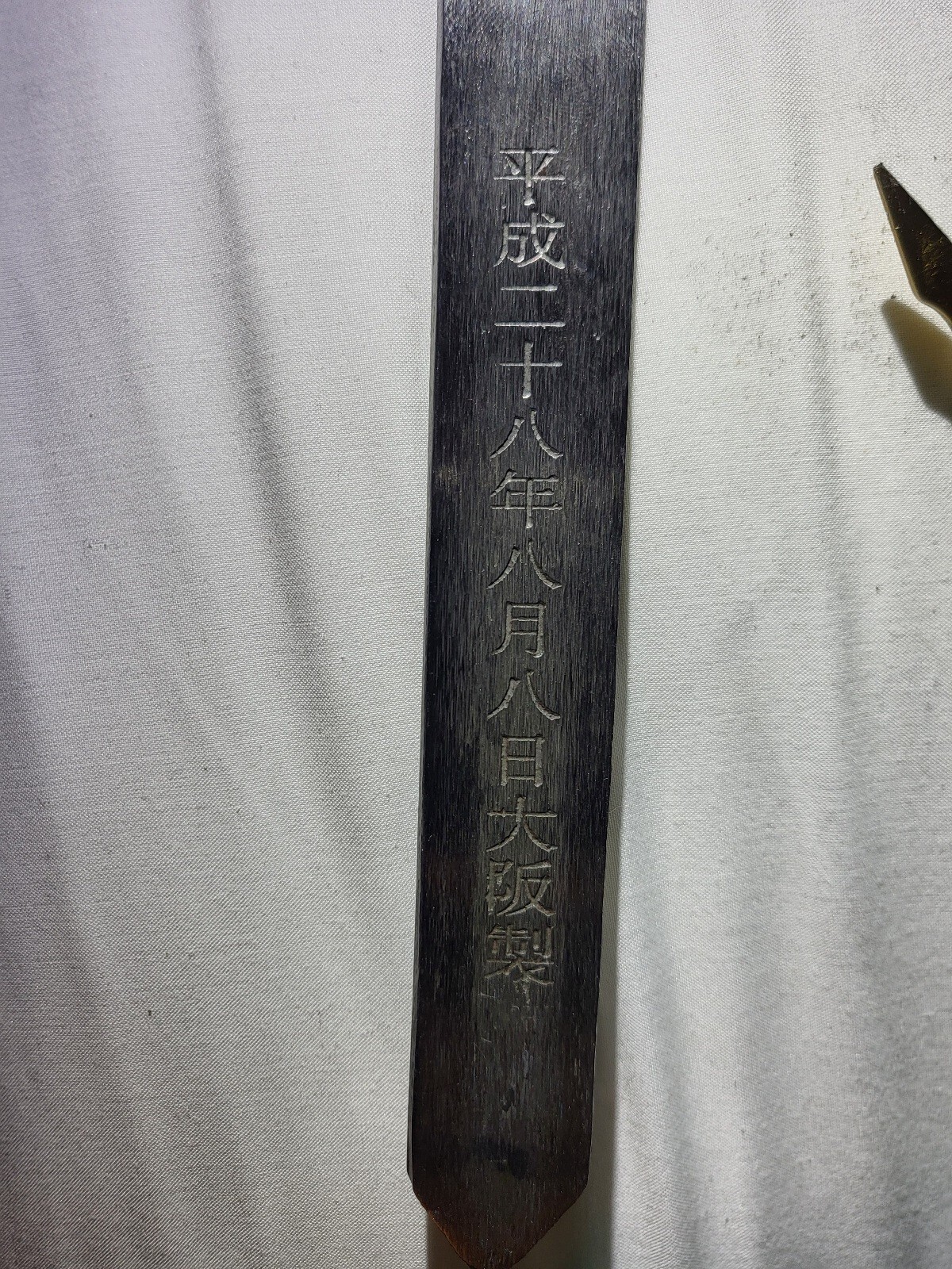

Brian Posted December 3, 2022 Report Posted December 3, 2022 It's ludicrous that he even claims to present this as made in Japan. Like so far out of the realm of possibility as to be impossible. That "horimono" isn't even remotely Japanese and is either etched or actually CNC machined...likely etched. The finish on the nakago, the nakago jiri and the yasurime are impossible to be Japanese. The mei is etched on, or machined. It isn't cut or carved..not a chance. None of the fittings are Japanese. The sword isn't even debatable. It is 110% fake, Chinese production. The only way these could be Japanese is if they were alloy training/display swords and non-magnetic. Otherwise they would be illegal in Japan. Challenge the guy....you are going to ship one to Japan. If it is rejected and refused import, he goes away. Otherwise you are going public. Let him try and sue you for defamation. He'll lose, and the court decision will be used against him to block him from shows. Guys like him piss me off. 1 1 Quote
