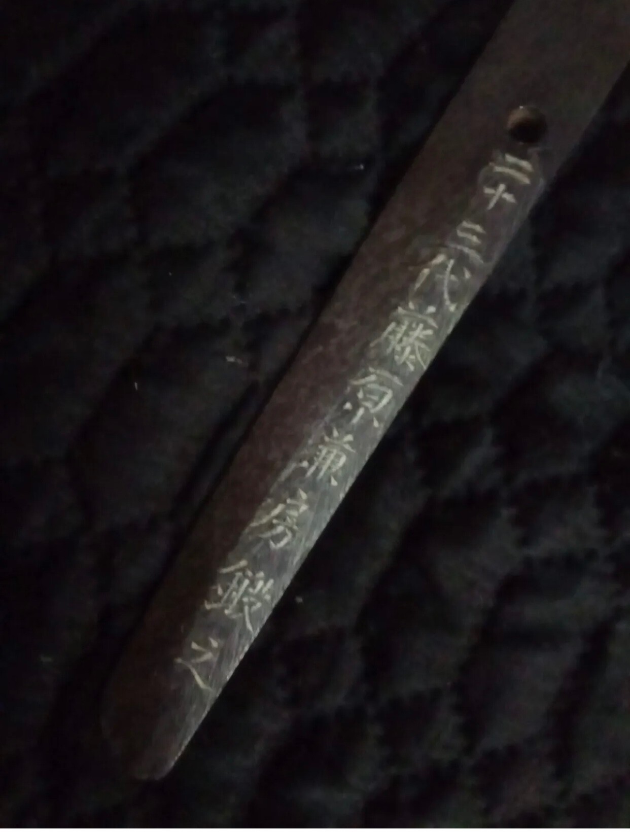

Hi you all I wouldn’t hav posted this but wanted to get hep with the signature and sword I compared this to John slough and for me dosnt match but maybe i am missing something I hav been looking for a navy
any help would be appreciated
steve

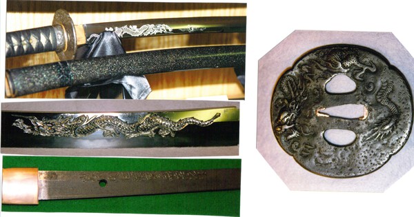

I had a blade by this smith many years ago and it had all dragon fittings and very nice horimono of a dragon - sort of sad I sold it now. It did in fact have a showa stamp on it that "someone" had filled in with dark colored wax so I did not see it until I was wiping down the blade with alcohol and it melted. Still a nice sword
1 hour ago, David Flynn said:
Brian,  it looks like it had a stamp removed.

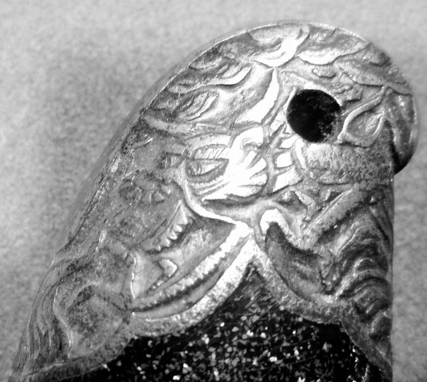

If that comment was for the post I did the stamp was not removed at all as I said - just filled in till i cleaned it out :)  It was a regular forged blade and as far as I could ascertain - water quenched and then at some point well after it was made was given the stamp. Then all the dragon fittings were added to the Koshira and the rest of the mounts - don't know who made them but all iron,
His swords are usually high end Showato, but not fully traditionally made. At least most I have come across are. And most have an arsenal stamp.
But decent swords. I can't see any reason to fake the signature, and would expect it to be shoshin.

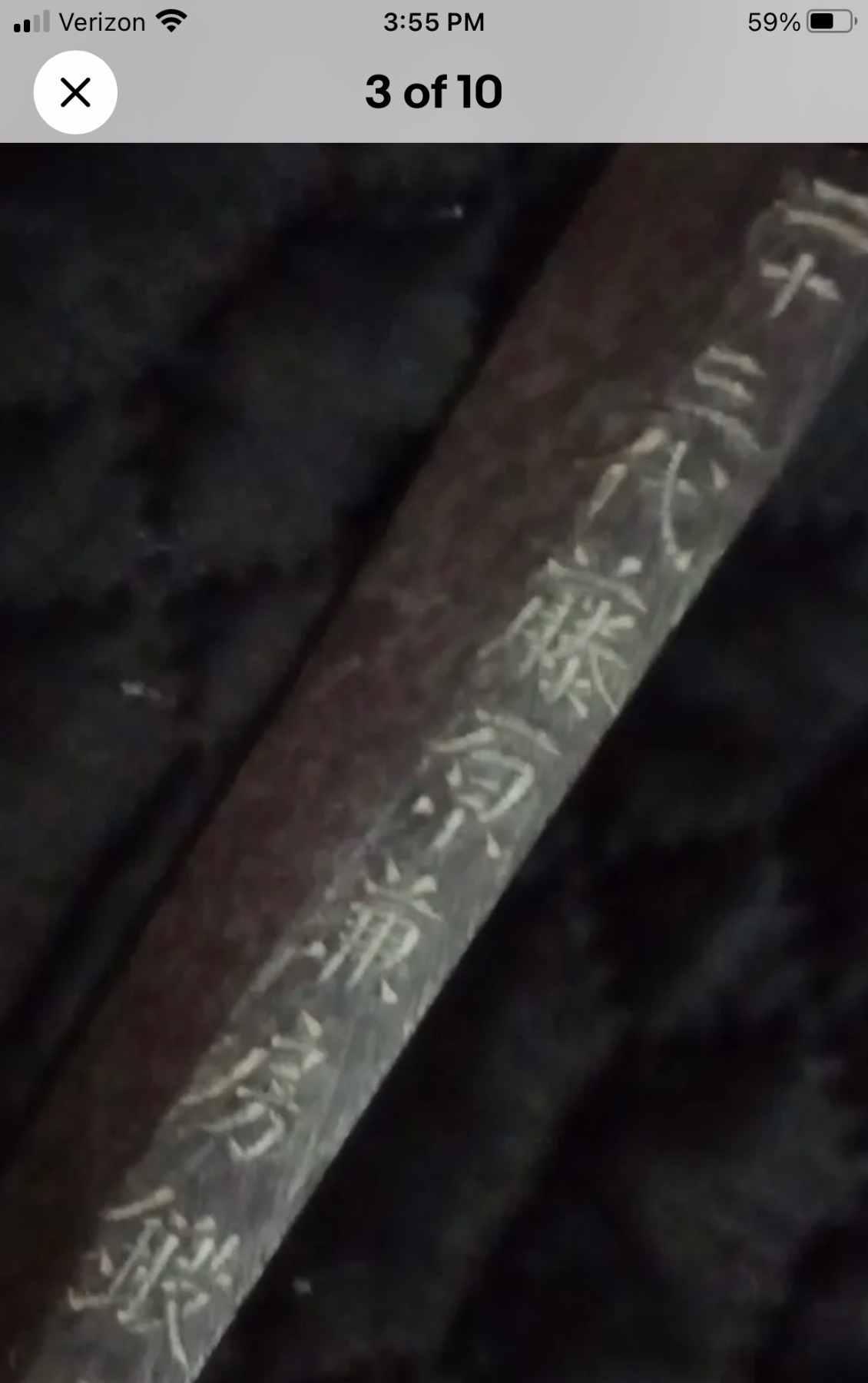

Thanks for your freed back I was concerned of the signature I tried matching to a picture from John slough book
It didn’t look like it but I’m not as expert so I may be wrong (see pictures ) as comparison
steve
Steve,
Looking at the two examples in Slough's book, there are variations between the two shown. The blade pictured shows even a third variation. Gimei? Maybe, maybe not. As has been said on here many times, buy the blade, not the signature. If the blade, and koshirae, speak to you, then buy it. In just my humble opinion, there is not a great benefit to take a mumei Showato or low to mid-grade gendaito and fake a WWII smith's name.
All the best.
Hi I thought so too the book and signature don’t match As far as the blade the hamon looks weak nothing spectacular and then I hav to ask my self do I also want to take a chance it’s a gimei Probably best to pass
But thanks for pointing that out

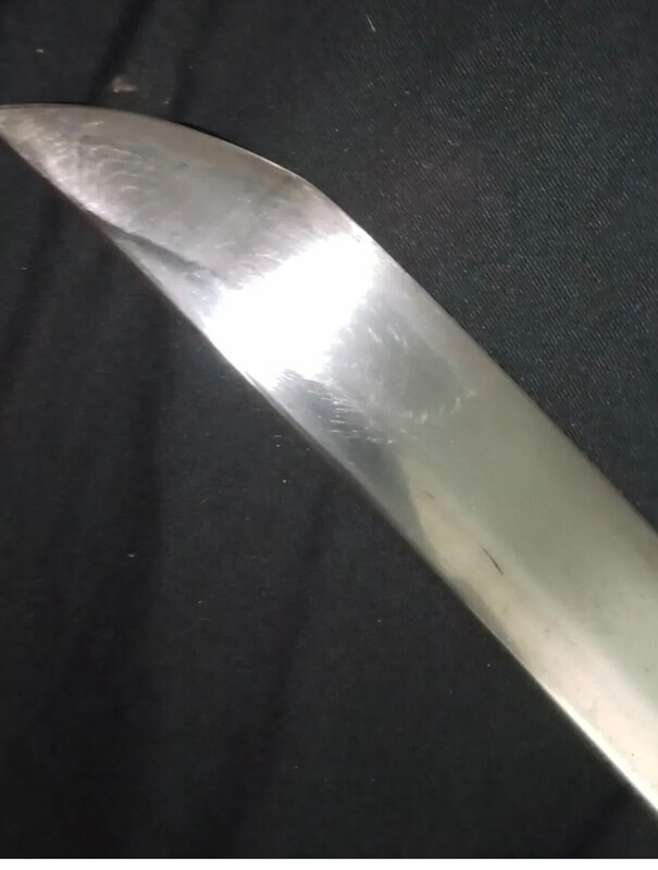

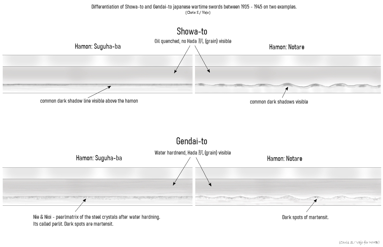

Hard to say but i would go for a showa-to.
Your picture shows the temper line but no activity.
Try to make pictures from a lower angle to see it more clearly.
To me it looks more like Gendaito I don’t see the dark area’s along the hamon It also looks like almost wood grain represents tamahagane ? but I’m no expert
I’ll try another picture if I can get one
Anyone else chime in on this?
