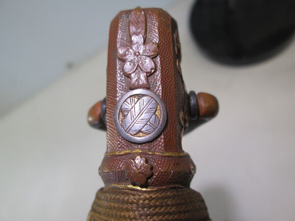

Well, it's absolutely gorgeous.  A little too pristine, maybe?  Like the tsuka looks brand new.  But then the tsuba and seppa do too.  I've seen some of these on Aoi Japan.  I don't know if they are refurbishing the fittings or if they have a supplier that is making them new.  Either way, it's either a pristine closet gunto or a really good restoration.
Are you asking about the mei?
My first thought was - this is a replica. Because it looks like brandnew and the leafs of the fuchi looks not right. But i think this sword is very unlucky photographed. With flash not focused or the blue light is false. So the color is total false.
I think its a real Yasukuni to in top mountings.
But i was unsure what i see.

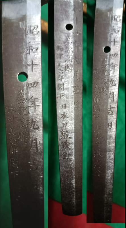

昭和十四年九月吉日 1939.September
為紀念贈  Gift for commemoration
梅津美治郎閣下  Sire Yoshijirō Umezu
日本刀鍛練會 Nihon To Tanren Kai
Yoshijirō Umezu (梅津 美治郎, Umezu Yoshijirō) (January 4, 1882 – January 8, 1949) was a Japanese general in World War II and Chief of the Army General Staff during the final years of the conflict. He was convicted of war crimes and sentenced to life imprisonment.

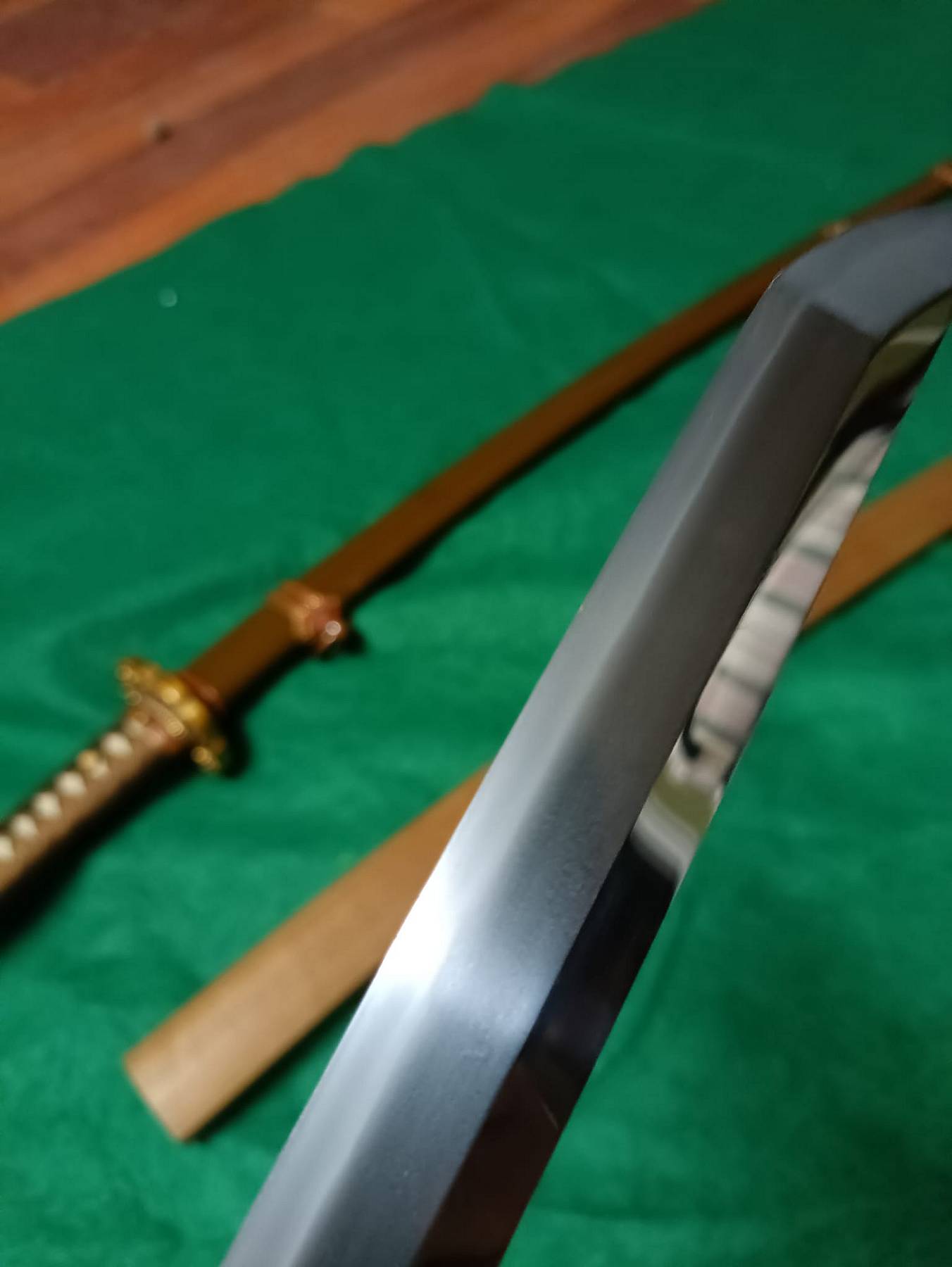

2 hours ago, robinalexander said:
Can't make out the sarute barrel but from the last picture I can see where a second ashi has been fitted in the past. So with the centred chuso and pierced tsuba = Type 94 koshirae?
Yes, good catch!  First time I've actually seen marks from the second ashi.

But these are the three pictures he posted from the nakago.
Ronnie when i compare the kanji they are 100% the same what you think
left is yours - right the other sword.
Hi Chris,
Yes. They are exactly the same. Hard to tell whether it is an imitation sword or not. Again, I have the same doubt on the fittings.

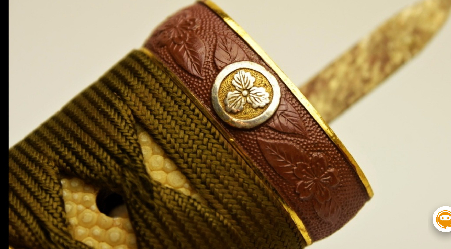

The Mon plate (maruni daki myouga) looks worn and doesn't fit with the brand new fittings
Ronnie
Dear Ronnie.
I do not think the silver mon is worn, I think the ground was gilt and the polished silver surface has tarnished a little, that's all.
All the best.
On 12/3/2022 at 3:52 AM, PNSSHOGUN said:
Some more with gilt remaining, it is difficult to find completely intact
Here is one I found, more or less completely intact. Also, mine features a copper habaki with a matching mon that was similarly gilded.

8 hours ago, Bruce Pennington said:
Matt, is that an extra inscription alongside the date?
Yes, it is the mei. The nengo (right column) and the mei (left column) are on the same side of the nakago. On the other side is a lengthy inscription. I will share it in the near future, maybe a separate thread.
