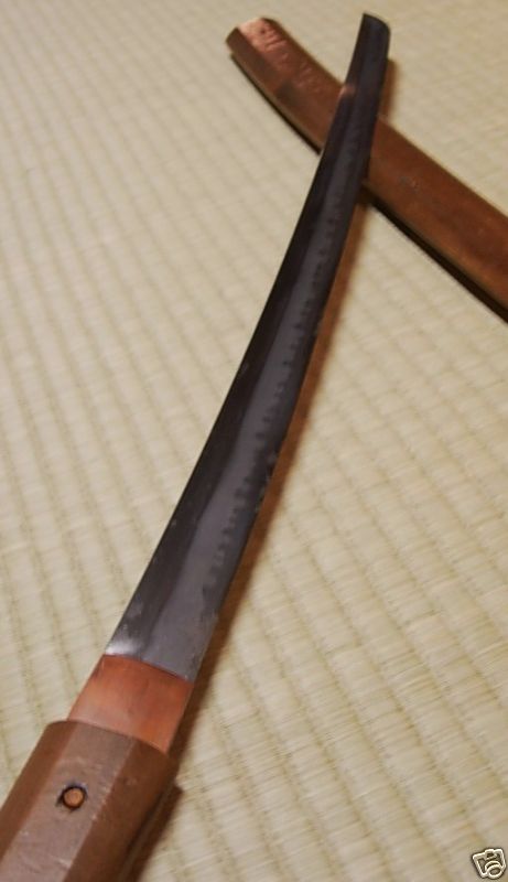

Taygrd Posted June 14, 2009 Author Report Posted June 14, 2009 Gentlemen, thank you so much. I hav e very little info on this sword so I do appreciate you taking the timew to educate me. I did some research in my few books and found the three Sadayuki smiths and I am guessing the 1600s. I have little else too go on. Steve, I have included some picturs of the Fuchi/kashira. The little I know of swords I know even less about the fittings. Any input would be appreciated. Mark I have included the picture I have of the blade as well. Again I apologize for the poor quality of pictures, I am going to purchase a tripod to help. Again my thanks. Quote
